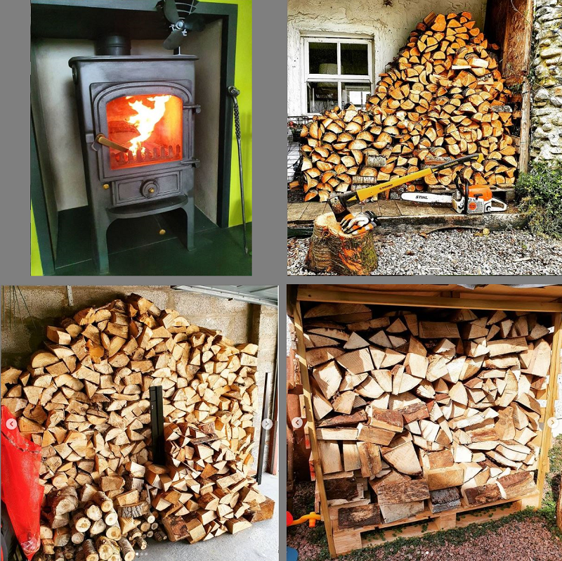

I have a Clearview 400P which is max 5kW - https://www.clearviewstoves.com/stove-details/pioneer-400p
Currently burning pine, black poplar and cherry. Pine is great for getting the fire going and cherry is an exceptional hardwood, very long burn time and masses of heat.
A bit too much wood to store at the minute. I fell, cut, split and stack all my own wood and have another job lined up for a few more cherry to come down soon after doing 4x medium silver birch last week, which I've just finished splitting.
Top right is 5x cherry all done. All mega leaners pretty damn dangerous things. Approx 4m cubed.
Bottom left is my garage racking mostly polar with some pine. Approx 2.5m cubed.
Bottom right is a little store I made which is rammed with pine. Approx 2m cubed.
Chainsaw wise I'm running Husqvarna 550xp & 435mk2 as well as a Stihl MS391.
Hoping there is some more link minded people on here to have some discussions in here.

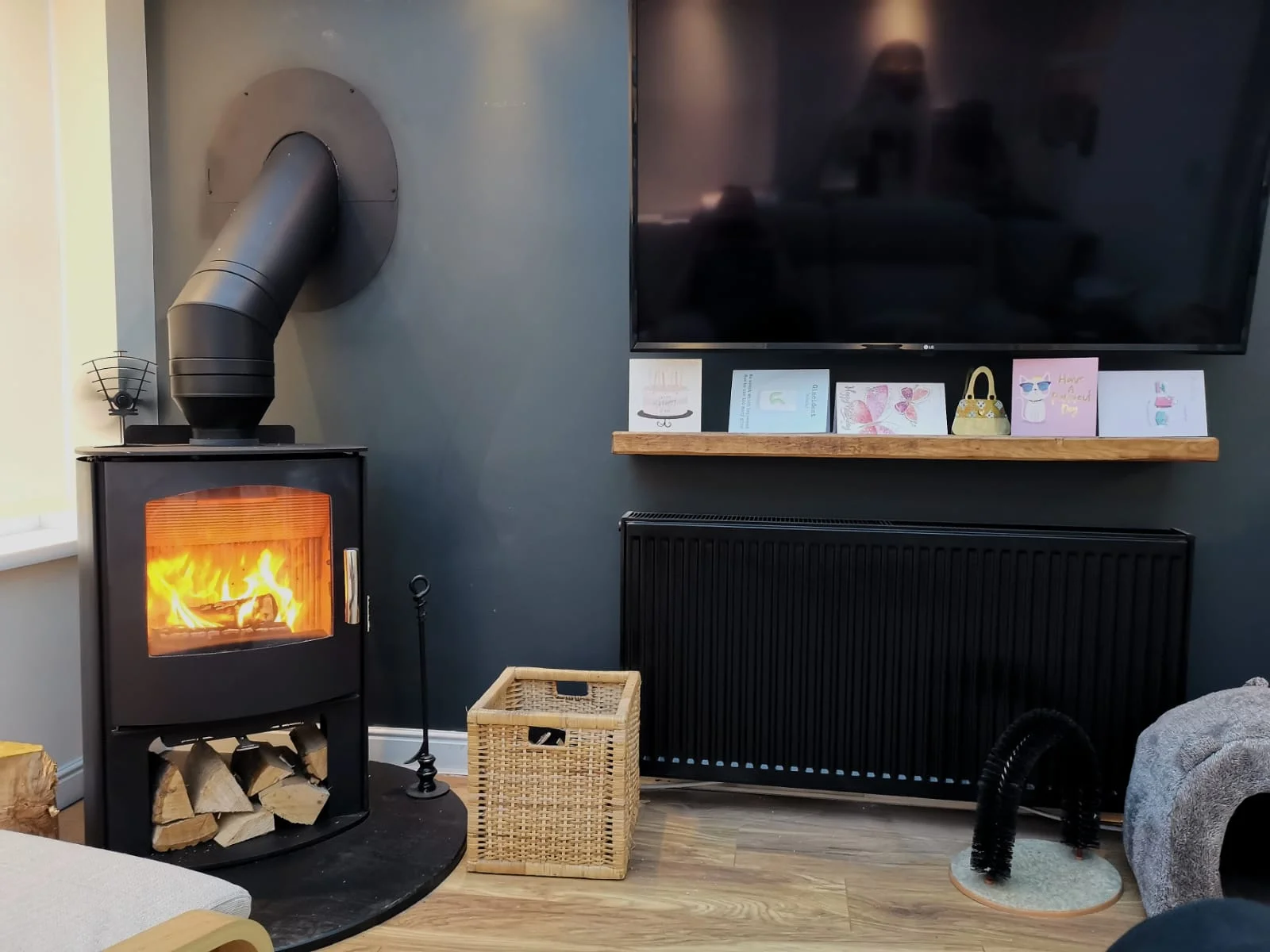

So, to address the original points:
Stoves.
Mendip Churchill 5 installed recently in my conservatory
Firewood & wood storage.

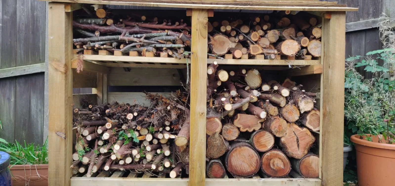

2 logstores which take about 1.5 m3. 1st was bought, the 2nd cobbled together. Both double depth and covered in clear heavy PVC but with good airflow.
https://imgur.com/a/KYUYeQ6
https://imgur.com/QfHHyIX

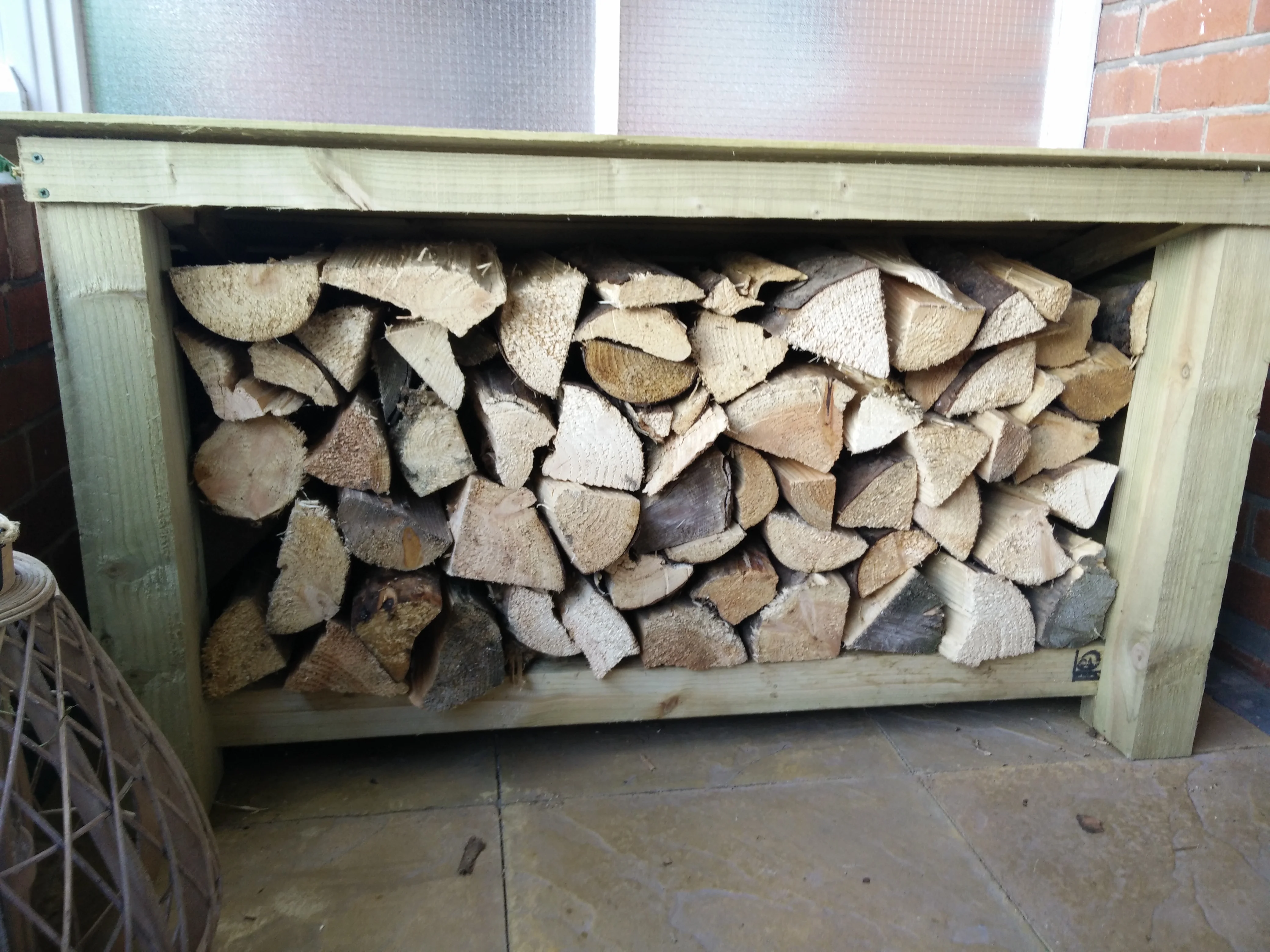

We've got a Chilli Penguin stove, a 4.7KW. It's in our open plan living/kitchen/diner and it really heats the whole house up.
I don't cut my own wood but i've built a couple of log stores so we can season our own depending on where we buy it from.
The last couple of times i've used a local guy who gives me a Hilux pickup load of mixed hardwood/softwood for £100 delivered, it's all seasoned so usually around 15-20% but i always try and stay ahead of the game and keep a fair bit in stock so it can season as much as possible.
Around here kiln dried stuff seems mega expensive, like £120 a builders bag which i just can't see the value in unless you've got no where to store normal logs. Plenty of people in these parts doing builders bags for around the 50-60 mark but it is pot luck how well its seasoned.
This year we're using loads more than normal due to the wife being at home all the time and me working at home half the week so I'm waiting on another delivery next week which should see us through the winter I'm hoping.
I do have a splitting axe but it's just an el cheapo one from B&Q in a rather terrible shade of lime green but it seems to split the few logs i get which are too big for our tiny stove.
I need to get a big 3rd log store built really, maybe next year. My stacking skills aren't mega on point i'm afraid but here's what i had last year :(

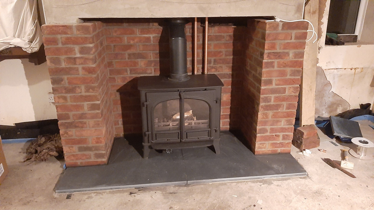

Here's ours, completed just in time for the colder weather.
We had an open fire last year in an odd sized chimney so I've taken that down and rebuilt a new opening and hearth etc, the stove is connected to a 500L thermal store that gives us hot water and heating.
The stove is a Stovax Stockton 11hb boiler stove, output is 11kw to the boiler and 7kw to the room, although I'm sure it won't do both of those at the same time.
I've just finished 2 log stores for this year, both built on pallets with old timber out the house for the sides and top, dpm on the roof and down the front with double layer netting on the sides.
We buy our firewood locally, £65 per bulk bag of seasoned hardwood delivered.
Just had 2 bags delivered and that filled the left store, the right store is nearly full of a few trees we cut down last year and some that were cut a few months ago, plus the cut up soft wood out the house.
We have bought cheaper bulk bags but it was so wet when it was delivered we couldn't burn it for a month or so and it was still too wet then really.
