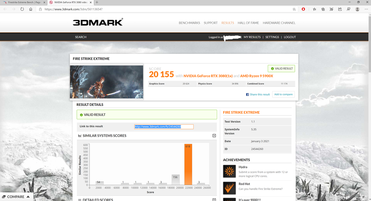

Firestrike Extreme Bench.
Lol, don't be daft! Put that AIB 6900 XT to use and beat it. :)
Then i have an excuse to try again. ;)

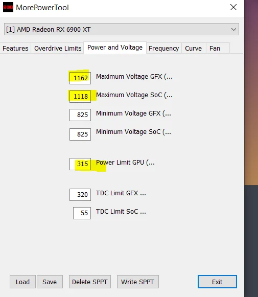

Yeah, it needs tuning for sure. Check out MorePowerTool (MPT) and see what your default TDC and and Power Limits are.
The MBA 6900 XT has a Power Limit GPU of 255W and a TDC of 320A.
You may need MPT to extend your power limits to increase the score.

I did try the mpt, but anything I changed, although worked in changing wattmatts settings, whenever I used them it would go into protect mode and put the clocks to 500mhz
You only want to change the two things I mentioned or reduce voltage. Y can also reduce SOC voltage if you want to. Don’t do anything else and it will work.
Do I need to restart after? And how does that work with the 15%slider? Do I just put it to full and it will apply to the new power limit?
It doesn't use the 3rd pin, that's the problem here. It has the exact same power as the nitro, the merc the reference
You can raise the Power Limit with MPT, for example like in this picture:
This is a 3x8 card. You can start at 300 Power Limit GPU.
Then Write SPPT and restart PC.

Just to be clear, i was referring to the Power Limit value shown in the overdrive tab of MPT, leave that alone and adjust the values mentioned only.
