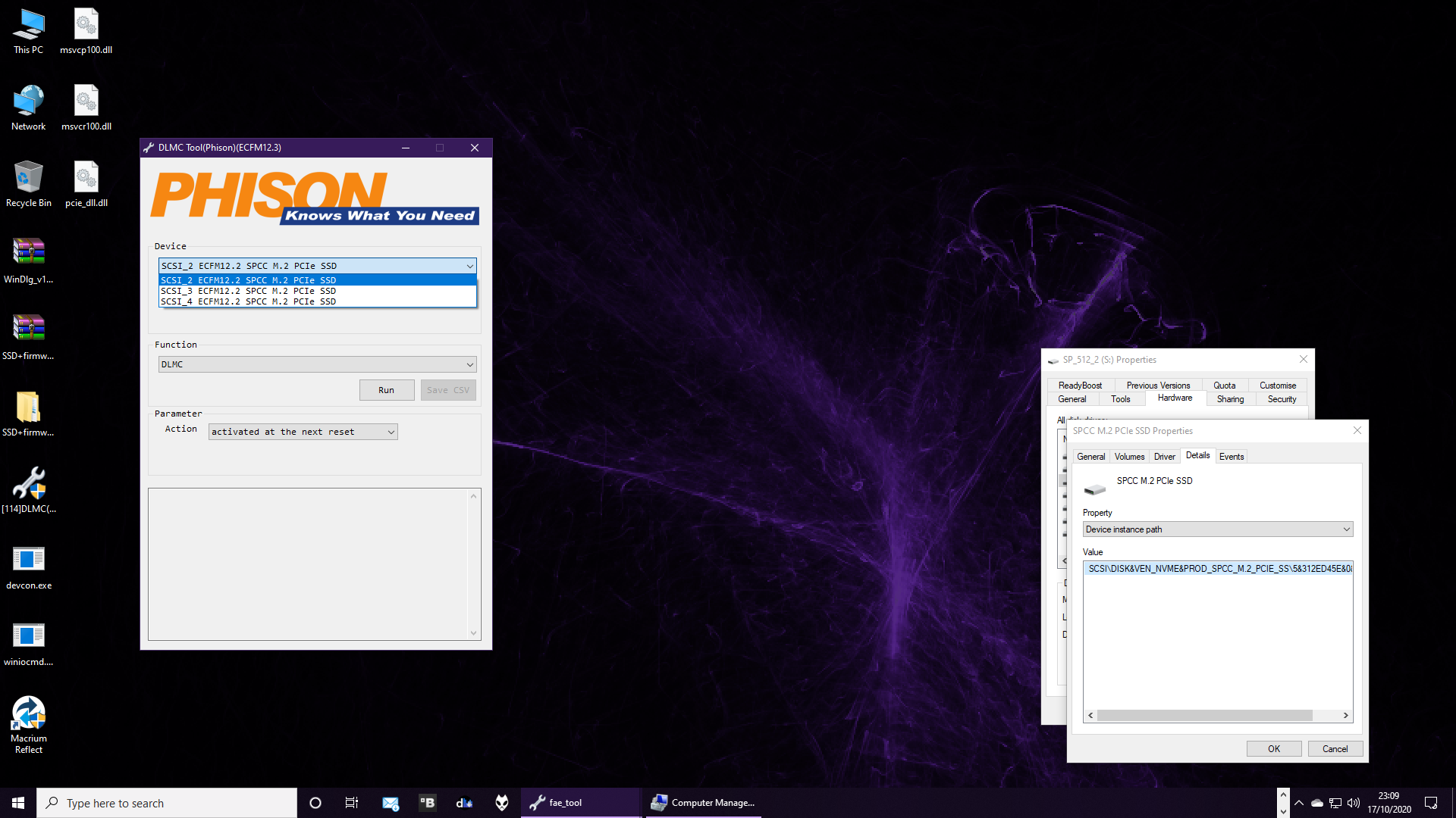

I took the plunge and decided to flash both my drives with the 'reference' utility from Phison, this updated the drives from 12.2 to 12.3.
From my own experience I had no issues at all with doing this and both drives still retain their unique ID or name.
Please note: the firmware update is *destructive*, so backup your data and also you know the drill, its all at your own risk, etc....so don't blame me if it you brick your drive. If your drive is not a ref. design then I would advise against doing this!
1) Download the 'firmware12.3.zip file and extract the entire contents:
If you can't locate this on the web then I can provide a link.
2) Double click the '(114)DLMC(Normal)ECFM12.3.exe'
3) From the Phison flash utility your applicable drive(s) should be detected, as below:
4) Don't amend the Function option, simply click the 'Run' button and the flash will start, it literally takes a second or two.

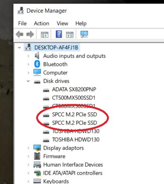

6) Check device manager and the ID's should be as they were before (here they are on my system after the flash):

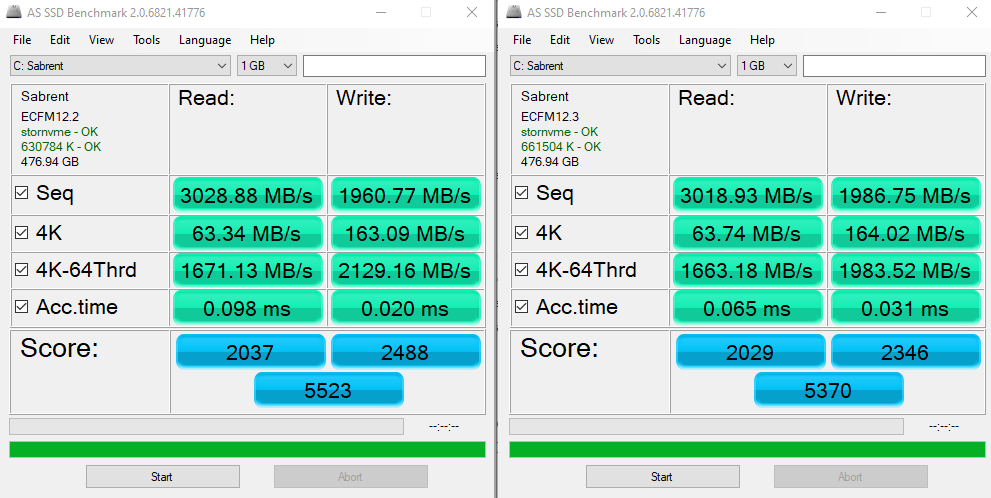

12.3 doesn't seem to be destructive if you're upgrading from 12.2. Tried it on a Sabrent Rocket 512GB (similar Phison E12 reference design) that was on 12.2 just now and everything seems to be fine. It only seems to be destructive if you're upgrading from 11.x firmwares. I would still also highly recommend backing up data before updating the firmware, just in case.
Not much of a performance difference, if at all:
One more benchmark as a comparison, some small differences here and there, overall a little improvement so not a bad firmware update. Though unnoticeable under real usage.
