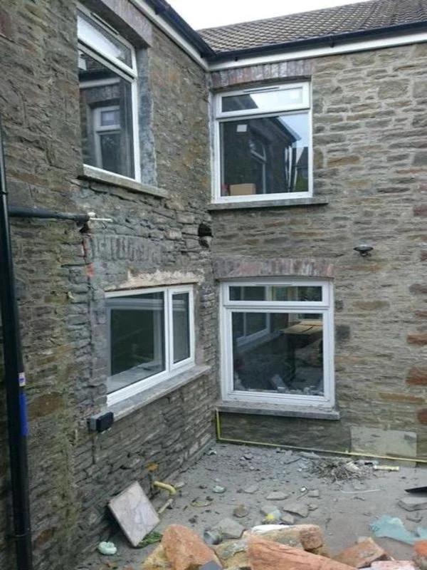

New windows fitted, double glazing throughout now :)
You sir are a machine, kudos!
Haha thanks, it keeps me busy.

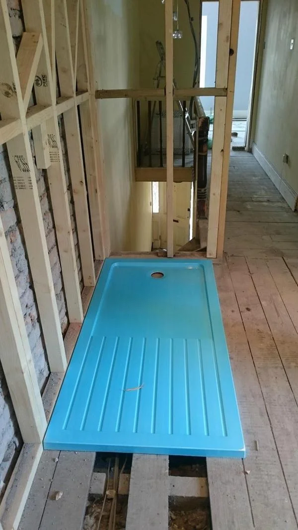

I stud framed the shower area for a few reasons,
1. The shower tray will fit perfectly for the cement board, seal, tiler etc
2. We want the shower mixer installed in the wall by the walk-in part to prevent getting caught by the dretcher as it warms up
3. I initially went with dab plasterboard which isn't ideal in a wet area or for holding up heavy tiles long term. It wasn't worth risking it with leaks
As you can see, perfect snug fit now
