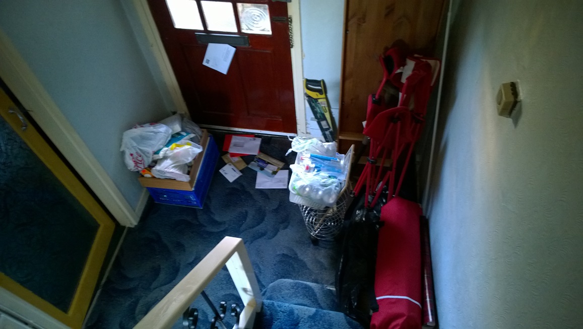

So day 1 got the keys and went in to check everything was still running as it should be. Greeted by this they were told to empty it and had 4 months, Plain lazy people:
+ The garage is full to the rafters, Since got a skip and chucked most of the junk away, but will need to get another one

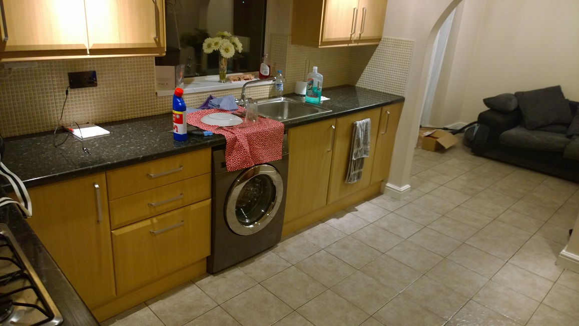

Quick picture of the Kitchen, Its totally liveable with, few cracked tiles work surface isn't sealed in so there is a few bobbly bits round the sink but wont get touched now until the rest of the house is done.
