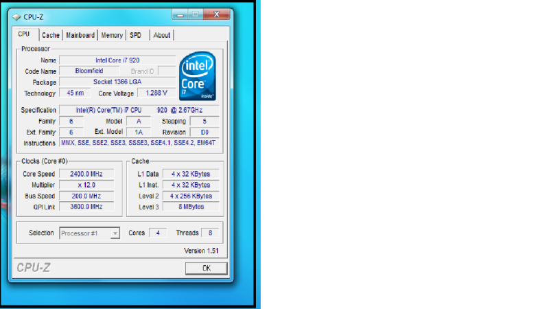

I've tried my first over clock and temps are 47 idle, have not tried load yet. left everything on auto apart from
CPU Ratio 20
BCLK 200
CPU volt 1.30V

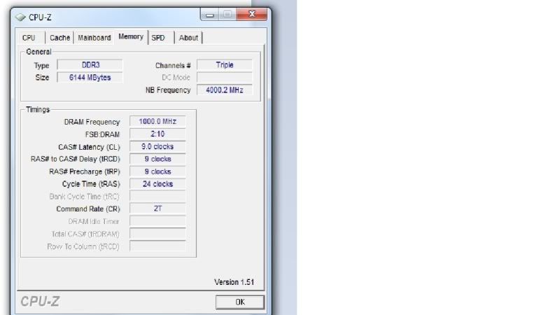

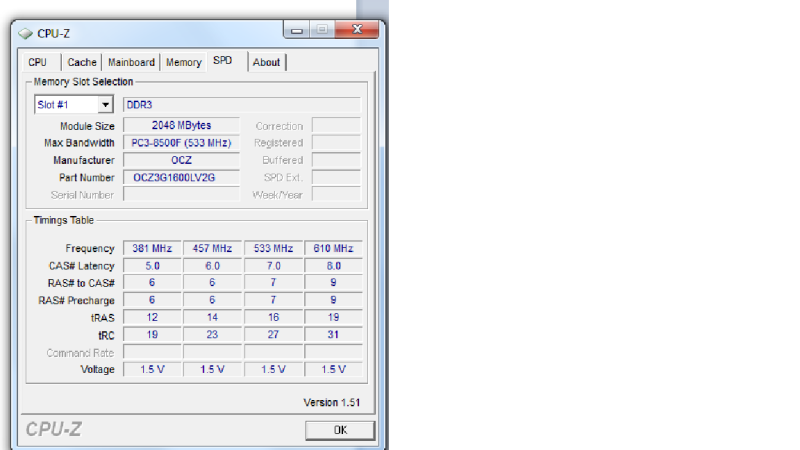

and dram 2000MHz (OCZ 1600MHz thought I would OC and see
what happens;))
Seems OK but temps look bit high

You will be very lucky if this is stable mate, I don't think it will be stable when you are running 1600MHz RAM at 2000MHz with 9-9-9-24-2T timings..
Like Admiral Huddy said, you will need to stress test your system to find out if you are stable or not.
I recommend using Prime95 Blend Test, and a minimum of 20 passes of LinX using all available memory.

Though I would suggest you lower your mem multi to 8x so that it runs at its rated speed.
Get your CPU overclock stable first before trying to o/c your RAM.
