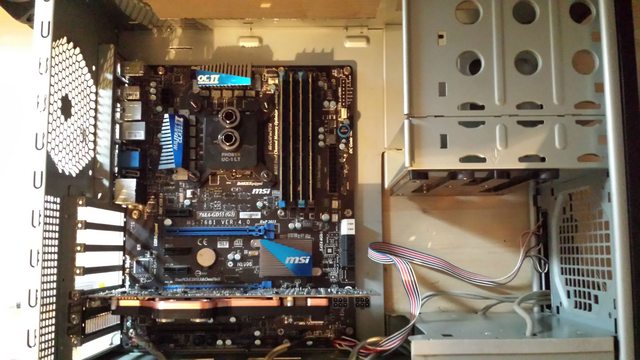

Now to put in the board and GPU (you can see the hole I cut out ontop)

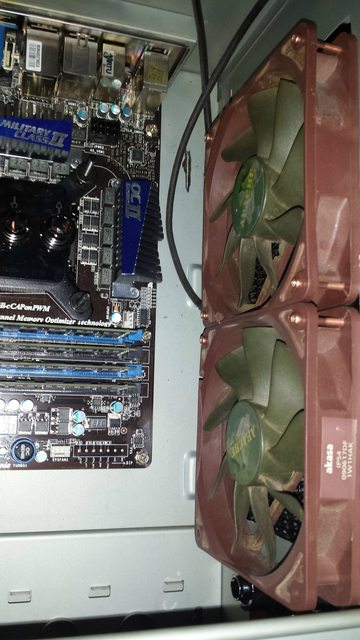

Fans installed

everything back in and ready to go, note there isn't anywhere to put cables so done my best to tidy them.
Well that's about it what do you all think of my first time:)?

Why are the fans at a angle. They really need to be tight against the rad to force the air through it.

the fans were at an angle because i put the black cover on top. but I just fixed it today. So i need to remove the block and re-do the tape?
