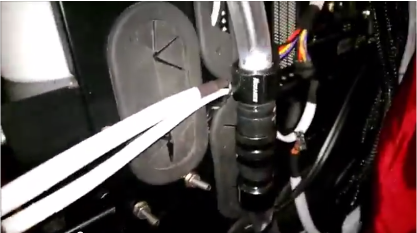

I'm not sure what's going on, but lately, when I have booted my computer, the loop will make a noise, I can't really tell when this noise is coming from despite throwing my head in the case.
There are 2 xspc d5 pumps on top of eachother, here is a video of it:
I can't imagine what's going on, there's a silver kill coil in the loop behind the back panel where the tubing goes out of sight, but it doesn't sound like the noise is coming from there... it's difficult to say where it's coming from but I would have thought it's one of the pumps.....
I noticed that the top pump is full where as the lower pump is half full, it looks like the liquid is building in the top? I think to get it back in evenly I'll need to drain the loop again?

are both pumps in the same loop?
Only just managed to view the video. Are you running a dual loop?? I can't quite understand the cooling setup that you have there
EDIT: Just looked at your build log. Why do you have 2 pump/reservoirs?? Get rid of one of them and see if you still have the same noises.

Strip out that bottom res/pump combo and connect the ends of the tubes together. You only need 1 reservoir in a system - 2 complicates things as you can see. However you can run 2 pumps in series just get rid of one of those reservoirs at least.
Try that out and see if you still get the same noise and come back to us if you are.
EDIT: I don't know if you have the D5 Varios, but do make sure the speed setting on both are the same too!
Yeah having 2 reses just complicates things when it comes to bleeding the loop as you'll find that liquid moves between the two and you can't have both open at the same time to bleed them.

after a reboot, the pump runs silent, it doesn't always happen which makes me wonder if it's an air lock. but I'll disconnect the lower pump / res tonight and see what happens

after changing the connections, I still had it, but I found out it was the temporary graphics card fan that I'm using, I gave it a clean and no more noise :p
there was a pretty big air bubble in the tube though in the pump though, seems to be fine now :)
