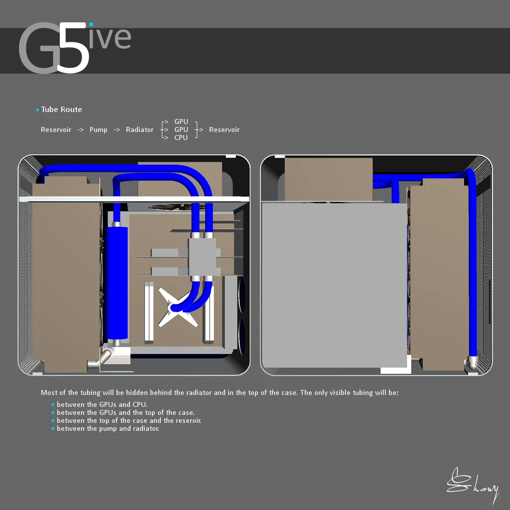

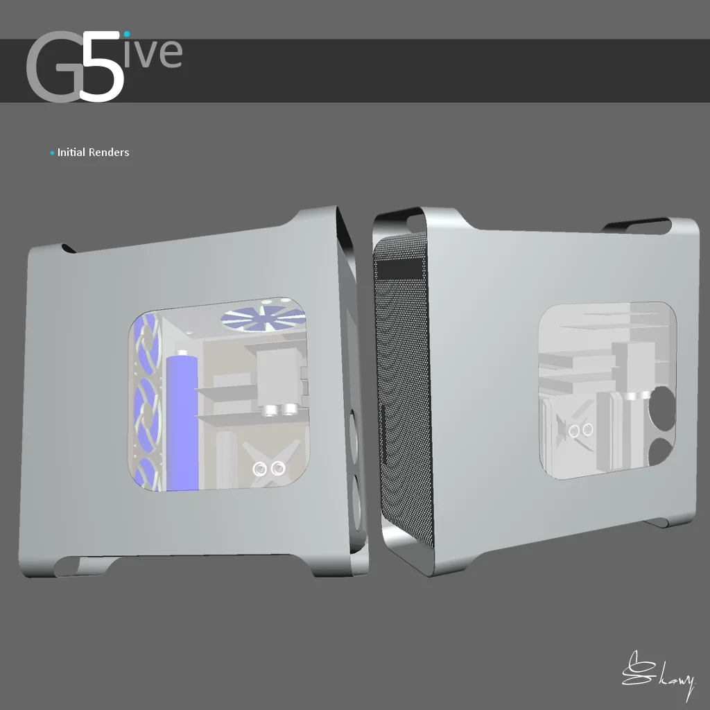

Hopefully I'll show you something a little different to the builds you've seen before. Here's a render of how things should look when complete.
Dis Gun Be gud!
Another G5 build in a space of a month, looking brill!

I love paralell loops like this, nice and clean. I have to say that seeing these great G5 mods makes me want to have ago. If I did it would be very similar to this I think. Will sit back and see how you tackle it. Are you using the existing from ports? Looking great so far.
I'll be using the power button, power LED and USB from the front panel. I haven't used firewire for about 6 years and don't plan on using it any time soon. As for audio I'll have my speakers hooked up to a sound card and my headset plugged into onboard audio so I don't need the extra port.

I'm glad you guys like it. You can probably tell by my choice in cases that aesthetics are quite high up on my list of priorities with this build. I'm more than happy to potentially sacrifice a degree or two in order to keep the visible tubing down and to keep the build looking as clean as possible.
Having said that, a quick test on an open bench (without reapplying thermal paste from my previous build) the temperatures have been nothing to worry about: 28-30°C on the CPU and GPUs at idle. GPU temps stay under 50°C under load while 2 cores of the CPU stay between 55-60°C under IBT load and the other 2 cores peak at 60-65°C.
Nice clean layout on your renders, what are you using to do these?
PTC Prodesktop. It's not the most sophisticated or feature-packed software but I have a licence from high school and it's pretty easy to use.

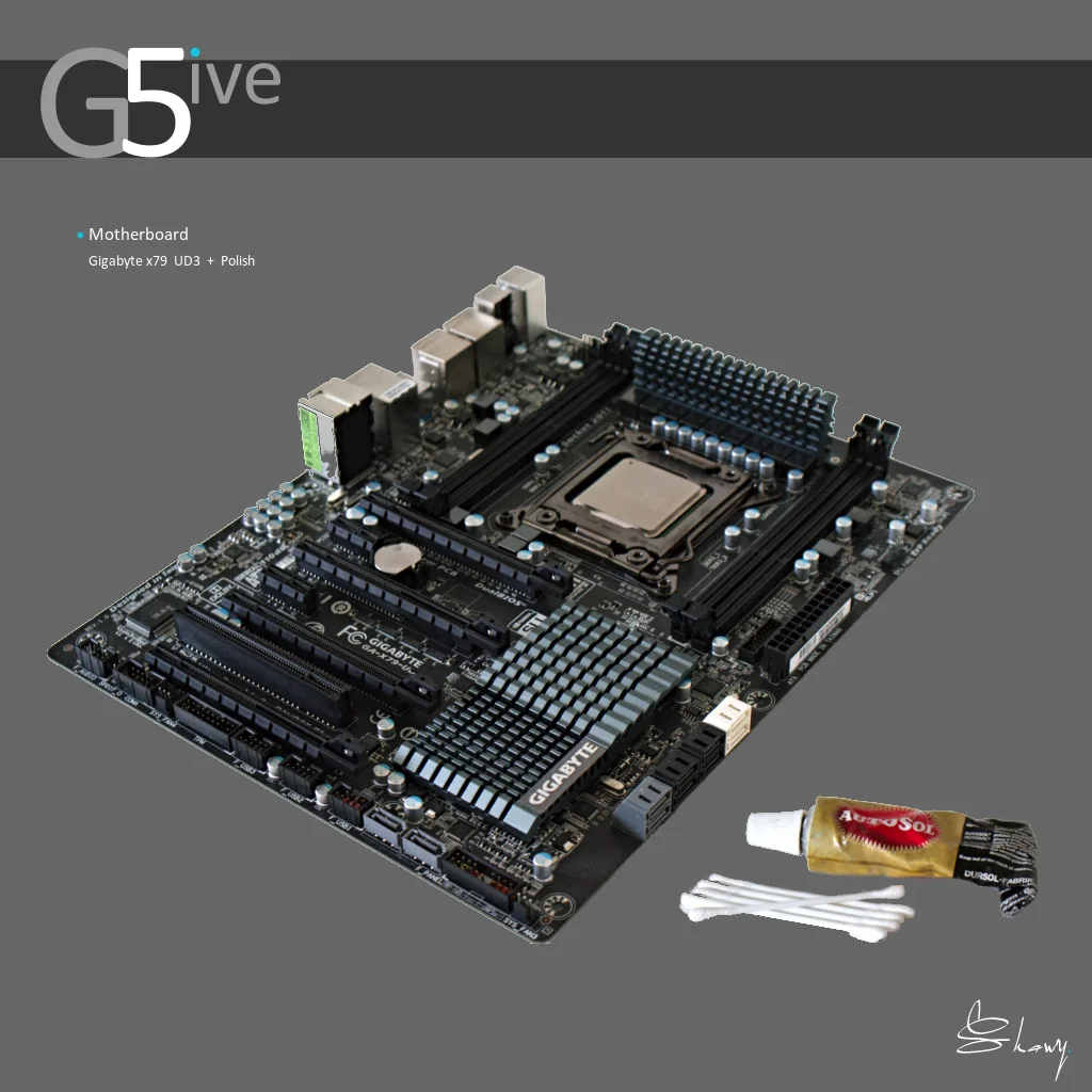

Not much of an unboxing as I grabbed a B grade motherboard for £120, but here's a little teaser. I'm sure you know what's coming.
