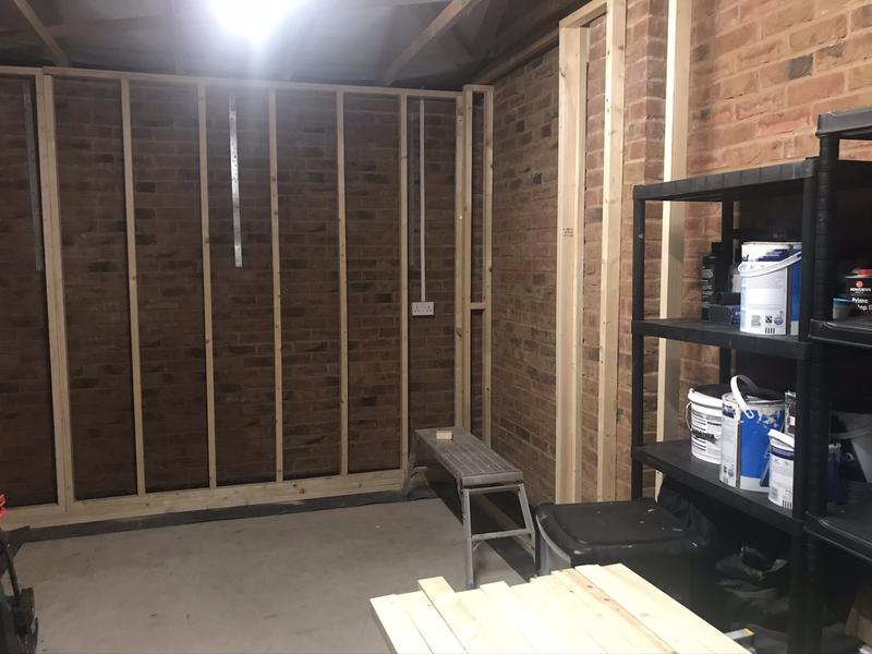

Working from home full time, I find it difficult to sometimes separate a work-life balance, especially as I work really long hours.
We have also needed to convert one of the bedrooms into an office. As such, I recently decided to split our office into an office/utility.
  • The garage is not utilized, apart from a dryer and spare fridge
  • It’s completely private. Behind the garage is protected forestry that no one can build on.
  • We have a large drive that can easily hold 3 cars, so putting a car in the garage has never been a thing.
  • Adding a side entrance from our garden.
  • The build will be done completely out of timber-frame and will be easy enough to remove should we ever sell the house.
  • Great excuse to kit the office out with some cool tech. For example the 65' Q70 TV will be going up above the desk :) (Heating, lighting, doors, security will all be WiFi)
Design.
The office will be 8sqm with a double partition wall. A 1200 patio door will be cut out of the single skin brickwork from the side entrance to allow access to the office space. The front opening of the garage will be a storage/utility area for kitchen cupboards, worktops, washing machine, tumble dryer etc.
Opening the garage from the front of the house will look like any other garage. You will not be aware behind the wall will be an office as its fairly long garage.
The office area will be heavily insulated and have underfloor heating.
Side Entrance (from rear garden - double patio door to be installed)
Looking good! Tell me please, how have you stuck your framing together? Nails, screws or magic? Pilot holes/whales?
On a more depressing note, are the backs of those planters the garage bricks, or more timber?
Last question ;): Why so many sole plates? (I am learning too and about to do a half-bottomed approximation of this)
I have a builder doing the work - he is using screws. Nothing is nailed. The idea is that "should" this ever need to be taken down, it will be like a flat pack (in theory).
There is no depressing note - the is NO soil touching the brick work. Everything is timber front and back with railway sleepers, they are merely sunken at the back (out of shot). I will simply chainsaw the sleepers to create an opening to the patio door / for the builder to be able to disc the entry. Then entry will be slabbed and dressed with entry lighting etc.
The sole plates are to raise the flooring. The floor will be suspended to be the same height as outside. There will be no step up or down plus, its added protection as is only a single skinned brick.
sole plates should have been pressure treated timber.
Possibly, however surely there is no need to use treated timber so long as it is going to remain dry?
The framing - there is no direct contact with the concrete. The entire is area has been wrapped around DPM, drainage holes are also going to be used to let any water run away from any area (IF) we are to have any slightly damp leaking through the brick.

Following! Nice project, hope to see more pictures. Are you insulating the framing, and what about the roof?
Electric : The garage has its own fuse box but is connected to the main house. They run off the same ring as i am using the electric to carry the WiFi out there. Brilliant bit of kit from TP-Link. (TL-WPA4220)
Roof Insulation: The garage roof is vaulted. The builder will be plaster-boarding across the beams, so we will have a good 15 feet between the plasterboard and the top of the roof. I can add as much as i like i.e. 270mm+
Underfloor Heating: i will be using; Underfloor Heating Kit for Laminate / Wood with a WiFi Thermostat that i can program across 7 days. So i will have the heating come on at say 5am before going in the office to start work at 6/7.
From the middle of the garage looking up, as its hard to explain.
The office side will be plaster boarded at the beams. Then it will blocked off so one side will remain as is (with a new utility) and a normal ceiling office side. This is why a sky light (at this stage) might not be possible.

Slow progress due to the weather. Today, we got the floating floor down ready for the underfloor heating.
Tomorrow the electrics going in:
Underfloor heating; wired / wifi
5 x double / USB sockets (2 exterior side for utility room)
2 switches
Ceiling Spotlights
2 outdoor PIR/ lights
Camera System / PIR sensors
Hopefully this week, the patio door will be in and the oak floor laid, with the plastering early next week.
There will be 100mm insulation going into the walls and 200mm in the roof.
There is also a custom desk' being fitted/moved that has been made up to exact same dimensions ready to go onto the back wall when the floor and skirting are down.
