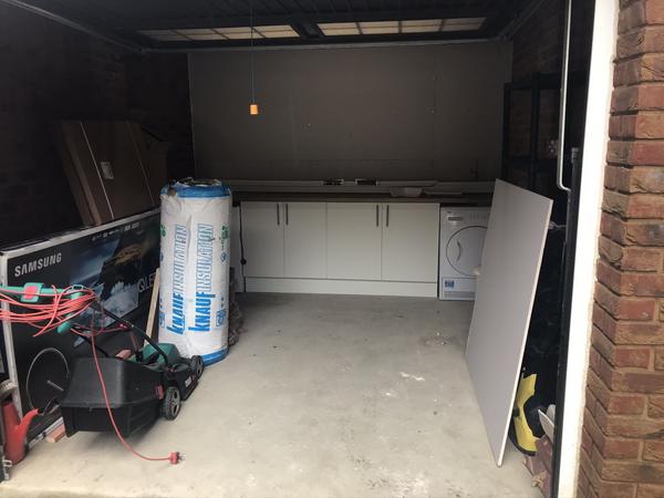

Few progress shots. Build is coming along' however i am currently in the "in a bit of a mess" state:
Room will be plastered this week then finishing touches such as the heating; flooring and skirting. Then the carpenter will come to fit the custom desk etc.
The front side (garage door) is a bit of a mess at the moment but as soon as the carcasses are fitted i can start fitting the worktop and wallpapering the fake wall.

Nothing fancy 4 spots inside and 2 up and down wall on the entrance. There is also an alarm being fitted and blinds.
Progress is a lot slower than i had anticipated. The electrician' is so unreliable he is holding the job up massively. The builder and carpenter; cant do much until all the electrics are in :(
Its still a mess. However the garage is coming together and it almost be impossible to tell there is a room behind due to the size of the garage. I suspect should I ever come to sell the property this would not put people off.
