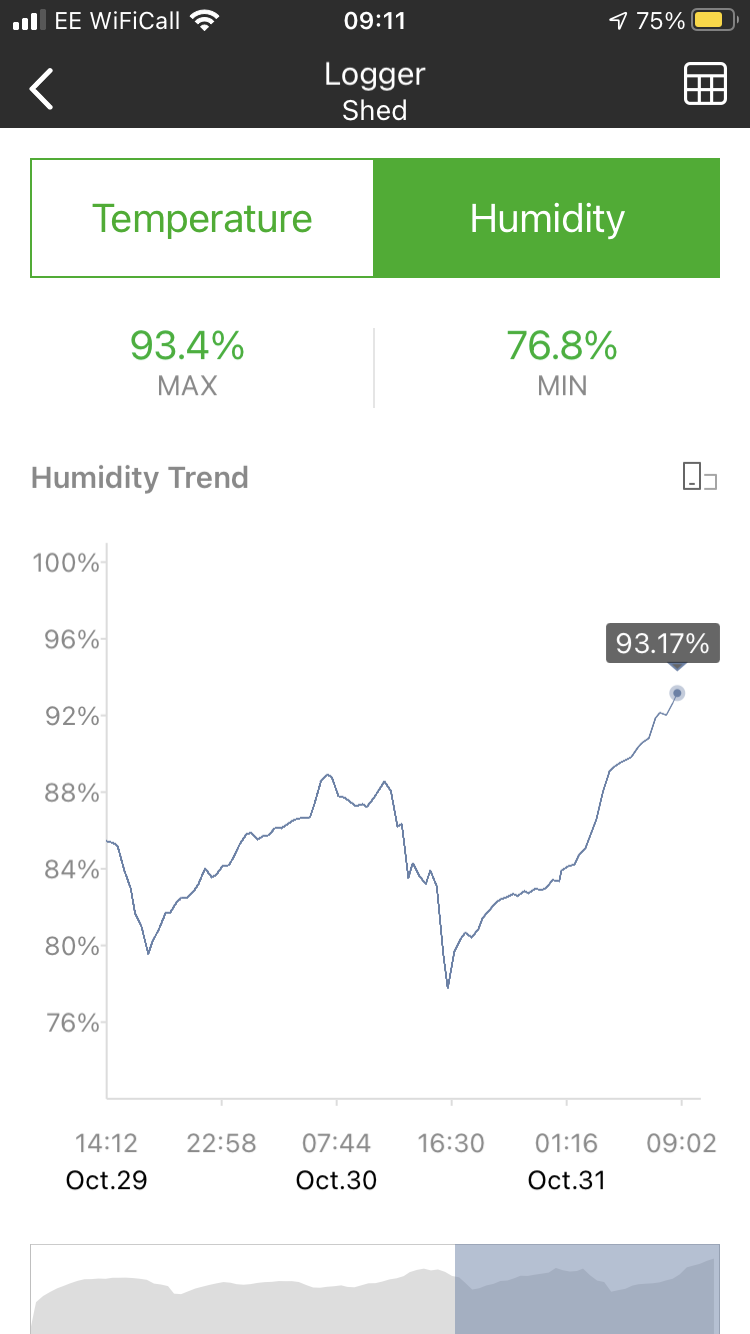

Good question. The humidistat was set to target 50% so I’m not yet sure. The obvious reasons would be either the dehumidifier is operating at its maximum capability or the influx of the external air mass through leaks is levelling it out. Or both. Or maybe the contents of the garage (cardboard boxes etc.) are still drying out? Having spoken to the manufacturer before buying they suggested the unit should be more than capable of bringing the RH lower so I’m leaning towards the air leaks. I’ll plug it up and see if that has any effect.Why does it suddenly stop reducing the RH? Does it switch off? Is the garage well sealed?
45-50% is the target to apparently stop all corrosion. Below 60% seems essential.
