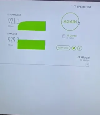

Gigabit Internet Speedtest

Well my original post linked to this result taken on the 07/10/12 but I edited it...
I then got another result from someone else dated 13/01/13 which proves it could handle 1 Gbps...
I didn't get onto the service until 10/08/18 and I was supposed to be on a 1 Gbps service for a months trial, however I didn't get near 1 Gbps speed.
It wasn't until 28/03/20 that I was put on a 1 Gbps service again to help those working from home that I finally saw 1 Gbps speeds from my connection.
So for some reason I wasn't getting near 1 Gbps initially when I was supposed to which led to confusion about whether I actually could.
