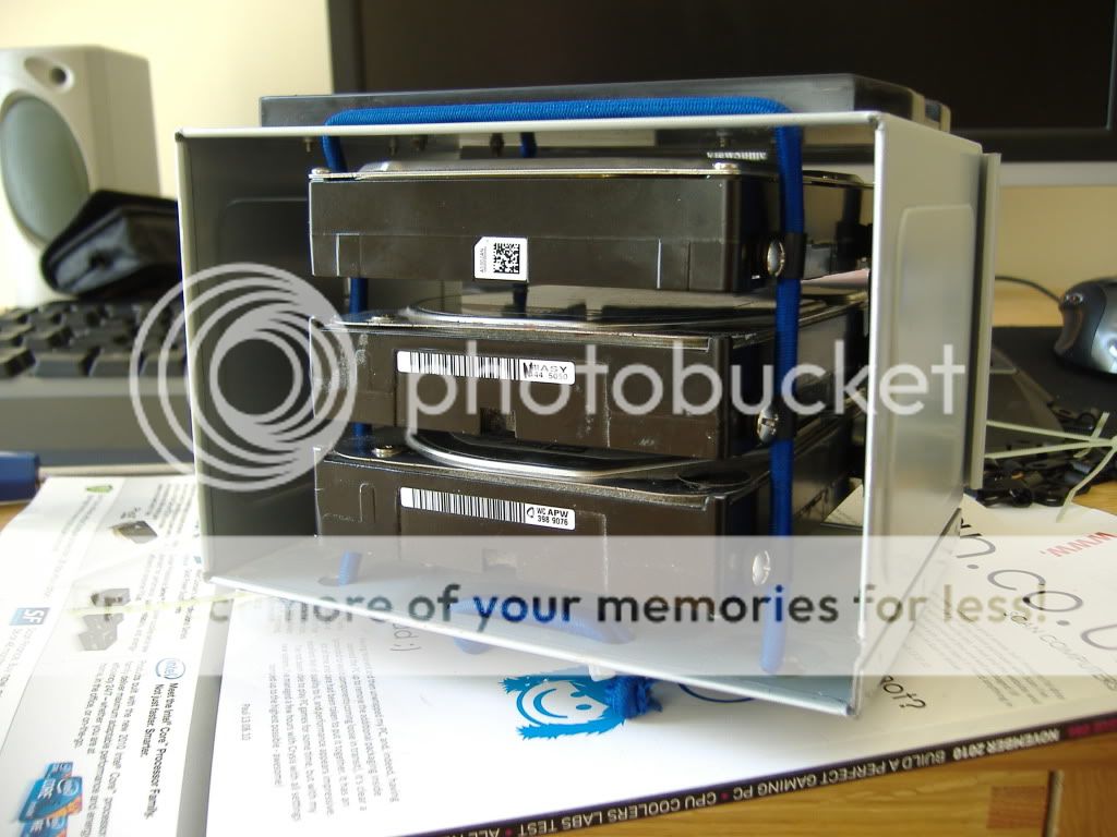

Suspended HD's are nice as well, make a big difference in noise and is cheap too!
Indeed.
Was fiddly as hell to get 3 in there like this but...oh my god the difference it makes. Considering the drives were sat on silicone grommets of the P183 I was shocked and stunned at the difference.
Indeed.
[IG]http://i959.photobucket.com/albums/ae72/Tealc_wii/PC Stuff/suspendedHDD.jpg[/IMG]
I found that with my F1 also, while it can't quite get rid of the spinning sound, it virtually eliminates seek noise. :cool:
I plan to elastic mount an F4 once it arrives, can I ask where you got those black things that go between the bolts and the elastic? Or what they're called? I'm currently using zip-ties to keep my HD attached to the elastic, and while it works, it's far from ideal... :o
