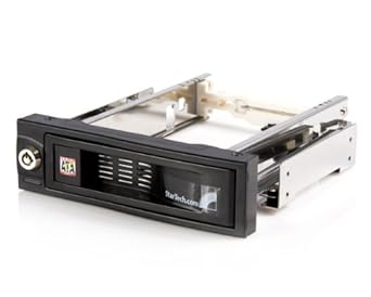

Can someone confirm whether I'll be able to use the Nexus double twin using the StarTech 5.25in Trayless Hot Swap Mobile Rack for 3.5in Hard Drive?
For the sixth drive, will another Molex Power to SATA cable and additional SATA cable be required? If someone can confirm this, I think I'm going to fork out the cash and buy the final (6th) drive once I get home from work tonight!
I must admit, I'm thoroughly impressed with the ability to add a total of six hard drives. When I first purchased my HP ProLiant server, I thought I'd 'only' have four slots! :)
Damn! Ah well.. thanks for clearing that one up! :)
What about the cables? I'm assuming I'm going to be requiring two of everything?
A molex to 2 x SATA Y-splitter will cover the power with a right angled SATA cable (if memory serves correct) and an eSATA - SATA cable will sort you out in terms of cabling.
