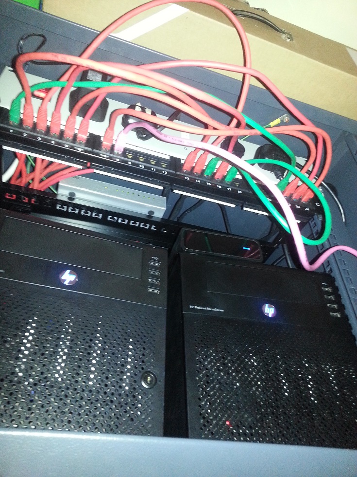

Excuse the dodgy photo but these are where my two are now up to
They now live in a cabinet rather than on a dodgy shelf!
Left is:
N54L - 8GB ECC RAM - 256GB Sandisk SSD - 5 x 2TB WD - Additional Dual Port Intel NIC
Running ESXI 5.1 U1 with various VM's
Right is:
N36L - 8GB ECC RAM - Original 250GB - 4 x 3TB Toshiba - Additional Intel NIC
Running NAS4Free with the Toshiba's in a ZFS array for storage and the 250GB drive used as a random dumping ground and ISCSI target when needed.
