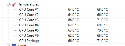

Running 2x EK 360 PE rads with Noctua NF A12x25. All fans run at around 1250 rpm in game. 800rpm idle. D5 pump running at 55% (2350rpm). No other case fans, bottom radiator pulls in cold air, top radiator exhausts the warm air. All in a Lian Li PC-O11 Dynamic XL.
Anyway, so the loop goes pump/res > rad > GPU > CPU > rad > pump/res. My CPU is OC'd to 4.8Ghz with 1.3v on the core (8700k delid), my GPU is a EVGA 2080 ti XC Ultra which is OC with +160 on the core and +1000 to memory, 130% power target.
My CPU package sits solid at 65C with max peaks at 70C and my GPU 55C after very long sessions but never much higher in a room with an ambient temp of 23C.
I think the CPU is a little high? GPU not so much, liquid temp is unknown but the above numbers are on a solid load to both the GPU and CPU, I've a liquid temp sensor, I've not not installed it yet.
Seems about right - typically the GPU temp tracks liquid temp quite closely. For instance mine caps out at 53°C. Whereas the CPU has more of a delta from water temp to silicon temp. This is partly because of the extra thermal interfaces from silicon, through a TIM to the heatspreader then more TIM to the block. That's 2 extra heat transfer relationships compared to GPU die under a block.
But also that temperature difference seems releated to CPU heat production - under load it jumps, remove the load and the chip is closer to water temp again. And the gap seems bigger with higher voltage and clock speeds. Heavily overclocked chips seem to sit 20-25° over water temp under load, whereas at stock was more like 10 for me.
8700k at 4.8 is a fairly big heat load, so the main factor is "are the temperatures ok for me?". 65 I'd be ok with, hitting 70 I may look at additional cooling or voltage tweaking.

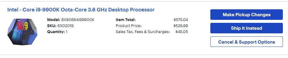

I'm about to head into San Francisco, Best Buy has one left in stock, just placed an order on it for pickup. Time for an upgrade! Plus, I need to drain my loop and install the liquid temp sensor and flow meter anyway, new liquid being delivered today. I can also make an attempt at bending some more tubes as some of them are less than ideal haha.
Also, I have a Z390-E motherboard, I thought I'd get it to future proof, it seems it was a good move.
