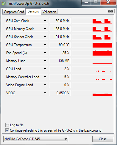

PS. Any chance of a screen print showing the sensors tab on GPU-Z?
Available here if you don't already have it: http://www.techpowerup.com/gpuz/

Note I have had the PC turned off all day and the screenshot was taken immediatley after I started the PC, enabled the GPU and restarted for the changes to take effect.
edit - I have just checked the fan and it's not spinning at all although it says there it's at 85%. Do you think it would be worth taking it out and putting it back in again?
The fan has failed but GPU-Z thinks it is still spinning. If you are within warranty, RMA the card and if not, it isn't worth spending money on repairs IMO.
