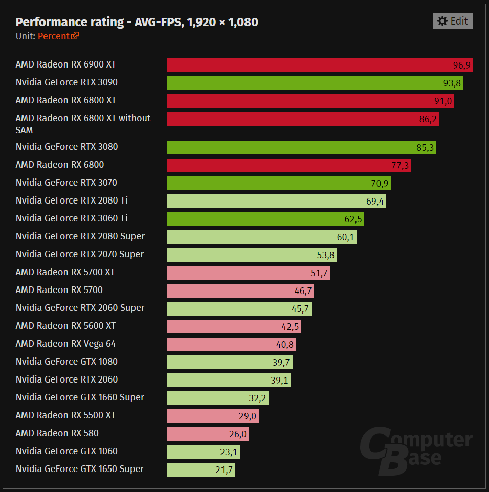

1080P

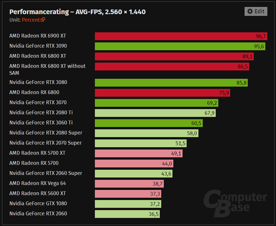

1440P

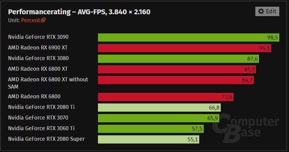

Couple of things that stand out to me. Does anyone remember when it was proclaimed that the 3080 was faster than the 6900 XT at 4K? That aged badly.
Also worth noting that the benchmark clearly shows and comments on the fact that Big Navi scales well at 4K, instead it is the other GPUs that scale poorly below 4K.
Two common myths busted and put to bed.

I'd have to say the testing method seems to be flawed somehow, the 3090 gains performance as the resolution increases.
If it merely remained static then it would clearly be CPU bound, but what's happening in those results doesn't make sense as it gains nearly 7% going from 1080 to 4k
Taken from the review. (google translate)
A weakness in high or low resolutions?
The question now is whether AMD's RDNA 2 in Ultra HD breaks away a bit or Nvidia's ampere in low resolutions simply can't properly utilize the massively increased number of execution units compared to its predecessor with barely changed front end. The new benchmarks point to the latter, as they have done before.
The Radeon RX 6900 XT can maintain its lead over the GeForce RTX 2080 Ti in all three resolutions (40 percent in Full HD, 42 percent in WQHD and 41 percent in Ultra HD). On the other hand, the geForce RTX 3090 significantly increases the gap to the GeForce RTX 2080 Ti in high resolutions (35 percent in Full HD, 41 percent in WQHD, 47 percent in Ultra HD), suggesting that the large ampere GPUs require many pixels to properly utilize the ALUs. Because a CPU limit no longer exists with the Used Ryzen 9 5950X at the latest in WQHD.
That doesn't make my statement wrong. There is a flaw in their testing and it needs to be addressed. The high end Nvidia cards are uniformly faster at higher resolutions than they are at lower resolution.
That's completely counter intuitive and indicates a flaw in methodology.
