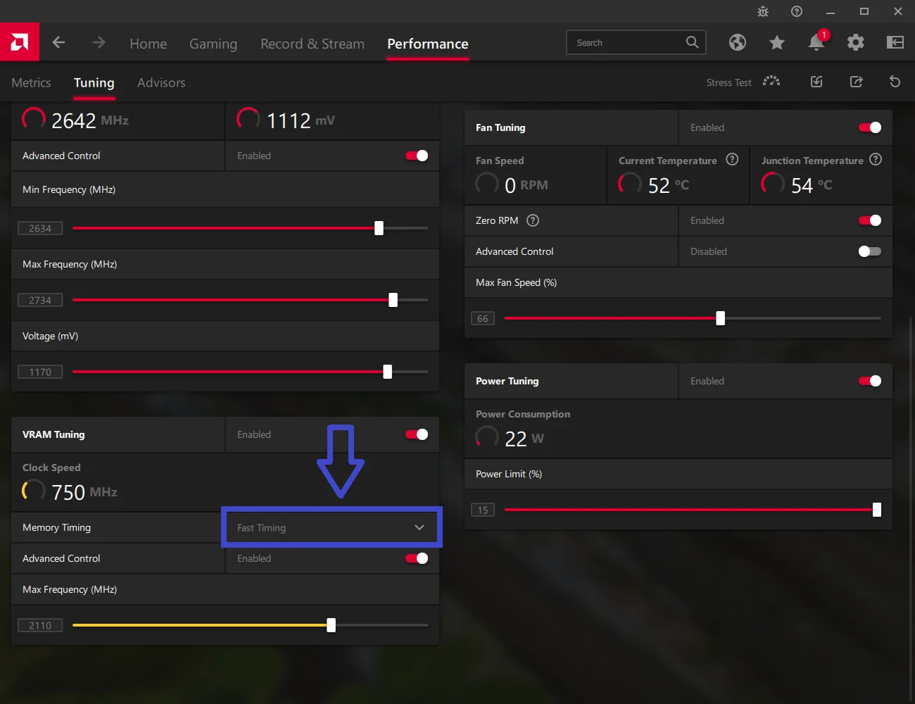

Did you tried set VRAM to fast in Radeon settings?
I found a pic that may help you to find it in Radeon software.
If you already tried it and it didnt help then I recommend you to switch back to Nvidia to get RTX 3060 and you will be fine, no more stress and grief. AMD drivers are absolutely rubbish and far the worst ever, brought back bad memories of my old Sapphire HD 5870 have me lots of stresses tried to messed 10 official and modded AMD drivers with tons of settings but nothing worked with issues on every games. Reinstalled, clean installed Windows Vista and Windows XP did not fixed it but switched back to BFG GTX 260 with 1 driver worked fine with all games out of box with no changes in driver settings.

Also are these the right settings to have ? Should I have Overclocking VRAM or overclock GPU.
Hmmm I dont see VRAM Timing on screenshot.
I browsed youtube found a video that should help you tweak settings to unlocked and enabled VRAM Timing.
