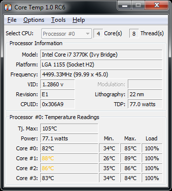

Do these temps look right for an H100? I just installed it today, and it seems to perform worse than my Corsair A50 air cooler I had...
This is a 4.5ghz overclock on a 3770k. It's stable, and no settings have been changed since installing the H100. My temps seem to have risen by about 10 degrees since installing it.
Uhh looks a bit high. My 920 kuhler on my 2500k @4.4 idles around 32c and under prime for an hour only hits 70c or so. The h100 is reportedly better so something looks wrong
i tried reseating it, and im using MX-4. not sure if its faulty or not :/
Another weird thing, is that Core #1 seems to be the coolest when its idle, but the hottest when its under load...
as far as im aware, you cant change the pump speed. the button on the cpu block only controls the fan speed
theres no software to control it. I was thinking I might just have a dodgey CPU, that doesnt transfer its heat to the IHS properly, but then that doesn't explain why my air cooler seems to perform 10 degrees better :/

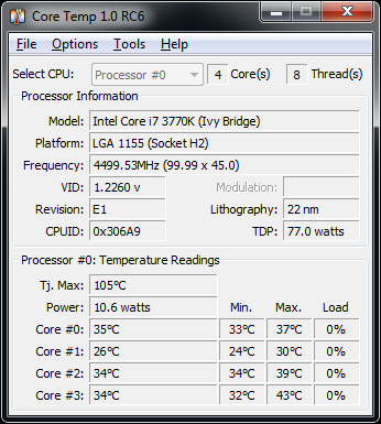

these are my idle temps

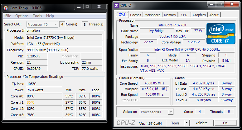

I just double checked everything, and noticed the backplate was mounted 90 degrees incorrectly. After correcting this, i've noticed no difference in temps. Still shooting up to mid 80's after 30 seconds of prime95

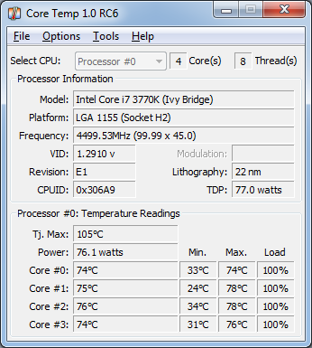

ok so i've gone ahead and requested an RMA. Reverted back to my old heatsink and my temps are back down by 15 degrees. with the MX-4 applied to it, temps never seem to go over 75 degrees during prime95. I think its safe to say the H100 isnt working properly.
