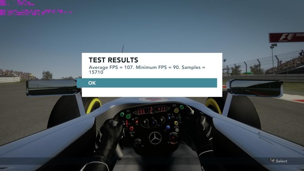

Actually, I just found an old benchmark that shows a minimum fps of 90 and an average of 107.
This was at 1100/1500, so you're definitely having issues there :)
