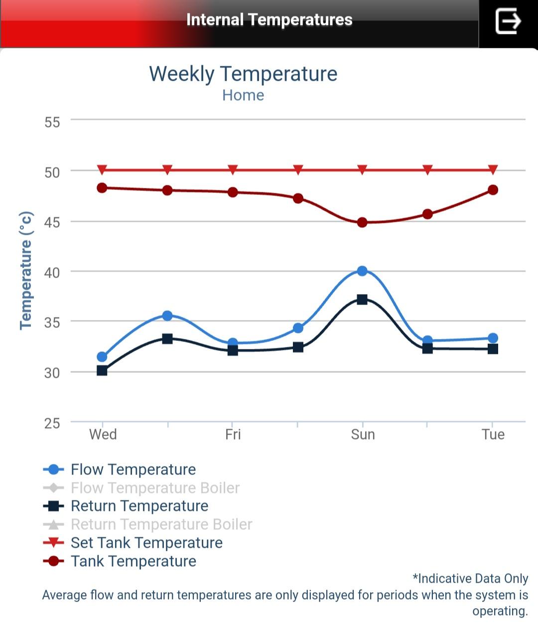

One thing I keep meaning to ask about is that when there is demand for heating in the house, the temp in our hot water tank drops. I don't know if this is normal. I asked the service engineer last time it was serviced and he wasn't sure.
But it very much looks like heat is being pulled from the hot water tank when the UFH is on. Has anyone else noticed this in their system?
That's not normal. Sounds like the zone valve for the hot water isn't closing when there is not a demand for heat so both loops are open to the heat pump.
The flow temps for heating will be lower than the hot water in the tank so if both loops are flowing, it will draw heat from the hot water tank. This will probably be causing your heat pump to cycle more.
Usually they are set up as hot water priority, if the tank is calling for heat then its getting all the flow from the heat pump. If it's not then it goes to the rads, it shouldn't be doing both at the same time, particularly when you have UHF as the flow temps will be far lower for heating.
This shouldn’t happen. The pipe work should have a 3-port valve, splitting the flow to either the cylinder or the central heating system. It shouldn’t be a single loop. Can you see this in your system?

Here's our weekly flow and return averages, currently the home is on a 19.5c daytime setback temperature and 21.5c 4pm - 9:30pm
On Sunday we used a lot of hot water due to spring cleaning the place, which is why there's a water temp and flow/return anomaly.
