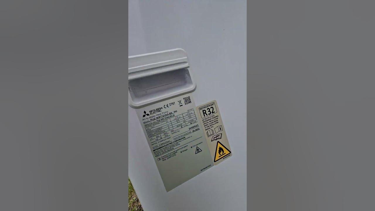

I think our heat pump is noisier than it should be, can anyone confirm whether this level of noise is normal?
It's definitely compressor side of things rather than the fan, it's noisier than I had hoped for if this is normal!
Agree - not normal.
Sounds like something has gone -fan bearings maybe? I’m just a homeowner so no idea but sounds like it’s time to get it serviced and repaired!
