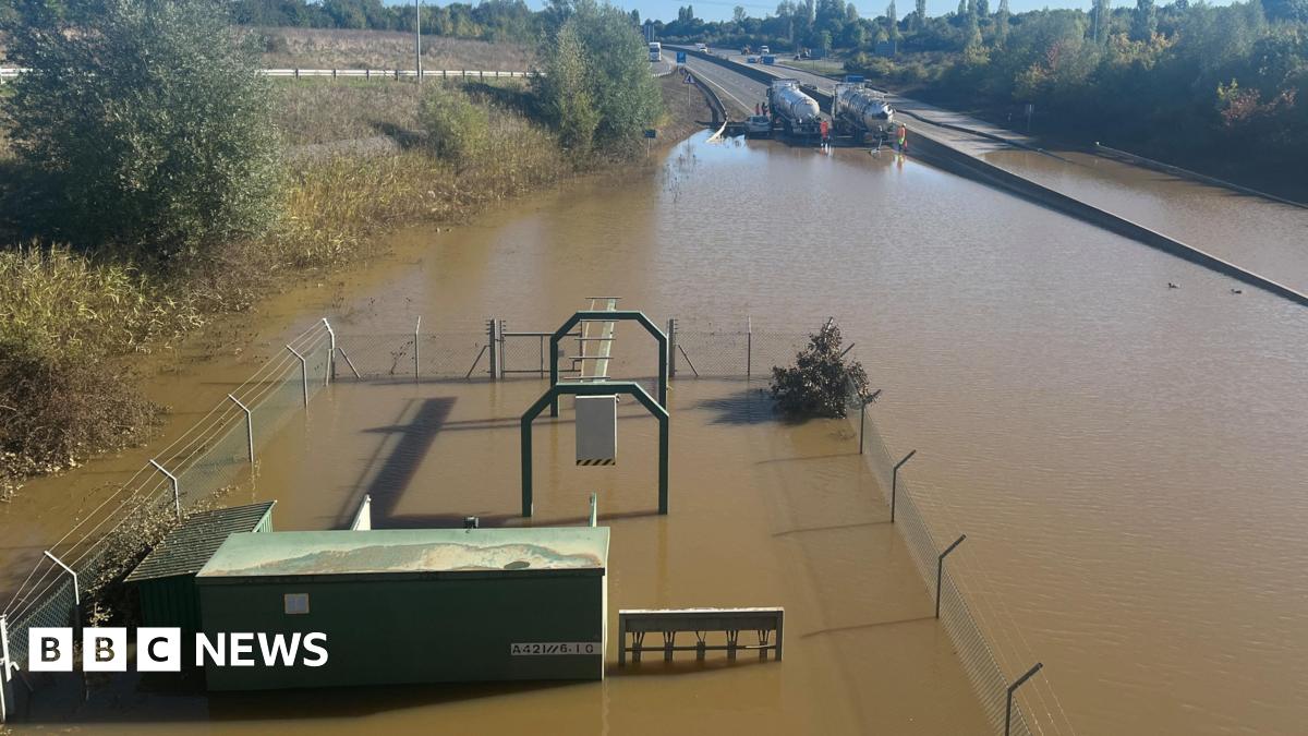

Then again we do seem to be backwards Britain now. Reminds me of this pumping station that was built to prevent the flooding of the A421 that got flooded.
