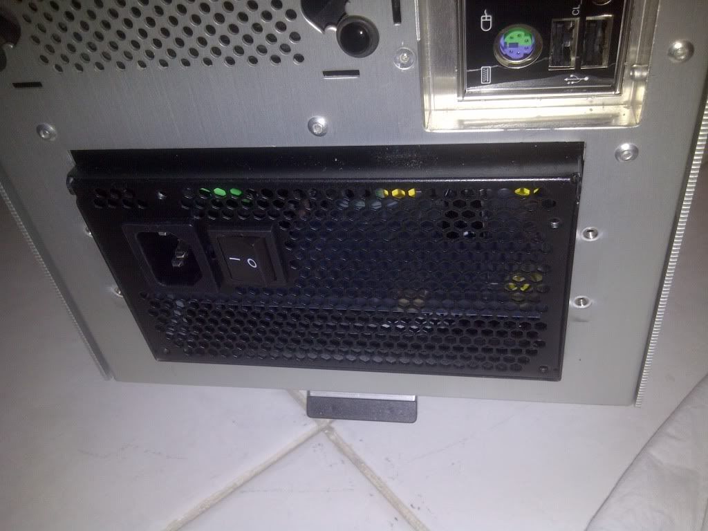

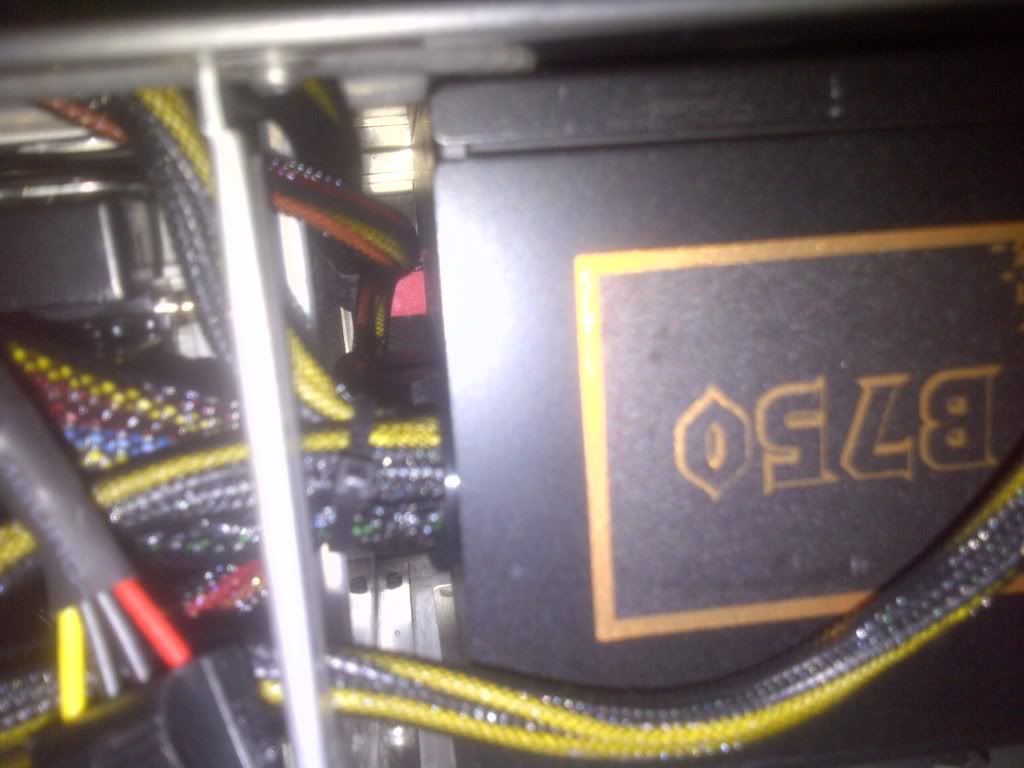

1. The Lepa PSU won't fit fully in the case; the modular connectors push against the internals...hence got it sticking out from the back slightly and can't screw it in!

Ok here are some pics:
can see the PSU sticking out
PSU from the inside of case...rear molex won't allow it to go back any further!
