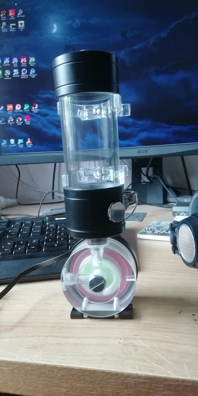

hi, just bought this res and pump
russian image host
Am i right in thinking i can use any of the three holes on the res as an intake and either hole on the pump top as outtake. Also wondering if i could fit a release valve on the front hole on the pump top. thinking of having outtake on the left as you look at the pic and the vlave facing you, if you know what i mean or have I conected it together totally wrong. I have been searching for tutorials on how to fit them but can not find any. the pump is a barrow and the res is bskyki
thanks
Yes, you can use either the side or top holes in the reservoir for intake or return of water (unless the internals are not the norm). The top is usually preferable when possible to reduce water turbulence.
Based on what I can see I'm fairly certain you've connected the reservoir to the outtake (wrong). The intakes are on the left and front in your photo. You can see how the channels for the left and front feed directly into the impeller. For the top port you can see a curved half circle, this is the outtake from the external part of the impeller.
You can fit a drain vale in the front if you wish since it's an intake port.
I believe that's a barrow spd10s. that's the one I had (until I upgraded) and it's a great pump for the price. As bugbait has said ,you have the res connected to the outlet. Only the left side and front can be used for inlet. The front is preferred as it leads right to the centre of the impeller.
yes that is the pump ;) . I have now set the centre hole as the inlet.

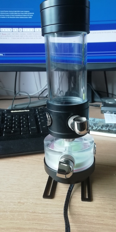

does this look correct. I am not using the top as an inlet as i have no tube for the top hole or does that not matter?
Also I was thinking of putting a release valve on the spare inlet on the pump top, would that be ok
