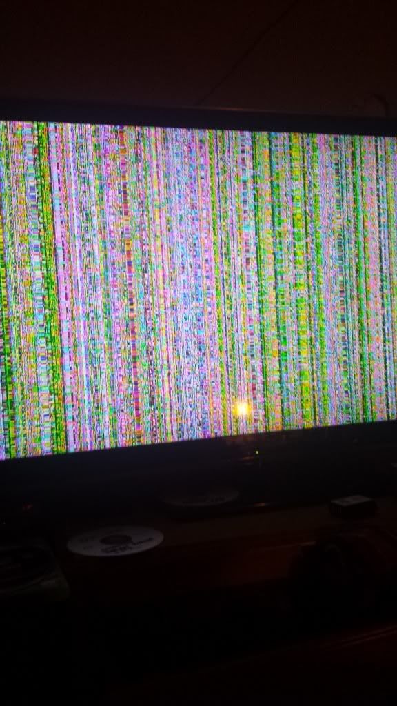

my girlfriend soon to be ex if shes broke it , said it was running slow so downloaded an antivirus called avas apprently or she thinks and restart all fine apprently , i come home to watch a film after a long day at work and im welcomed by this
now its on my samsung smart tv through a hdmi, i remember having loads off problems setting it up on my tv and ive tryed a 15pin? From the mb to the tv and thats not working ever
just cant seem to get it on the tv
the powers up as normal with same sounds and beep
havnt a clue i think im gona try it on a proper monitor bit any ideas or help if any hardware is broken i hope not but its a thought would i be under warrenty?

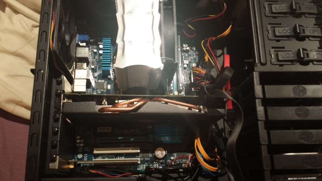

i opened her up and well shes clean not even that dusty or anything

right took battery out and nothing
took my gpu out and hay presto it was on and felt like crying that my expensive gpu had gone anyway missis told me the software
called
AVAST ANTI VIRUS uninstalled that and the rest off what came with it
thought i would try my gpu back in and wayyyy its all works again
so dont install that crap
and also the missis is band from my rig lol
Well i already took gpu out before and that didnt sort it only sorted it when i booted up when i left it out and then uninstalled the software then put the gpu back in
If it wasnt the software then the software caused it on my rig
it because its running through my tv , i cant even access the bios through my gpu n hdmi , so think it needed to do that startwindows normally option
so had to take the gpu out to be able to go to that screen
