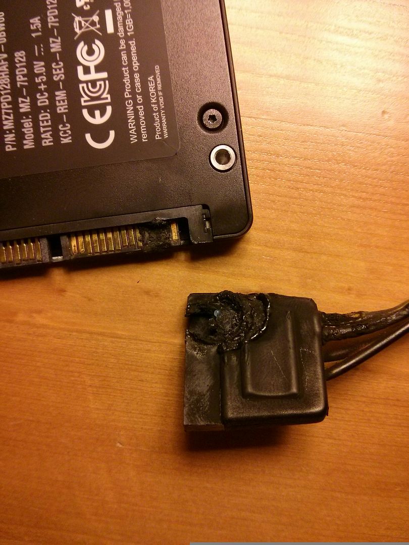

The SATA cable connected to my SSD got a bit frazzelled and now the part of the SATA connector on my SSD has melted plastic on it. Does anyone have any tips in cleaning the connectors so that I can recover the data on the drive? Or is it beyond rescuing?

looking at the picture I don't think there is going to be anything you can do to get the data from it.
it looks like there is about 4-5 metal connections missing or damaged where the black part is on the SSD.

I may be looking at it wrong but is that just plastic that's melted on top of the metal parts of the power connector? If so I'd be looking to use a Stanley blade to try and get it back to the metal connections. Just take it slowly.
Am with you on that, looks as if the plastic on top of the pins is whats melted off the connector .
Have to ask, How it happen?
It's definitely melted plastic on the pins. I'll give the Stanley knife a go at the weekend and see how I get on.
As to how it happened, I have no idea. I switched the computer on and after about 5 minutes it switched itself off and then I saw smoke and smelt burning plastic. I quickly unplugged everything. The only visible damage was to the end of the SATA cable and obviously the resultant damage to the SSD connectors. I'd had the PC nearly 5 years with no issues. The SSD was probably 2-3 years old. If anyone has any theories I'd be interested to know so as to avoid something like this happening again (assuming it's not just plain ol' bad luck).

Looks like the 12v line has shorted to the ground line inside the connector, got hot and melted the plastic onto the SSD pins. Would expect the SSD to still work if you manage to clean the plastic off so the new cable can make a good connection.
Cheap cable convertors are the most likely cause, if straight from your PSU then not expecting to hear that it is a good brand.

The PSU is an OCZ StealthXStream. As for the cables, the SATA cable is connected directly to a power cable that goes into the PSU.
I've used a craft knife to scrape as much of the melted plastic as I can from the pins. I'll probably give it another once over before I try to connect it again.

Good news. The drive seems to be fine. I scraped the melted plastic off the connectors with a craft knife and used a nail file to gently smooth off the slightly melted end of the SATA connector/PCB. I've just popped the drive into a cady and have it hooked up to an old nettop PC and all seems to be fine... So far.
