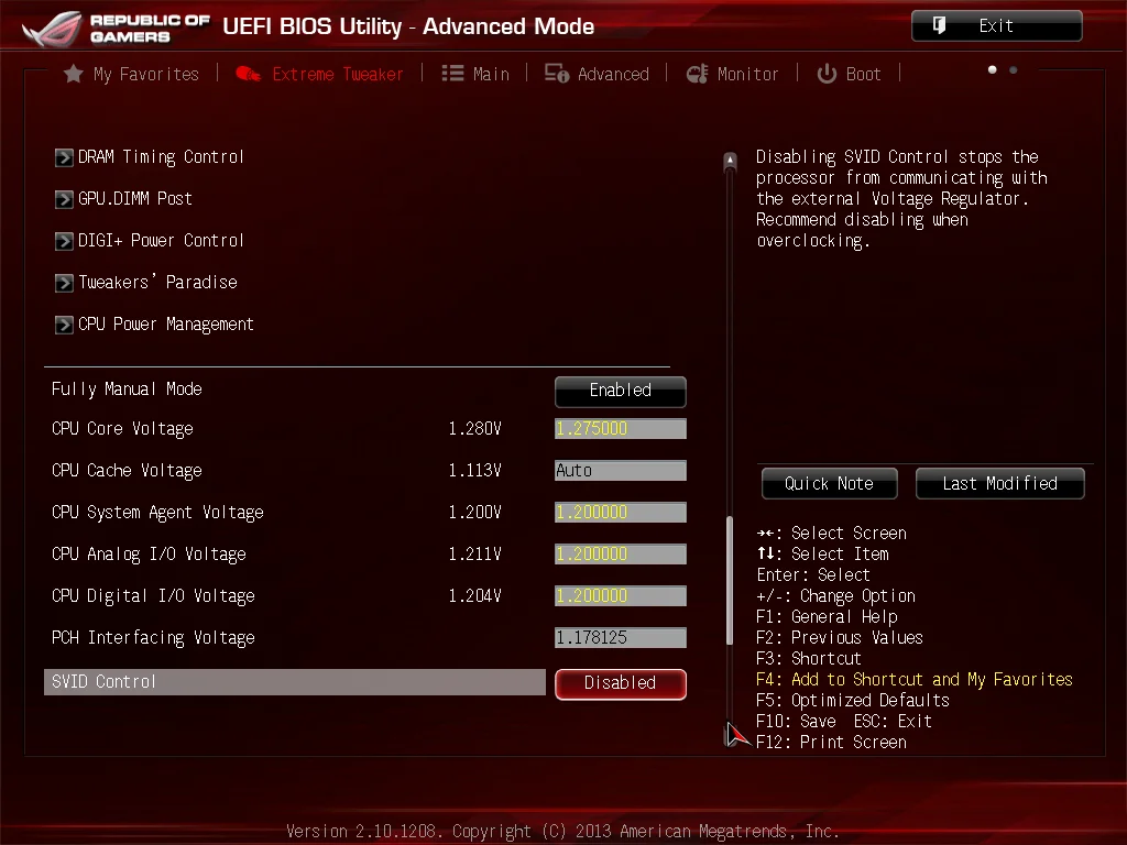

Yep, a boost on the following may help with 16gb, SA, IOA and IOD. I need 1.200 on each of theese even just with 8gb of ram. Probably down to the cpu being clocked.

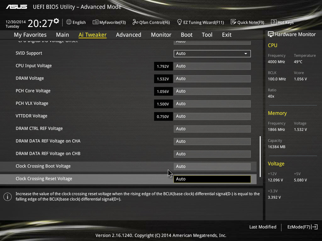

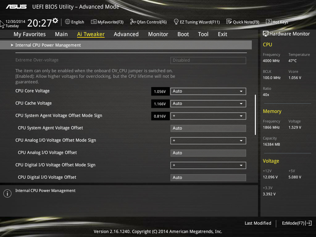

images from BIOS

On my board im using fully manual mode for most voltages, (not too familiair with offset tbh). But below is a shot of my SA, IOA/D. All in yellow which is well within limits. Any lower and i get a myriad of errors.
