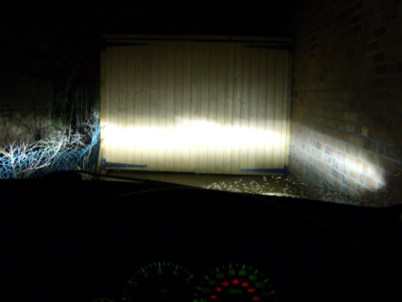

Here is a picture from the standard Focus lamps properly aligned with the HID kit.
Come on it's not exactly like thats completely glaring someone. Beam seems rather focused to me with minimal scatter?
It's all over the place!
They're proper HID's (using projector lenses)... Look at the sharp cut-off at the top.
Yes but the difference is that a blast in the face from halogen lamps is classed as causing discomfort, whereas a blast in the face from an HID lamp is classed as disabling. Which causes problems in the event of an accident if the other driver reports being blinded and an inspection turns up incorrectly installed lights on your car.
Plus if people are already flashing your Halogen lights then thats a pretty good indicator that your headlight beam pattern is not that great.
Hardly all over the place compared to yours the beam just seems slightly out of focus but it's not as if it's glaring directly into someones face :confused:
Fair enough it isn't obviously as good as a projected beam but not the worst either.
Beam from my lights is uniform and flat, the one you posted seems to be concentrated high up and scattered everywhere - it is a lot worse.

Scatter is very minimal when properly aligned
Imagine how much worse that beam is if you get further and further out.
