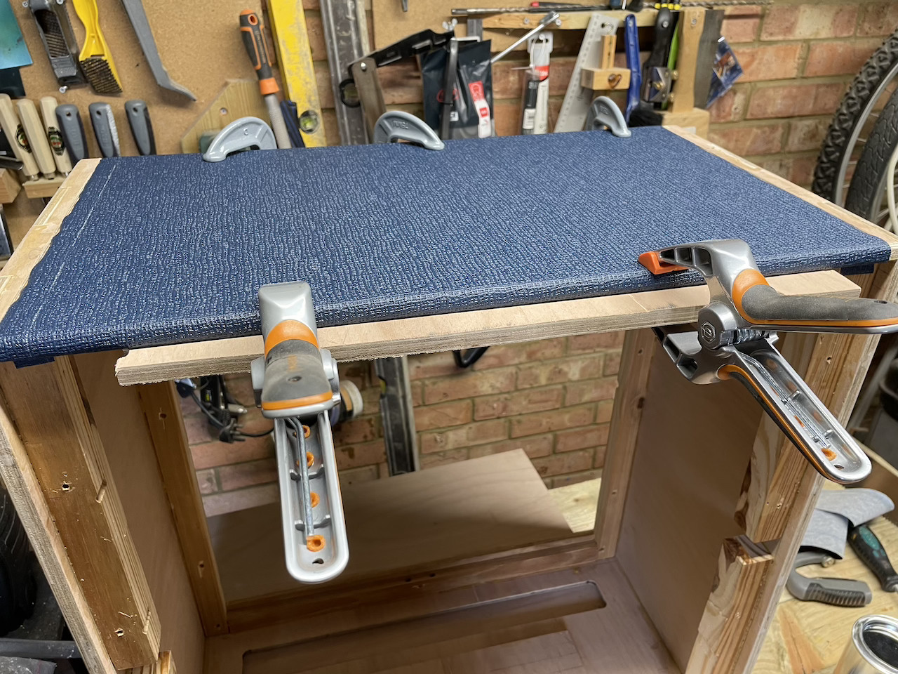

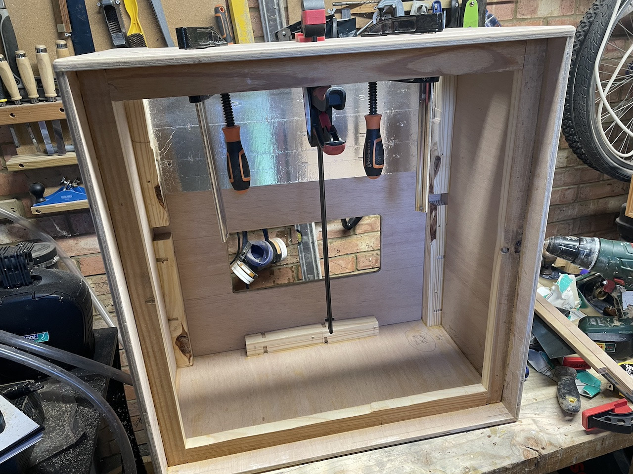

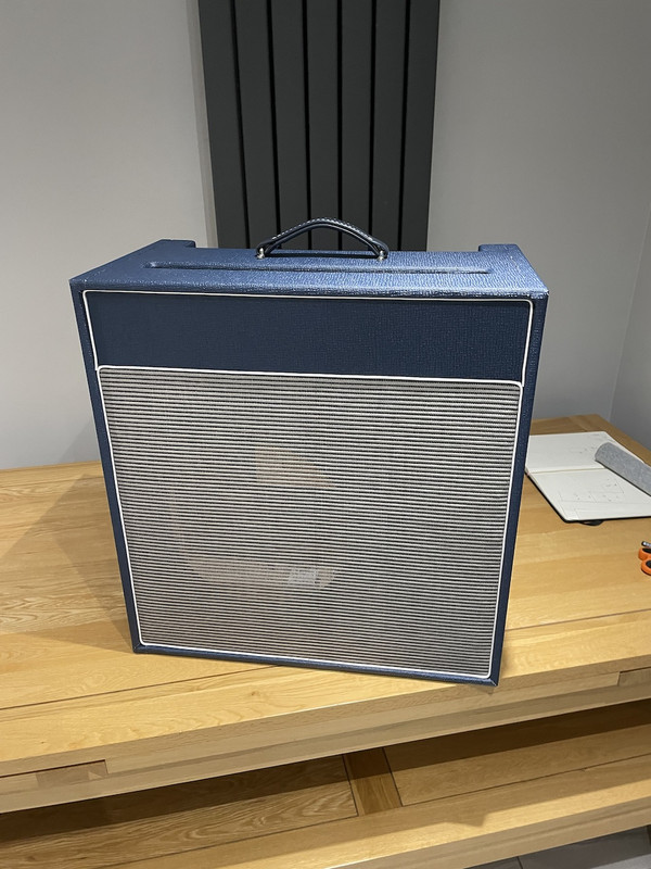

Nice wood is going to cost quite a bit. Beech plywoods - a 9 ply 12mm 2.4x2.4 sheet was just over £100, baltic birch will be £££ - you could make frame out of doubled up plywood glued. You can then make it as hefty or as flimsy as you want. Beech's hardness is basically the same as Baltic Birch without the nordic premium (russian sanctions have cut off a baltic birch large supply chain leaving the just the nordics). The local suppliers for me will cut - and I got the supplier to cut the dimensions for the tube amp which make it easier to transport and not make a mess! (you may get charged per cut and they may only do full width cuts, hence work out the design layout on with those limitations)
I've build my tube amp out of it, a dual printer stand for keeping the Mr's desk tidy etc. I did wide fingers for the corner joints so I didn't need to use a routing jig. With the right design it should be ok.. Plywoods will make a mess if you go down the DIY route. With the right design it'll be very sturdy - I'd suggest making a box including a bottom, I'd also advise a rear panel to give it structural integrity - that can have large hole but the corners leave. You can bond the shelf supports in and add blocks of recycled pine in the corners - that will make it even more study - then you can add pads for vibration dampening for the shelves should you wish..
This was my amp build but you get the idea . You can make a finger interlocking back (but could route a large hole) but for my build I needed both the front and back removable (they're screwed in) to access the amp and the speaker etc:
Left image if you look at the corners you can see the wide fingers. You will probably need a strip of ply (ply facing up) to make a support under the shelves. I recycled an old coffee table leg for the pine hence the rough appearance :D
End result just before I fit the tolex seam beading (that's the channel near the corners), metal corner protectors, feet and innards:
