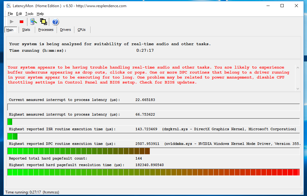

Yeah, and based on my results the nvidia kernel is the only one to blame, everything else is barely 0.2ms. Nvidia's Win10 drivers have been notoriously atrocious, and I'm thinking a downgrade to Win8.1 might be my last hope.
The rep I know personally thinks it is probably a power management bug - they have a lot of those needing fixes.
Also, have you actually tried running tests, or just saying that because you're not symptomatic? A friend on Win10 with a sandy bridge chipset and 760s showed similar results and similar audio popping on USB, he fixed it by getting a PCEi slotted USB card that plugged into one of the mobo USB slots and ignoring the inbuilt ports totally.
The lag was still there on his results though.

Your system appears to be suitable for handling real-time audio and other tasks without dropouts.
LatencyMon has been analyzing your system for 0:27:01 (h:mm:ss) on all processors.

CPU 13 Interrupt cycle time (s): 27.037791
CPU 13 ISR highest execution time (µs): 157.646667
CPU 13 ISR total execution time (s): 10.779842
CPU 13 ISR count: 1079764
CPU 13 DPC highest execution time (µs): 299.5540
CPU 13 DPC total execution time (s): 9.908779
CPU 13 DPC count: 1806810
_________________________________________________________________________________________________________
CPU 14 Interrupt cycle time (s): 6.480367
CPU 14 ISR highest execution time (µs): 18.8960
CPU 14 ISR total execution time (s): 0.082402
CPU 14 ISR count: 22679
CPU 14 DPC highest execution time (µs): 158.270
CPU 14 DPC total execution time (s): 0.470746
CPU 14 DPC count: 119859
CPU 15 Interrupt cycle time (s): 6.430159
CPU 15 ISR highest execution time (µs): 0.0
CPU 15 ISR total execution time (s): 0.0
CPU 15 ISR count: 0
CPU 15 DPC highest execution time (µs): 157.962667
CPU 15 DPC total execution time (s): 0.115811
CPU 15 DPC count: 31810
