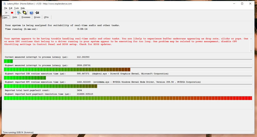

Got this with Firestrike running.
The Nvidia Driver is not too bad, its not great but not bad.
The Microsoft DirectX Driver is much worse.
