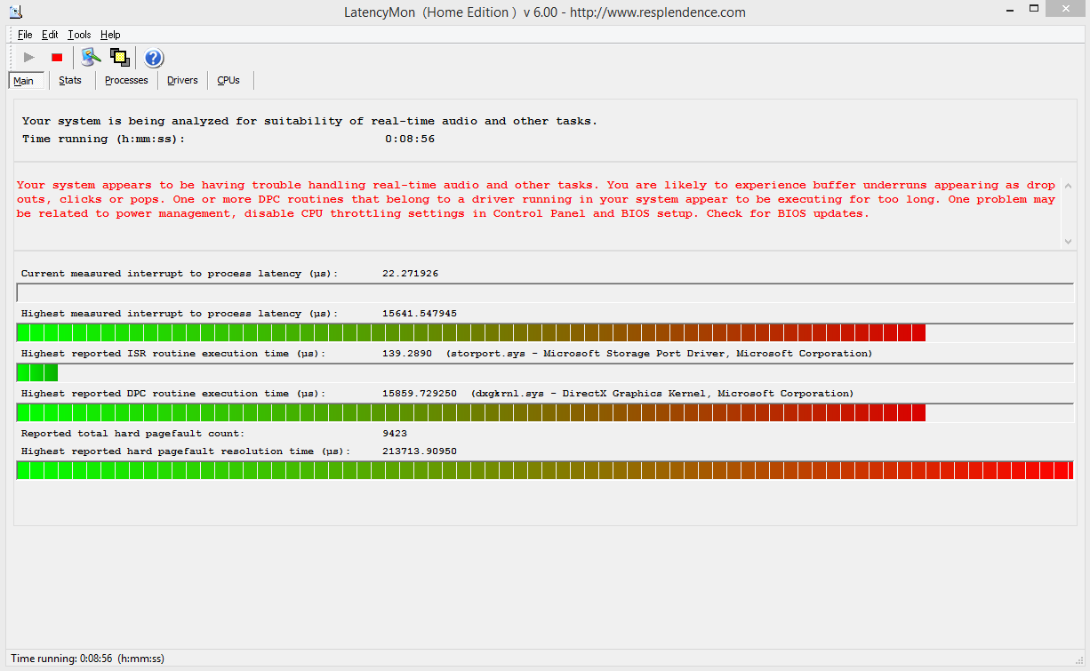

For some reason, I was playing League of Legends today, and I kept getting audio stutter, so I decided to check the DPC latency.
I used a tool to find out that the DPC Latency was incredibly high for dxgkrnl.sys which leads me to believe this is a driver problem?

You will be able to see when and how often the problem happens. I had the same problem with audio stutter/crackle and eventually found that the motherboard chipset (Intel sata) drivers were the problem.
The stoport.sys in your pic suggests it is the harddrive (sata) drivers causing the issue. The gpu drivers are probably getting high latency because of the high delay caused by the storport.sys.
Latencymon is the best out there. That program is so out of date it don't even work properly on Windows 8. Your also reading his results wrong the issue he as is directx, the Storport.sys has even past 0.2ms lag

Mine is almost always around the 15-16k mark, which is another reason I think this chap might have the same issue as me.
