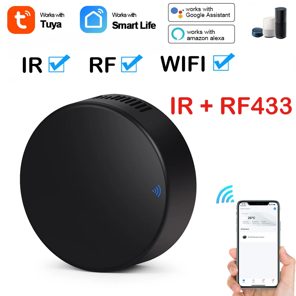

My main goal at this house is to control the gate via my phone/a button by the front door without remembering where the keyfob is. I'm fairly sure it'll be an RF transmitter but unsure what i actually need. Would it just be something like this?

I control my gate through HomeAssistant but I use a Shelly 2PM which is connected to the 24V power inside the gate control/motor unit, and the two relay outputs control open and close respectively.
Shellys connect to your wifi, integrate seamlessly into HA, they also have their own app which you can use via the cloud (my HA is intranet side only). I have found them bulletproof.
Cheers, i was looking at those for my house but as we're only in a rental and the gate is ~70m from the house, we don't have wifi coverage down that end and so i figure an RF blaster is the way forward.
At some point i'll be ordering a crapload of stuff from Shelly though!
I don't know what gate you have but I would expect that your issue is going to be that the gate keyfobs have a rolling code as a security feature and you won't be able to immitate that. So an option would be to use a spare gate remote, solder two wires across the button contacts on the remote, hook those into a wifi relay, and then you have a HA connected gate remote. It will toggle rather than instruct open OR close which is less useful but nonetheless it will do what you want here.
Ps Im also assuming that the gate is fully up to stadnard on safety features ie. IR beams and "safety edges" as if not, HA control could potentially be quite dangerous compared to before when the gate was only being commanded within line-of-sight.
