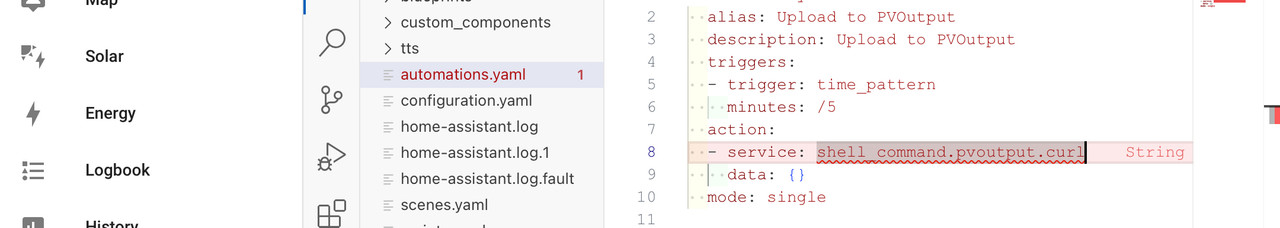

do i put this code in config.yaml in the editor software??

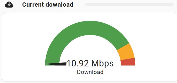

Which gives this:

I've got a few defined in configuration.yaml:
Code:
template:
  - sensor:
      - name: "Internet Download"
        state: "{{ (states('sensor.uxg_wan_in_stats')|float(0)*8/1024/1024)|round(2) }}"
        unit_of_measurement: "Mbps"
      - name: "Internet Upload"
        state: "{{ (states('sensor.uxg_wan_out_stats')|float(0)*8/1024/1024)|round(2) }}"
I can then call those sensors elsewhere. Such as:
Code:
type: gauge
entity: sensor.internet_download
name: " Download"
min: 0
max: 900
needle: true
severity:
  green: 0
  yellow: 750
  red: 850
Which gives this:
