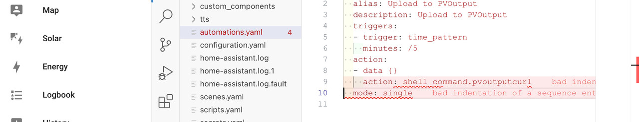

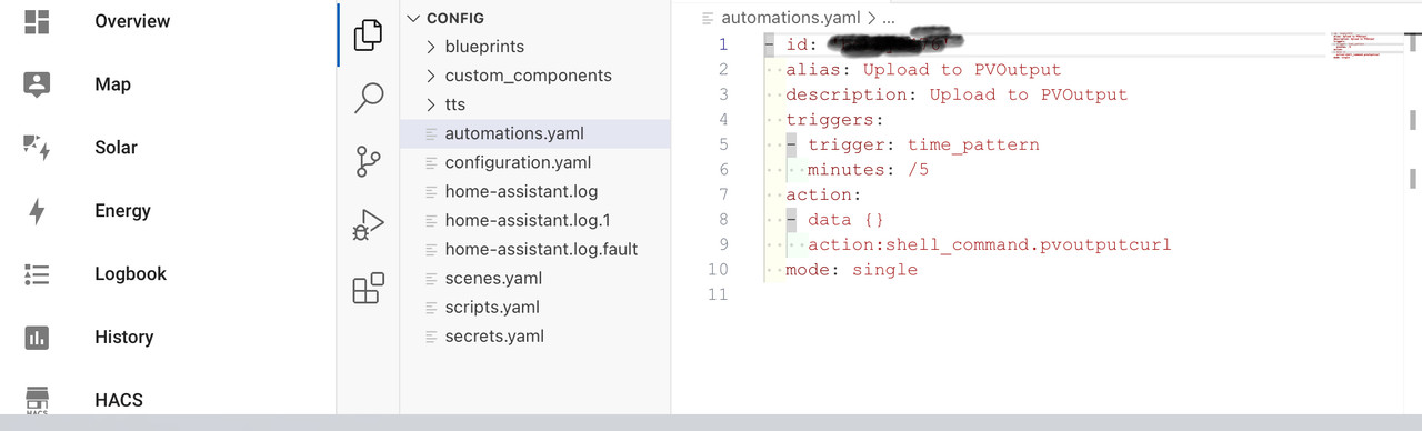

its telling me i have and indentation on automation line 9 - its the action:shell_command.pvoutput.curl - it doesnt like the indentation after action:Have you restarted home assistant? Go to Settings > System > Restart (button in top right corner)
If it has worked, when you go into Settings > Automations and Scenes, the automation should be listed there and it will tell you when it was last triggered.
i did that and it gave me a bad command indentation errorYou need a space between action: and shell_command.pvoutputcurl on line 9.
