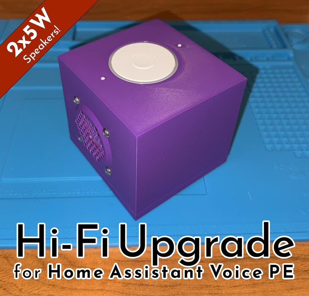

Has anyone on here seen the new Home Assistant Voice that Nabu Casa are releasing?
https://www.home-assistant.io/voice-pe/
Seems interesting since it has a 3.5 jack for audio output as I've been looking for something to replace the Google Homes/Nest Homes for a while now however it would have been nice if it had a semi-decent speaker on it as I've yet to find anything for the price that can do commands plus also works as a reasonable sounding speaker in groups
It’s been out for a while. I’ve had one since it was released but I have to confess I’ve not used it very much as I’ve just not had the time to play about with it. I’ve been put off by the fact I don’t like any of the limited waken words which is a very shallow reason not to use it! Even now I’d say that you get one to experiment with. The PE stands for Preview Edition after all.
Ahh, I saw preview edition and assumed it had just been brought out!
I'll likely pick one up over the next few weeks and see if I can bodge a semi-decent speaker onto it :)
There's at least one project that has already done that
