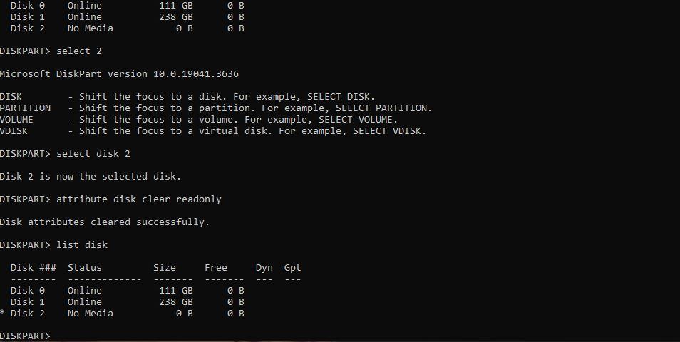

I don't think I have diskpart. It just took me to the command prompt and I have no idea on what to do from there. The drive letter for the USB drive is G: I've tried fdisk and format G: but Windows 10 don't recognize the commands and disk management gives me zero options
Diskpart is included with Windows but yeah, it is a command line tool.
Open diskpart (as admin), it opens the command line tool, type list disk which shows you all your drives, i.e:

In my case disk 3 is my USB stick so I'd type: select disk 3 and then clean which would wipe all the partitions/partition layout of the USB stick. Then you can re-initialize the stick with the usual disk management GUI tool. Just make sure you don't run clean on the wrong drive :p
I tried it, it shows as the USB drive being 0 GB but there are two partitions on it. I tried the clean but just gives an error.

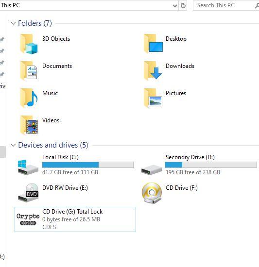

Ah my bad, I didn't realise you meant it had actual hardware encryption. Usually cheap 'encrypted' USB sticks just use software encryption which you can just format to remove. What does it show in disk management for that drive?
I'd give gparted and/or dban a go, but I wouldn't be surprised if neither of those can fully remove/disable the encryption either because it's done via a separate hardware chip
If I follow your screenshots correctly, only a virtual CD drive from the stick shows up in Windows?
I have a vague recollection that some sticks only show their actual storage after a low-level USB command (which the manufacturer's Windows software will send).
I think there's a mode switch command on Linux that can enable the storage mode without running the Windows software.

Cd drive G should automatically run when you insert it
That's integral total lock
Ie the software to password/unlock/lock the drive
If it doesn't automatically run
It may be due to a security policy on your pc preventing autorun
Or is your pc on a domain?

I don't know why CD Drive F: shows, I've only got one optical drive... I think something weird happened when I tried to burn some files to a CD last week but this is unrelated to the USB drive. I've not had much time today to try again. I'll run G-Parted in a bit and see what it does.
The USB stick does come with software when its plugged in it asks me to create a password but always complains that my password doesn't contain enough capital letters or lower case letters or not enough numbers so I don't know what to put, not sure if its a bug in the software but seems bizarre that it complaints no matter what password I try to create.
I tried G-Parted in Linux but the drive doesn't show in G-Parted so no luck with that.
I can open the drive in Linux and it displays as a CD with lots of locked icons.
I know there must be a way of wiping these USB drives as I bought one from CEX a while ago that had already been wiped.
I managed to create a password that it likes and I can now get into the USB drive but I still can't get rid off the CDFS partition. I can format it as much as I like but the CDFS partition remains. I need something to nuke it so that I don't have to keep entering the password each time I use it.
