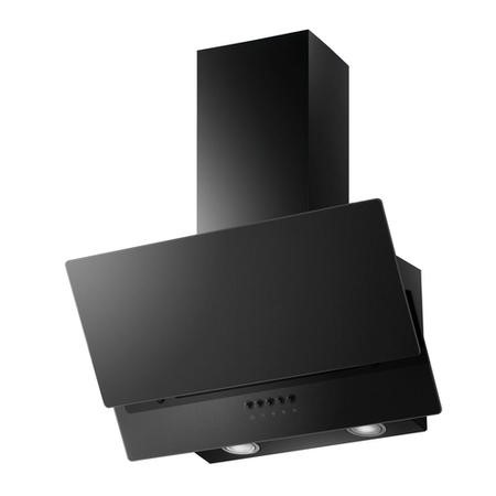

Have you thought about a slight different style? Our hood was going to be fairly low and a annoying hight for my head, so our hood is build on a 45° angle giving ample head room even though the lowest point of the hood is pretty low but that's out the way against the wall.
There is absolutely no way, when we finally fit a new kitchen, that we will be getting a traditional cooker hood. I have cracked my head on the current one far, far too many times. It enrages me.
We will either get one that angles up from the wall so it's way above head height at the front, or one built into the worktop. Probably the former to waste less space.
I moved into a house with what I thought was a rather ugly cooker hood (looks a bit like a TV slapped on the wall).
It wasn't until I tried cooking round my parents and continually bashed my head on their traditional style one that I realised the genius in the modern design.
How high should it be? High enough that you don't hit your head on it.
It's just the very first one that pops up, so no recommendation here, but this is the type of thing I mean:
That's the kind of thing I've got. Ugly as hell, but also, absolute genius. Can thoroughly recommend.
