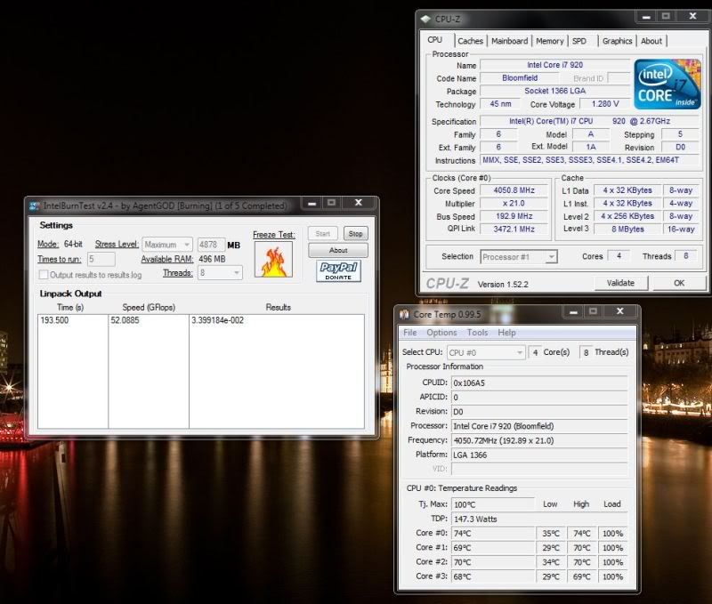

Im trying to get my i7 overclock sorted again, using the latest version of intel burn test (ver 2.4), on the previous version there was a bug with 8 threads selected, so 16 had to be ran. Is it ok to select 8 in this latest build.
Ran ibt firstly on 8 threads selected, failed on the start of the 3rd test, selected 16 threads and let it run for 20 passes, max stress. Completed without errors.

That's the same (low) gflops I'm getting, what's your ram set to? Other people are quoting 52 gflops at 4ghz, Im wondering if running 1200mhz cl9 is why mine is worse.
Hopefully as stable (as can be guaranteed) jon, ill give it my usual p95 small fft and blend runs over the next few days just to be sure.

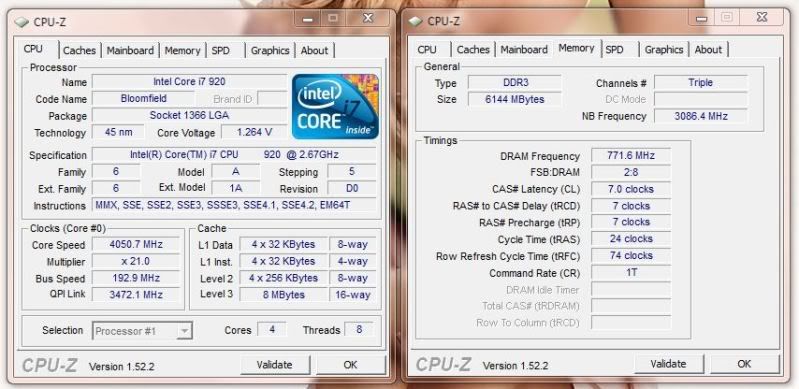

With 8 threads selected i was hitting 52gflops, ram is ocz reaper running 1547mhz 7-7-7-24 1T, 1.64 vdimm.
EDIT: This failed on the second test. 52gflops ver 2.4 i ran a few days ago.

Interesting results setter, cheers for posting them. 1350mhz c7 is a hell of a lot better than my ram so I guess that doesn't explain anything, wonder what else ibt is sensitive to. I like that you're passing testing, considered pushing for 4.2?
Yep, finally passing something, ibt seems to be a bit of a bugfest, ram currently running at 1547mhz 7-7-7-24 1T.
