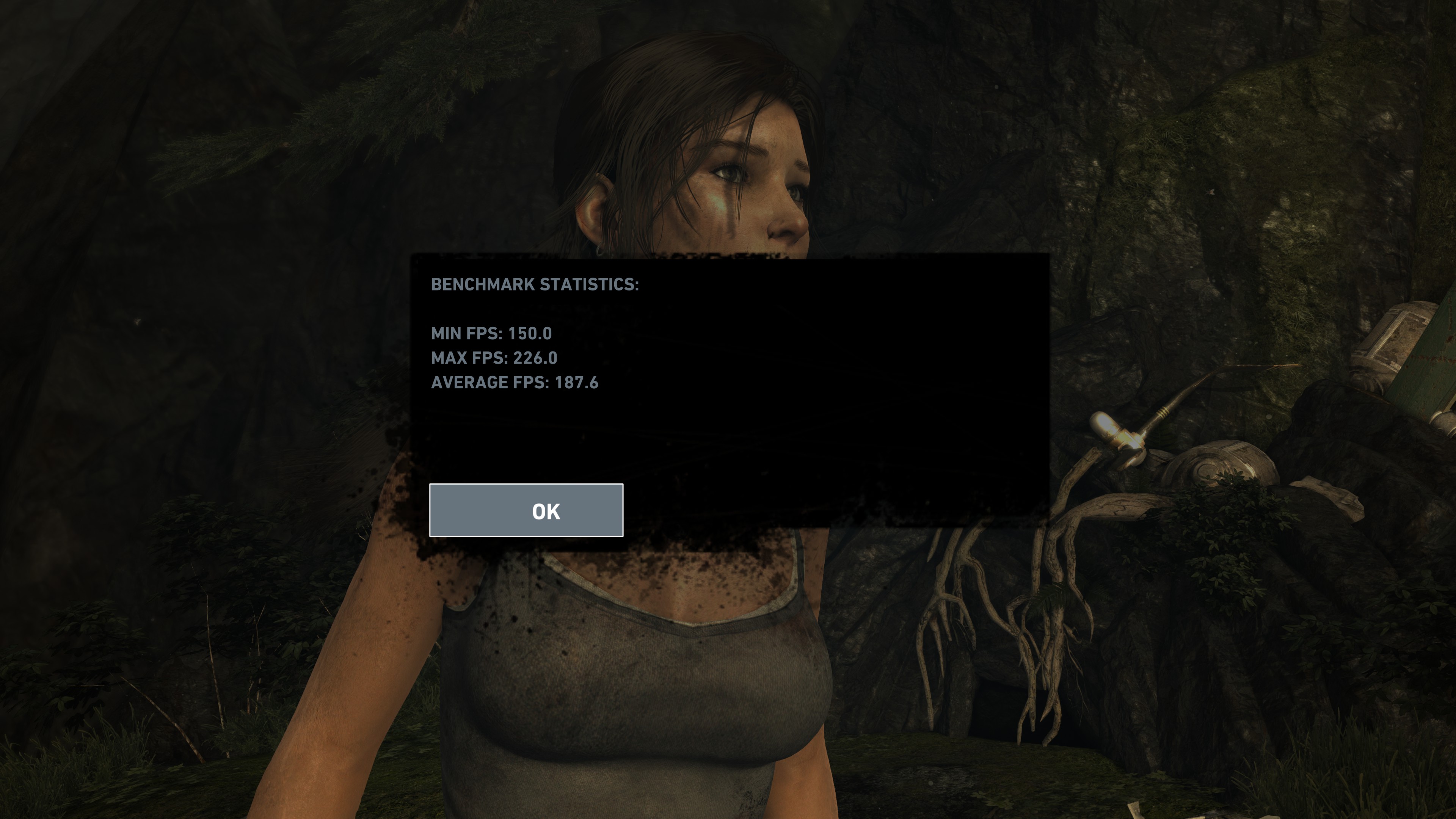

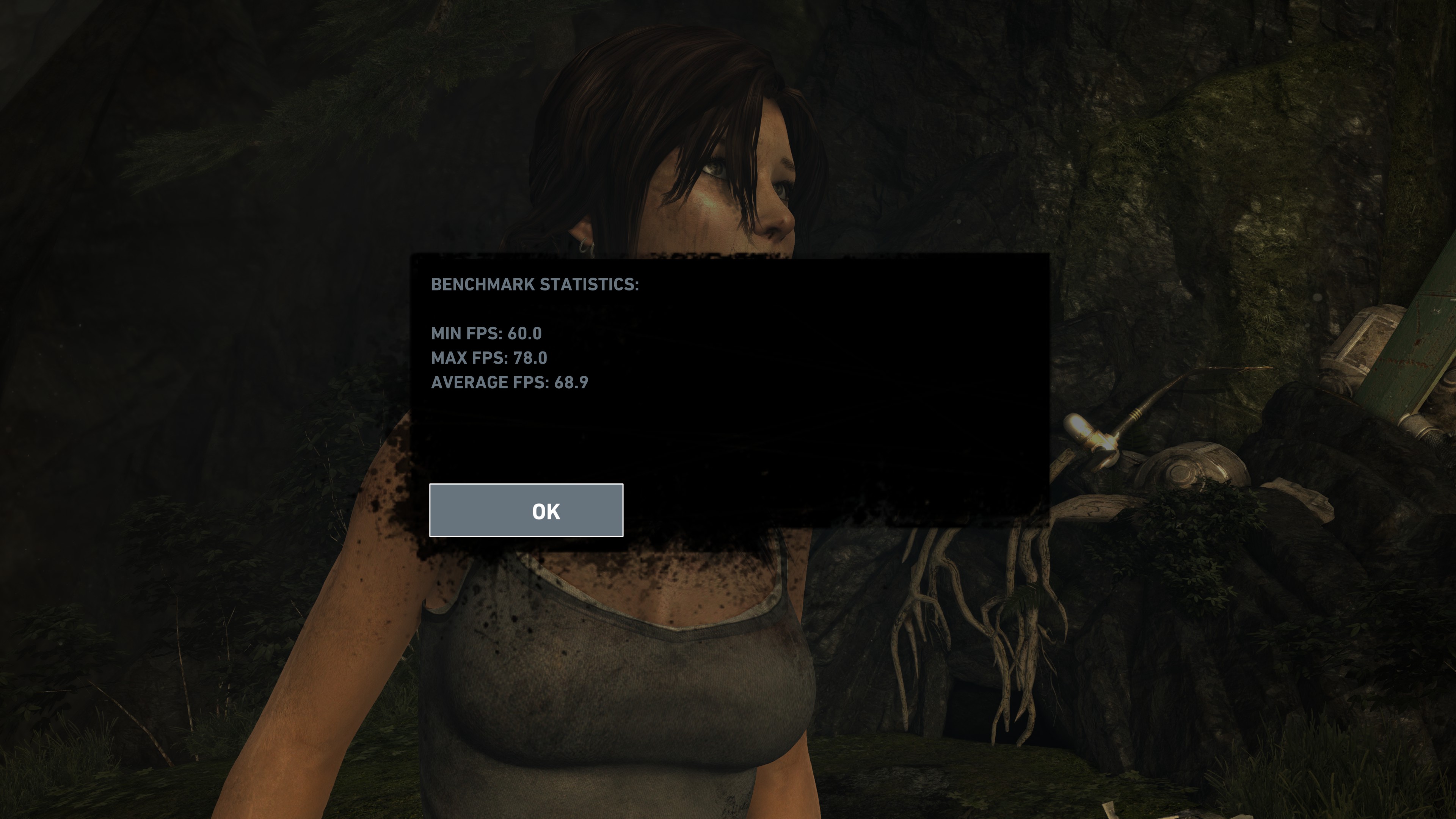

How much performance does TressFX cost?
4K
Off
On
24.22%
GTX980Ti @ 1026 / 1753mhz (boost 1114mhz).
i5 3570K @ 4.1ghz
355.98 driver.
1200p.
Average fps with tressfx on : 128.2.
Average fps with tressfx off : 200.1.
Performance hit : 35.93%.

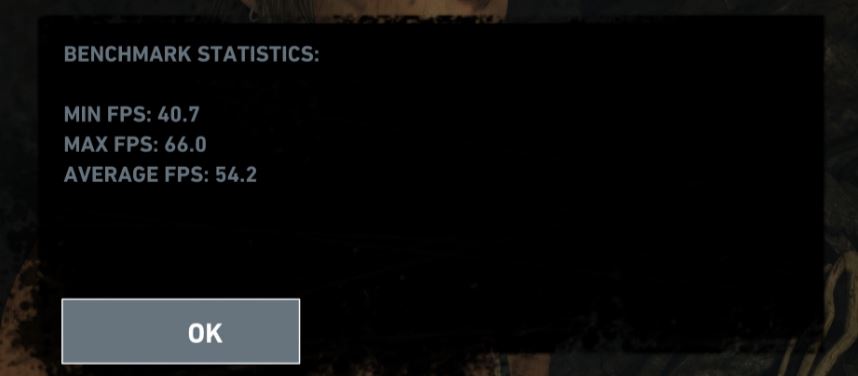

4 TX SC @1316/1752 stock
5960X @4.0
358.87 drivers
2160p
TressFX off
TressFX on
Performance hit 27.23%
@DM as you can see not only are the fps higher @2160p using 4 TXs but the performance hit is still smaller than the 1080p result.
