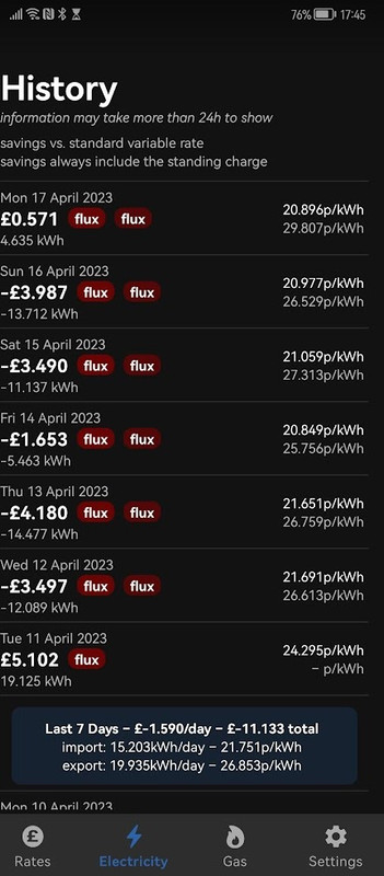

When do you see what you've earned? Is it once per week?
You can use an app, either Octopus Watch or Octopus Aid, then you can usually see the next day.
Tuesday was my first day on Flux export, although it shows in the Octopus App, Octopus Watch doesn't show any export, but I actually exported 19kWh on Tuesday, so usage should be zero, cost will depend on the export/import prices.
Fairly safe to say my bill for the last week is -£16 roughly.
I have 2 account numbers for import and export, so not sure if octopus watch can pull this in together?
Do you have to log into separate accounts, or do they both show in the same web account?
Octopus watch uses the API key, so if its different web accounts it will be different keys.
