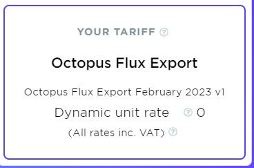

i didnt do anything, but they paid me out my last load of export and it then switched to the flux outgoing.....around 10mins ago
but the export rates are lower than originally stated in the postcode verification on the site.....by a few pence
Are they still higher than the import in the cheap window?
Octopus just told me via Twitter that it can take 6-8 weeks to complete export registration :mad:.
I wasn't registered with them for export, so I guess it could take longer than someone who already was.
yours are a little higher then mine then......i get 22.97 and 36.85. so lets say 23 and 37. its odd that we dont all get the same export rate though
Same as all costs, vary by the DNO pretty much as they all have different underlying infrastructure costs.
