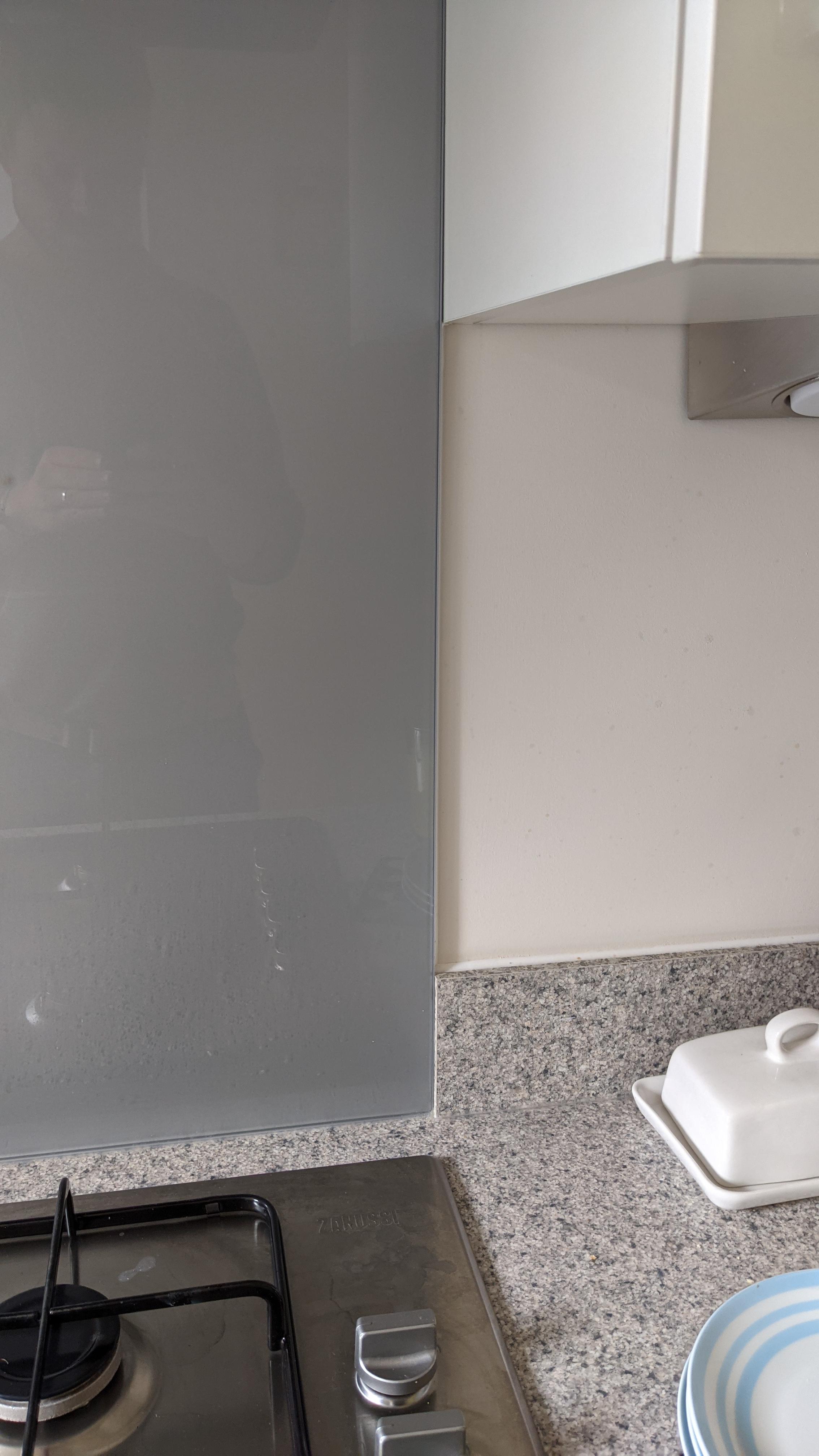

How to remove this trim before tiling kitchen?
Can't see the hood you've got but sole the bottom folds off for cleaning the filters or whatever, can you look in there?
Some have suggested why not just tile above the upstands but think it would look best tiling from the work top up?
And then if I did it from the upstands, there would be a gap at the bottom of the current spalshbacks where it would be tiled to the worktop for just that section.

Yeah if you go from the upstands I'd change the splash back
This is ours for instance
Isn't the trim on top of the upstands just silicone? I'd leave upstands there and use a tile trim edge up against it, especially if the tiles are not flat fronted. If the tiles have a smooth flat front surface then you can just put silicone along the edge between the tiles and splash back, finish it off then with a fugi tool to get a very crisp firm straight bead.

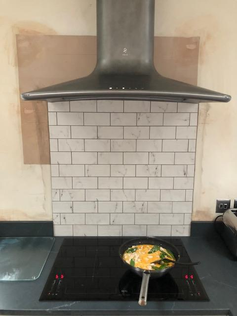

Obviously not sure what tiles etc you're going for, but we have upstands matching the worktop and then tiles as the splashback for the hob right down to worktop height. It's not exactly the same as we don't have tiles elsewhere as you plan to, but here's a pic from when ours were fitted

Splash back, easier to finish off at the bottom against the countertop with a fugi tool finished line of silicone bead. However, not as neat on the vertical sides as you see the sides of the tiles.
Tiled, neater across the horizontal plane due to continuation into rest of tiling. Harder to get a neat edge along the bottom so I would use clear silicone there as you won't be able to use a fugi tool against the angled edge of those brick tiles.
