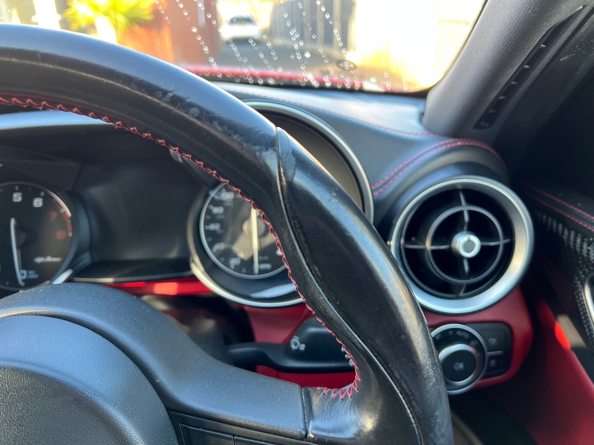

Some pictures of the 113k worn shiny wheel:

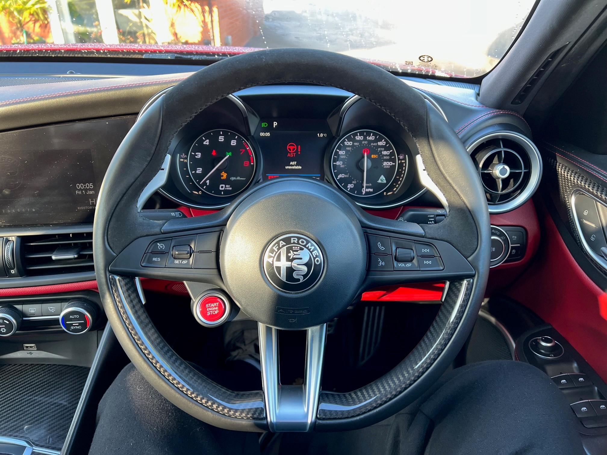

The results:
This is the optional wheel to the added carbon fibre inserts and suede which all nicely matches the interior, this wheel came from an 8000 mile car so is very fresh, cost me £210 delivered. :)
Also helps on these cold frosty starts, suede is not as a cold to hold as leather.
Very happy with the results, upon reconnecting the battery turn the wheel lock to lock five times and key cycle the car to clear all the error codes from battery disconnect. :)

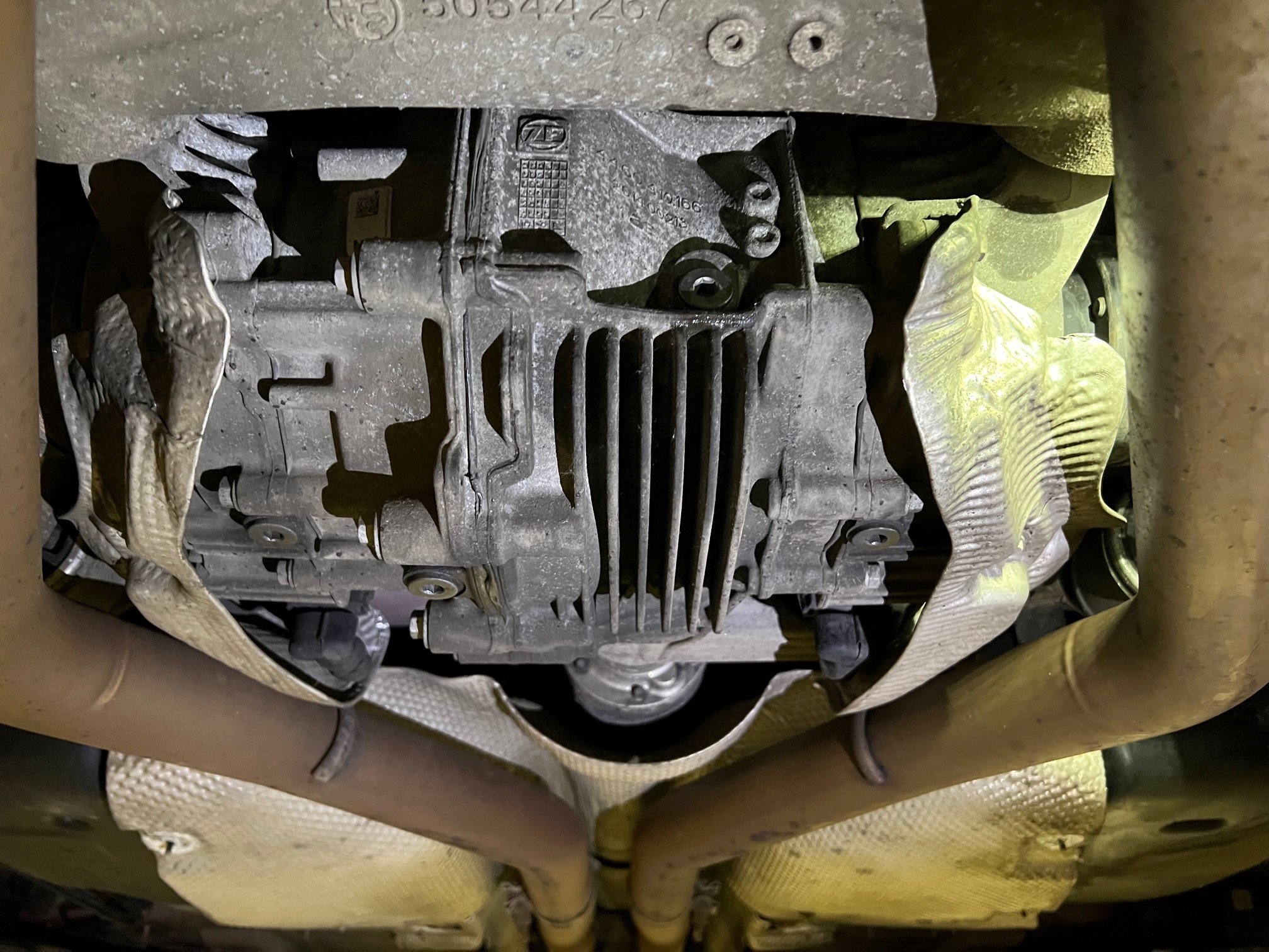

So in the end I had to give up trying to do diff oil myself, the under trays would not come off (clips just spinning on opposite side) as such I decided to let Andy at AWJ sort it as he was going to do the gearbox anyway for me and alignment.
As such dropped it off with him yesterday morning:
He removed the under trays (had to snap a few clips, but he has replacement ones), gearbox cover/filter off, all THREE diff plugs removed and oil left draining over night:
All drain plugs refitted and new gearbox service kit fitted:
Andy has the ZF8 software so was able to do a cold fill, then bring gearbox upto target temperature to do the warm fill.
Andy was also able to reset the differential adaptations so the car is aware it now has new oil.
The gearbox oil which came out of the car was not that bad.
The OS and Centre diff oil was clean, the NS was dirty.
As such they either have been done in the past though its not documented anywhere or part of the servicing requirements by Alfa, though ZF who make the gearbox recommend an oil change every 45,000 miles and the rumour is the differential oil should ideally be changed every 36,000 miles with it been a more complex E-Diff with torque vectoring (hence 3 drain plugs).

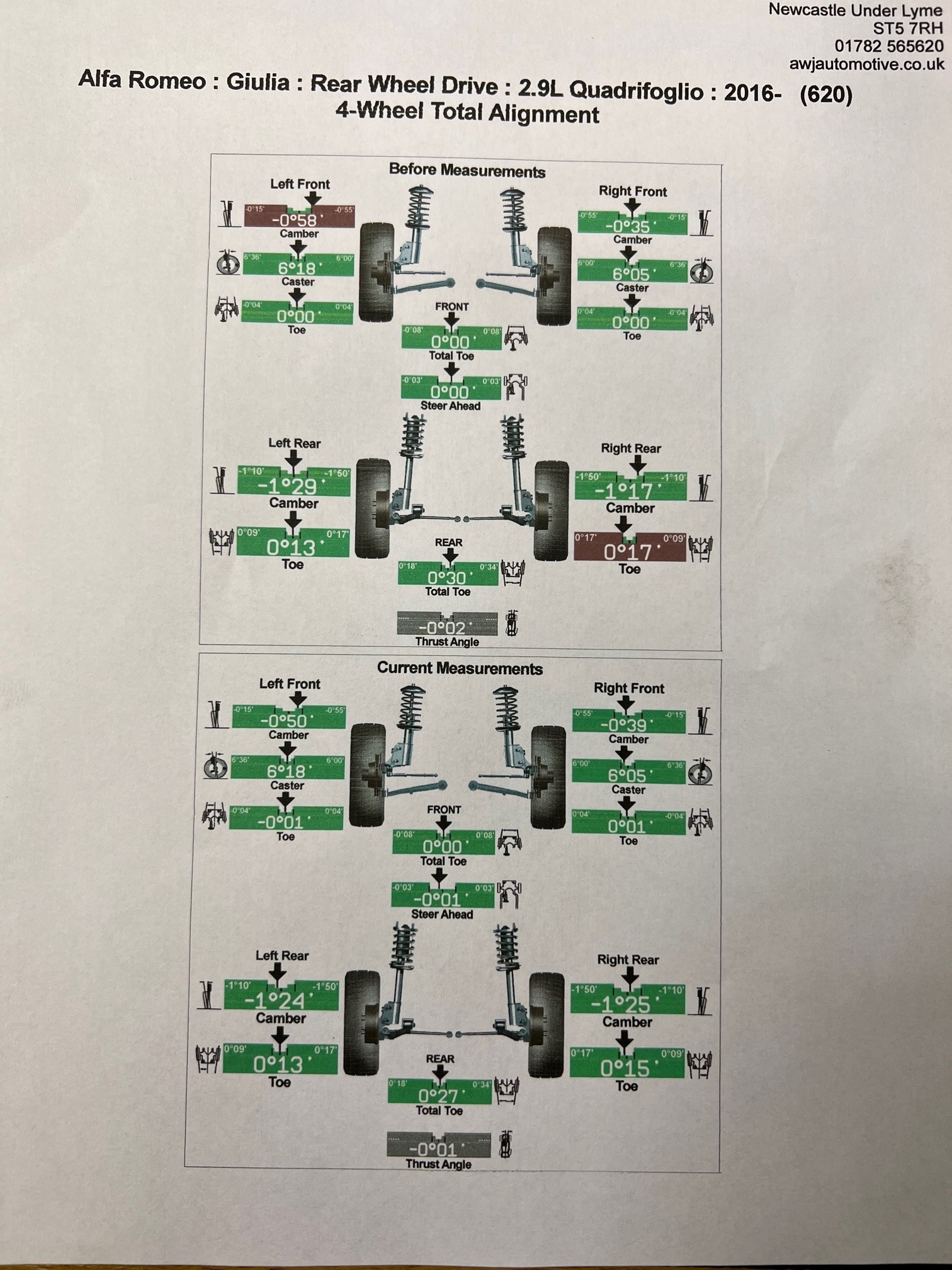

Alignment also done, though car was not that out:
