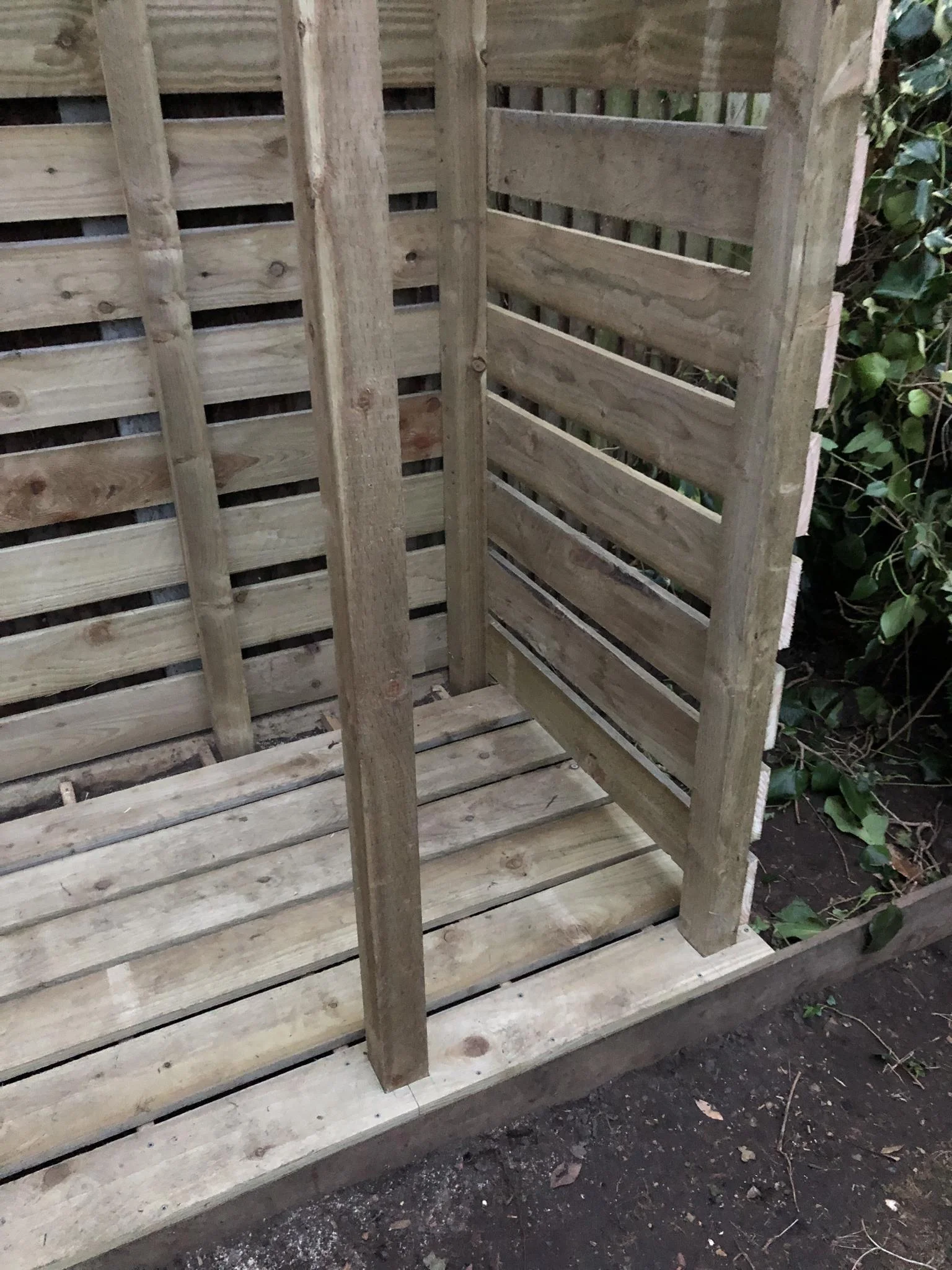

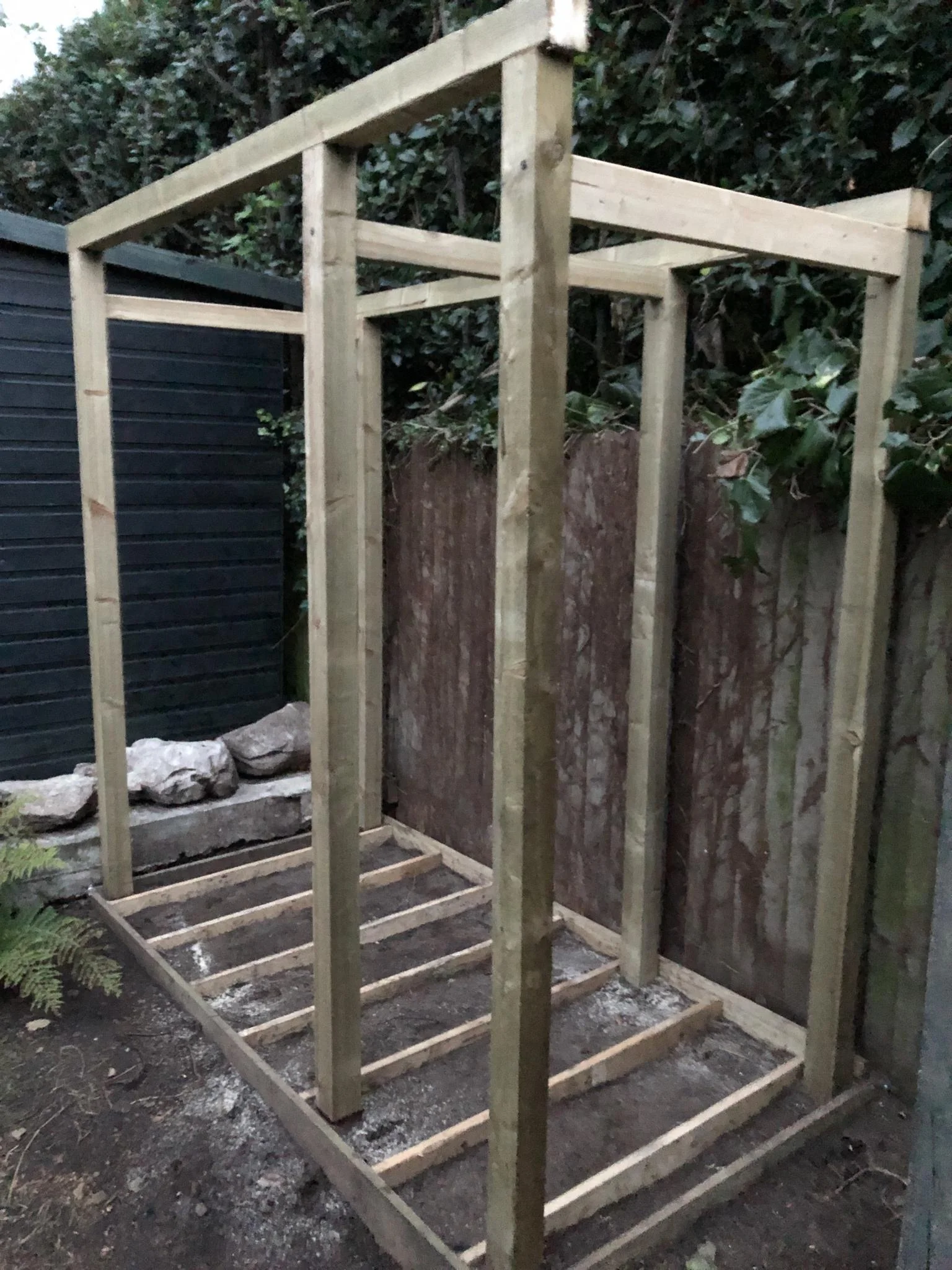

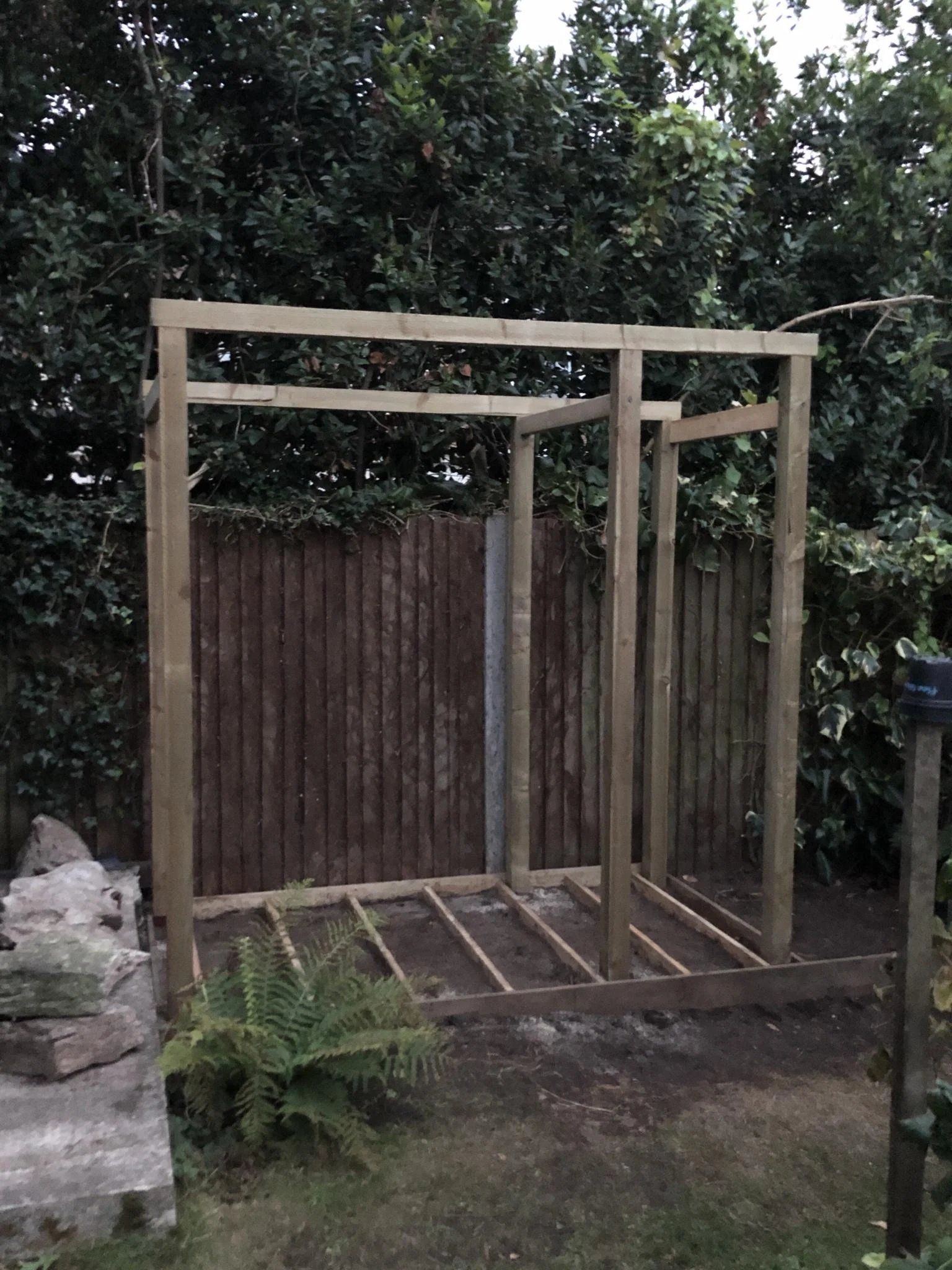

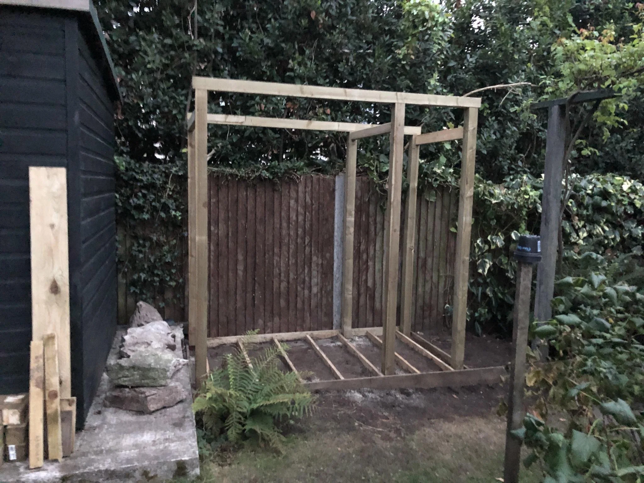

Took on a project the last couple of weeks which was supposed to be pretty basic, just popping some posts in the ground and some plywood on top, but after googling custom log stores I had to put in a bit more effort.

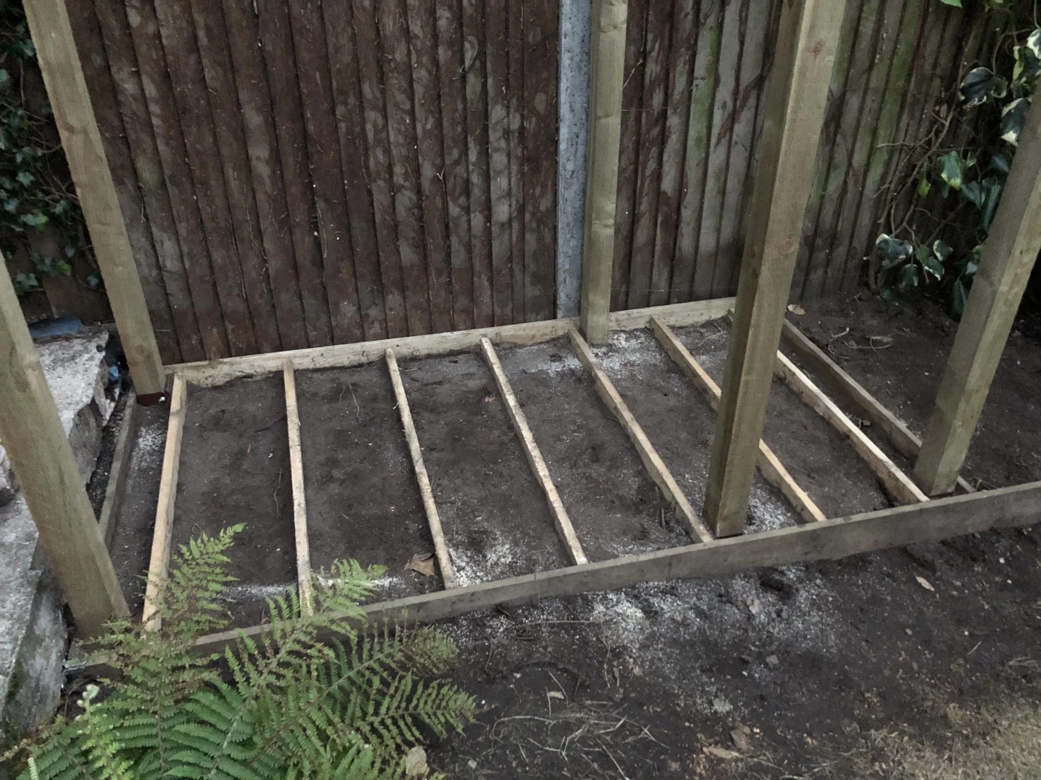

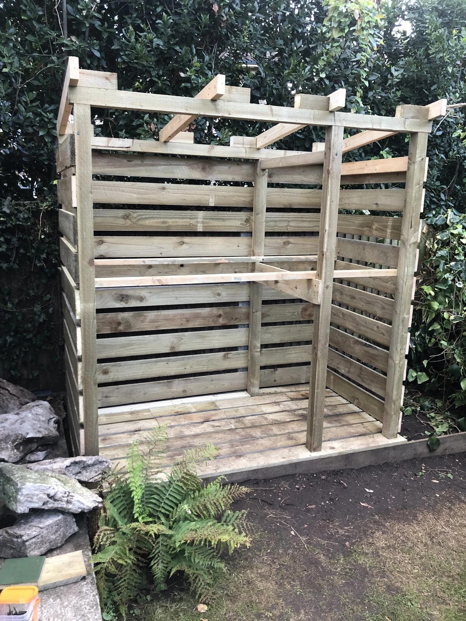

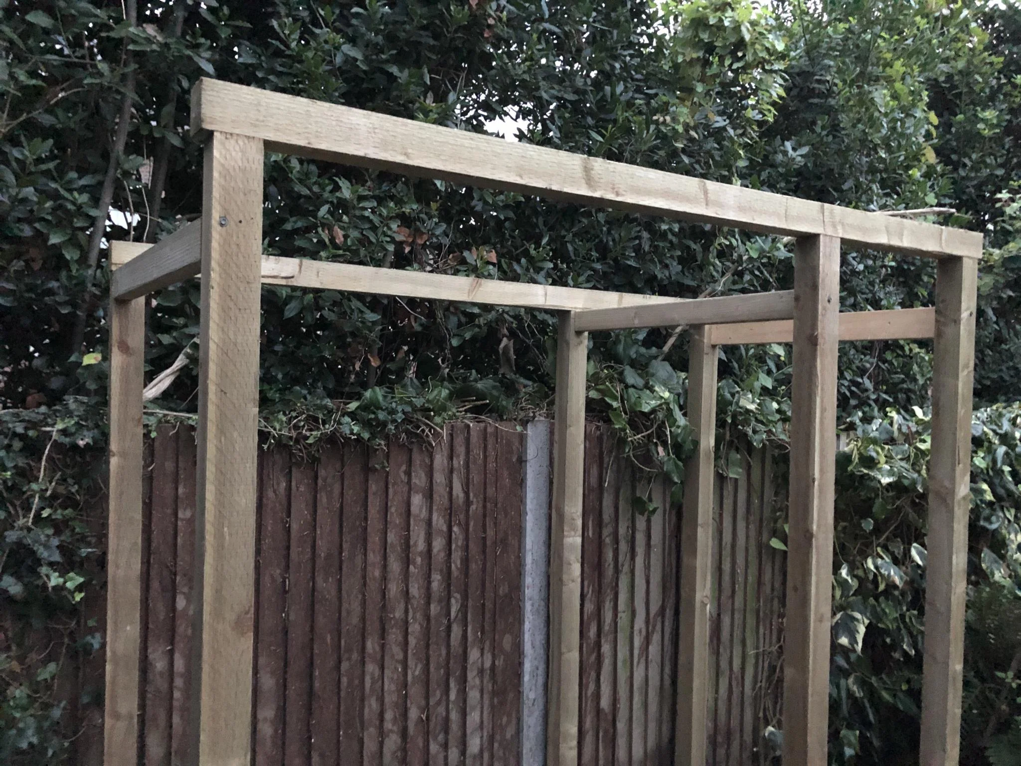

The frame was made using 3"x3" fence posts, secured to the ground using metpost spikes, hammered into the ground.

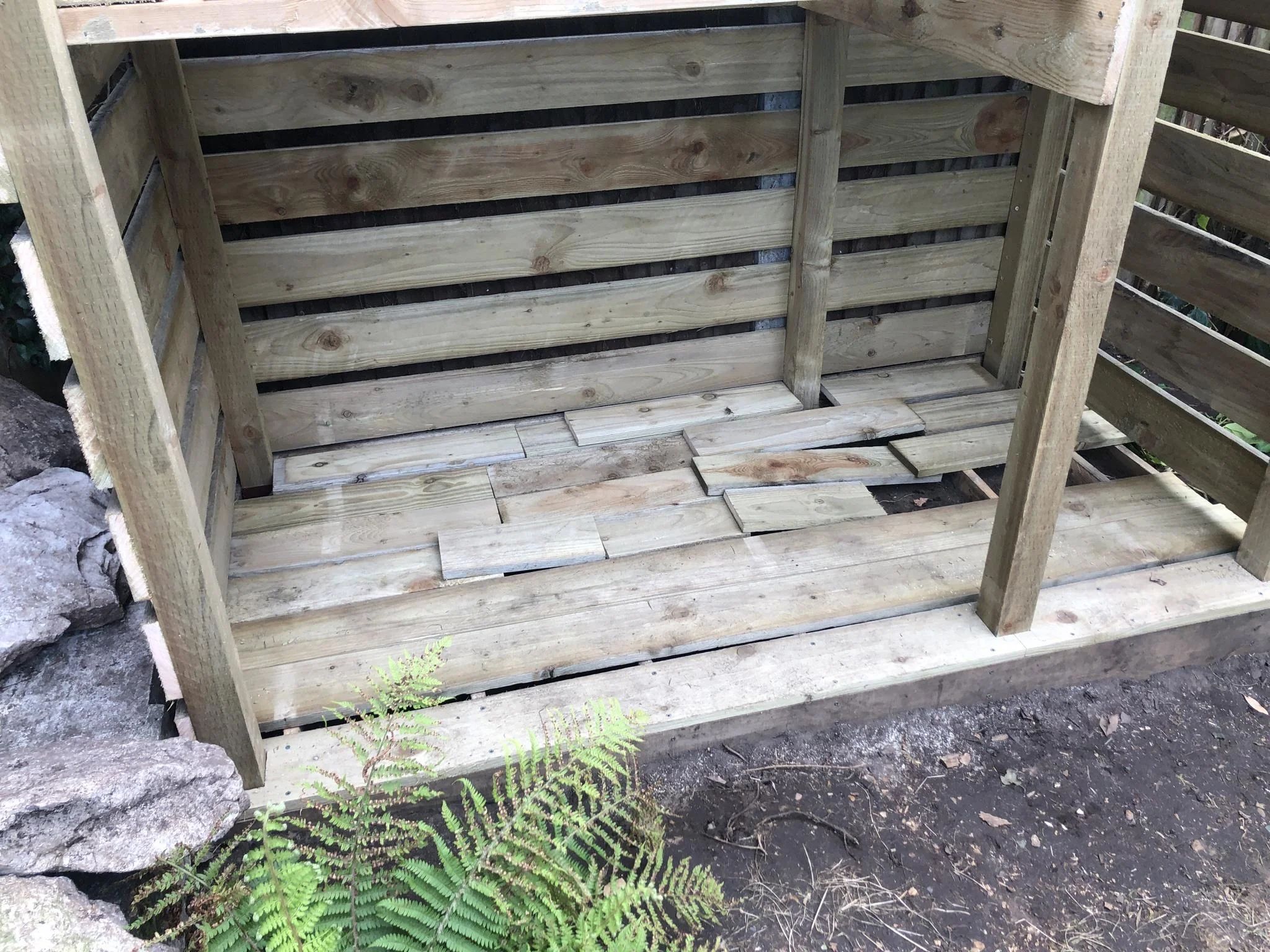

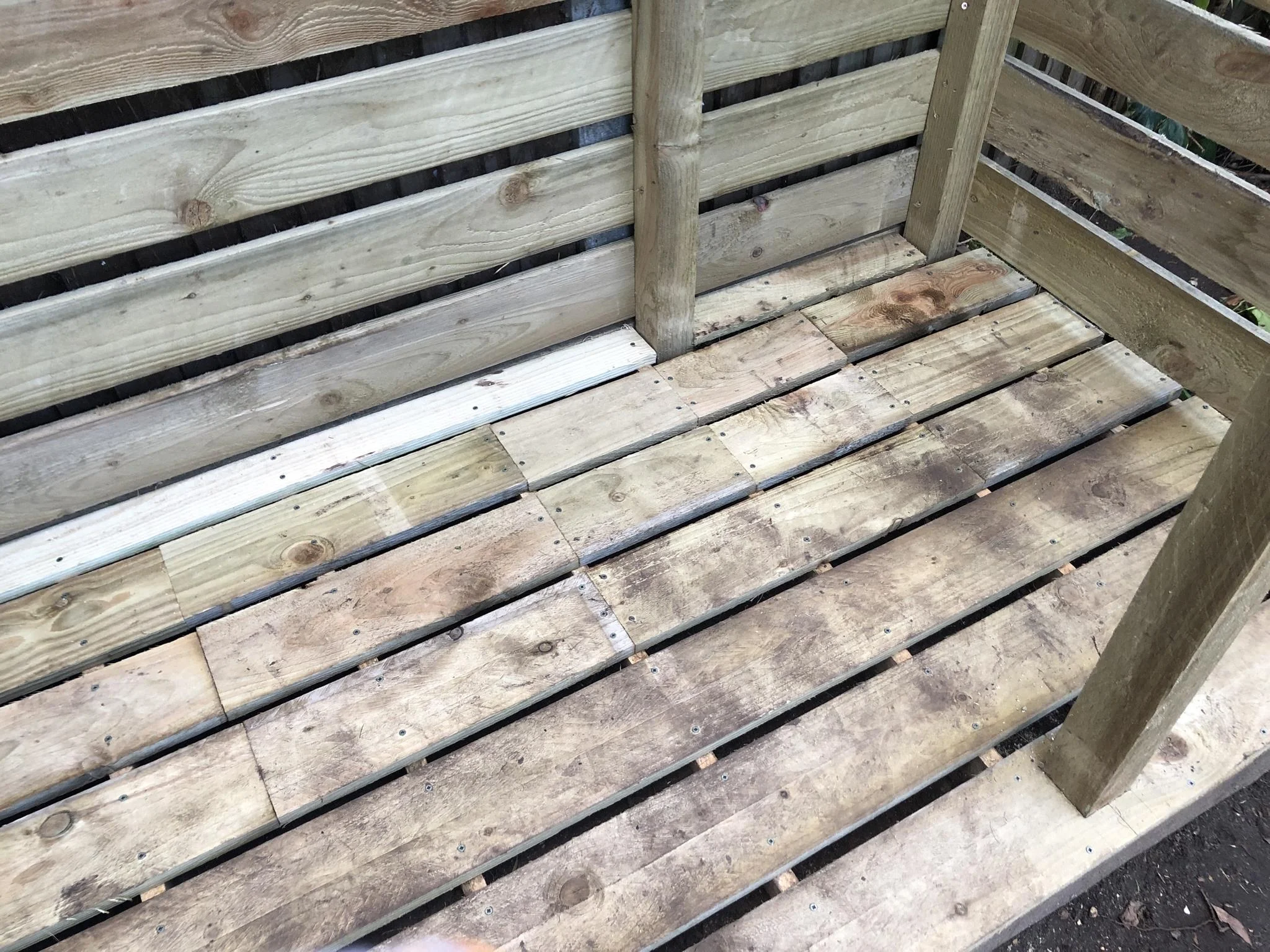

The base for the floor was taken from a broken down pallet

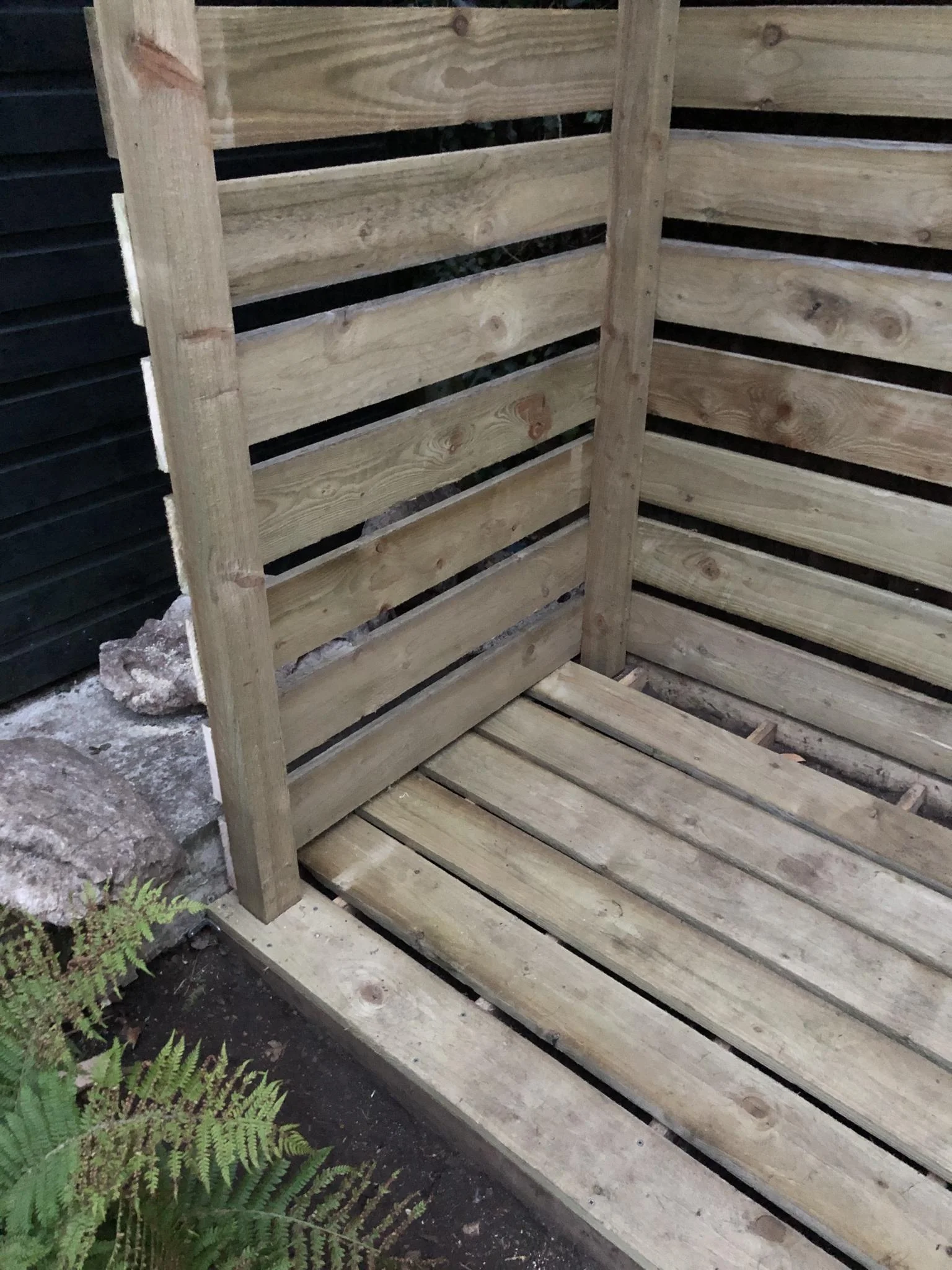

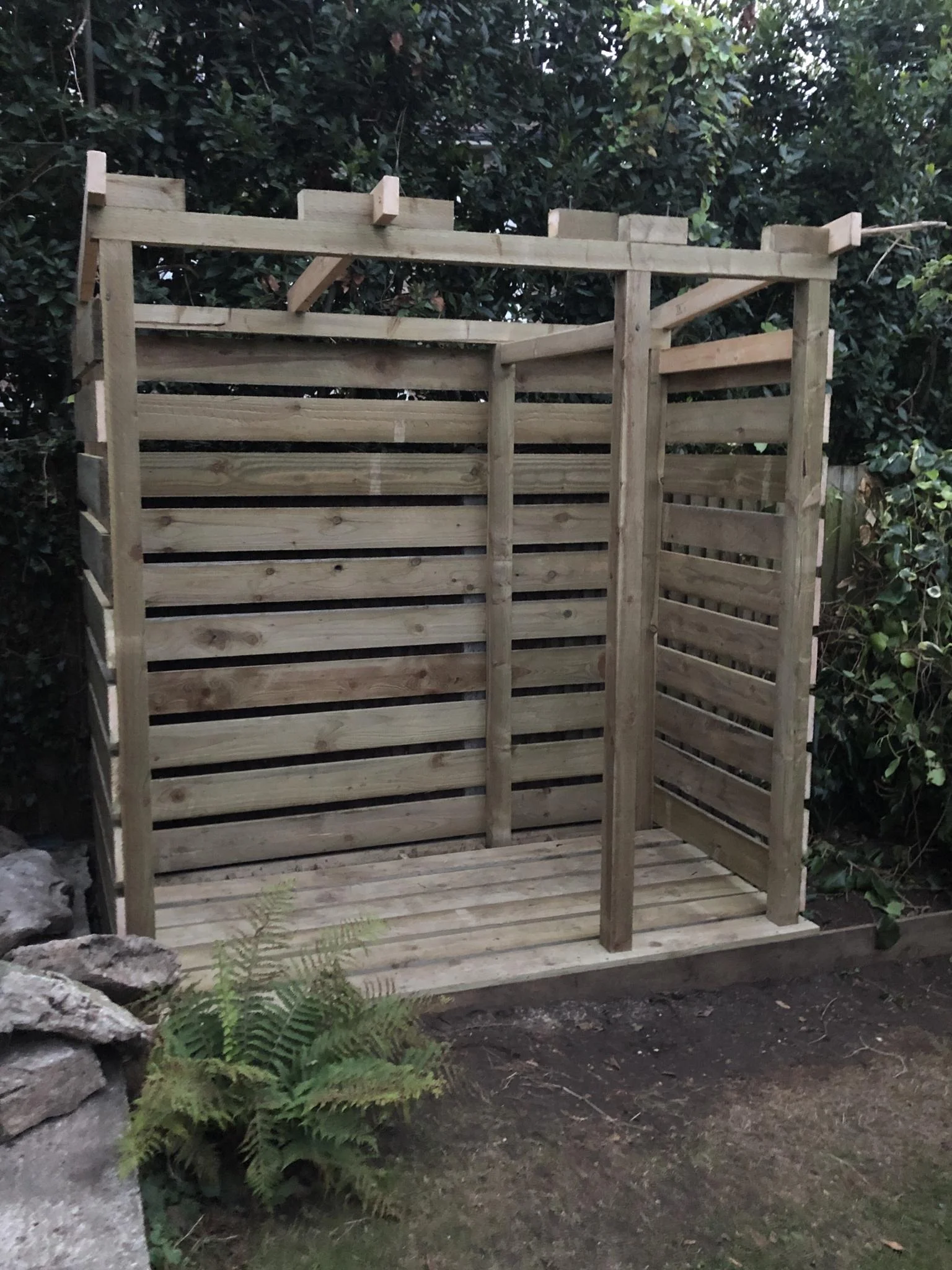

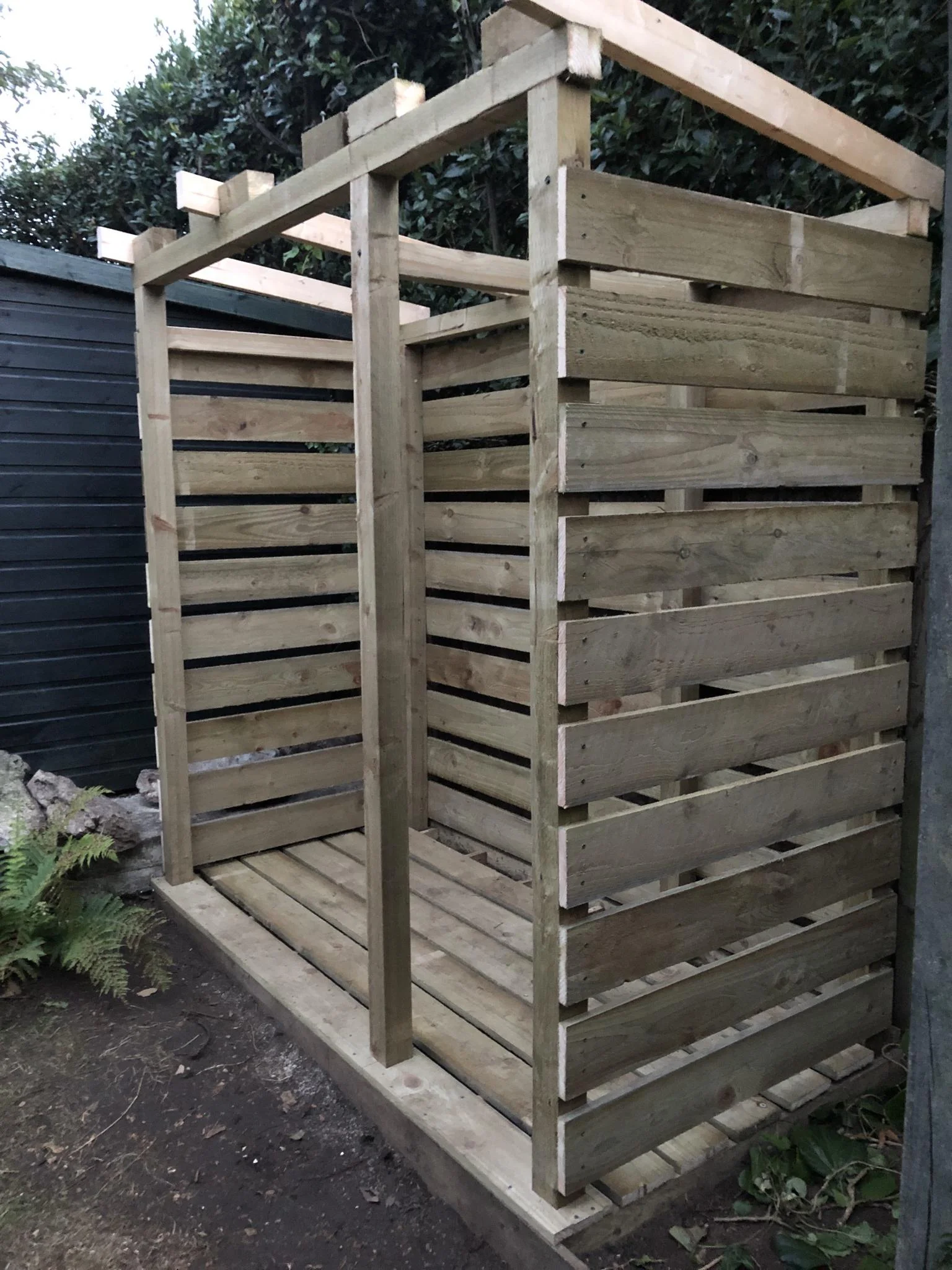

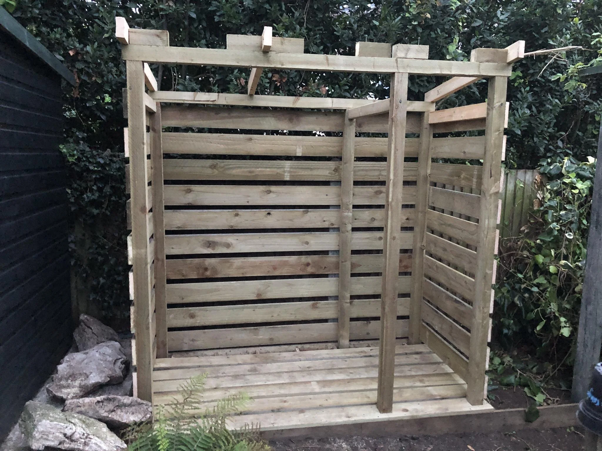

The front base board, floor, and siding were all 6"x1" boards. Cheapest I could find was Selco.
Didn't order quite enough on the first order, so had to take a trip in person with a hand saw to cut down a couple of extra 4.8m lengths to get enough to finish and be able to fit them in the car.

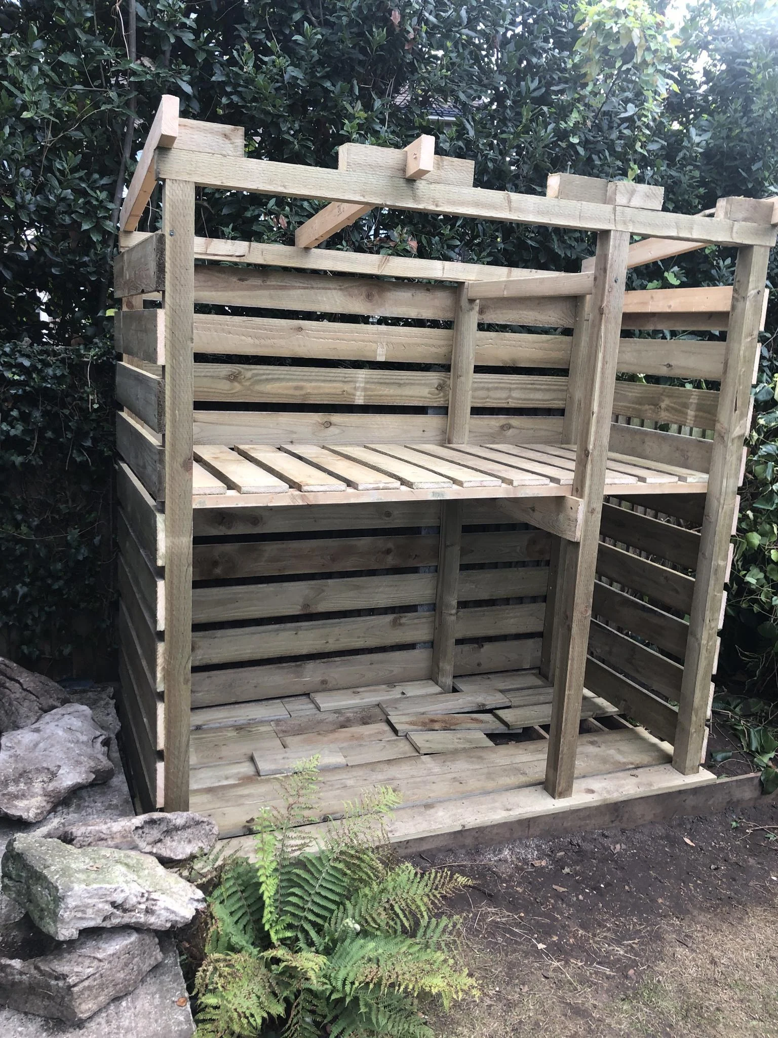

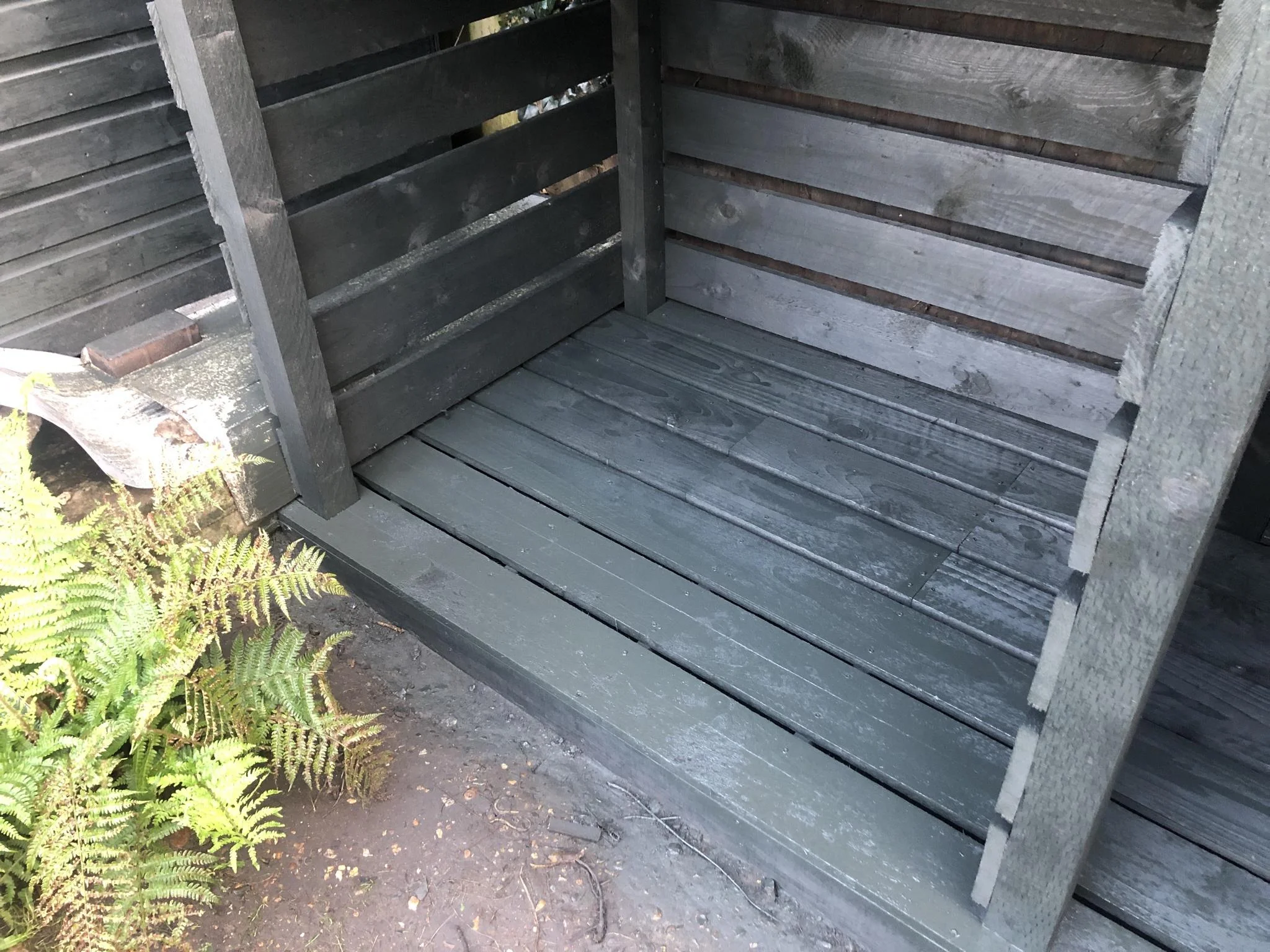

Laying out as many off cuts as possible to use up on the flloor to minimise wastage
Floor all secured:

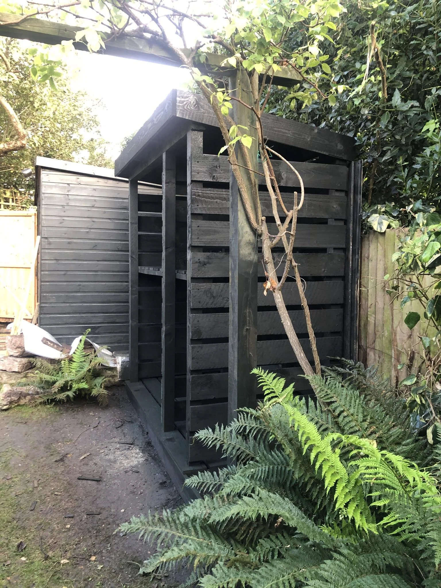

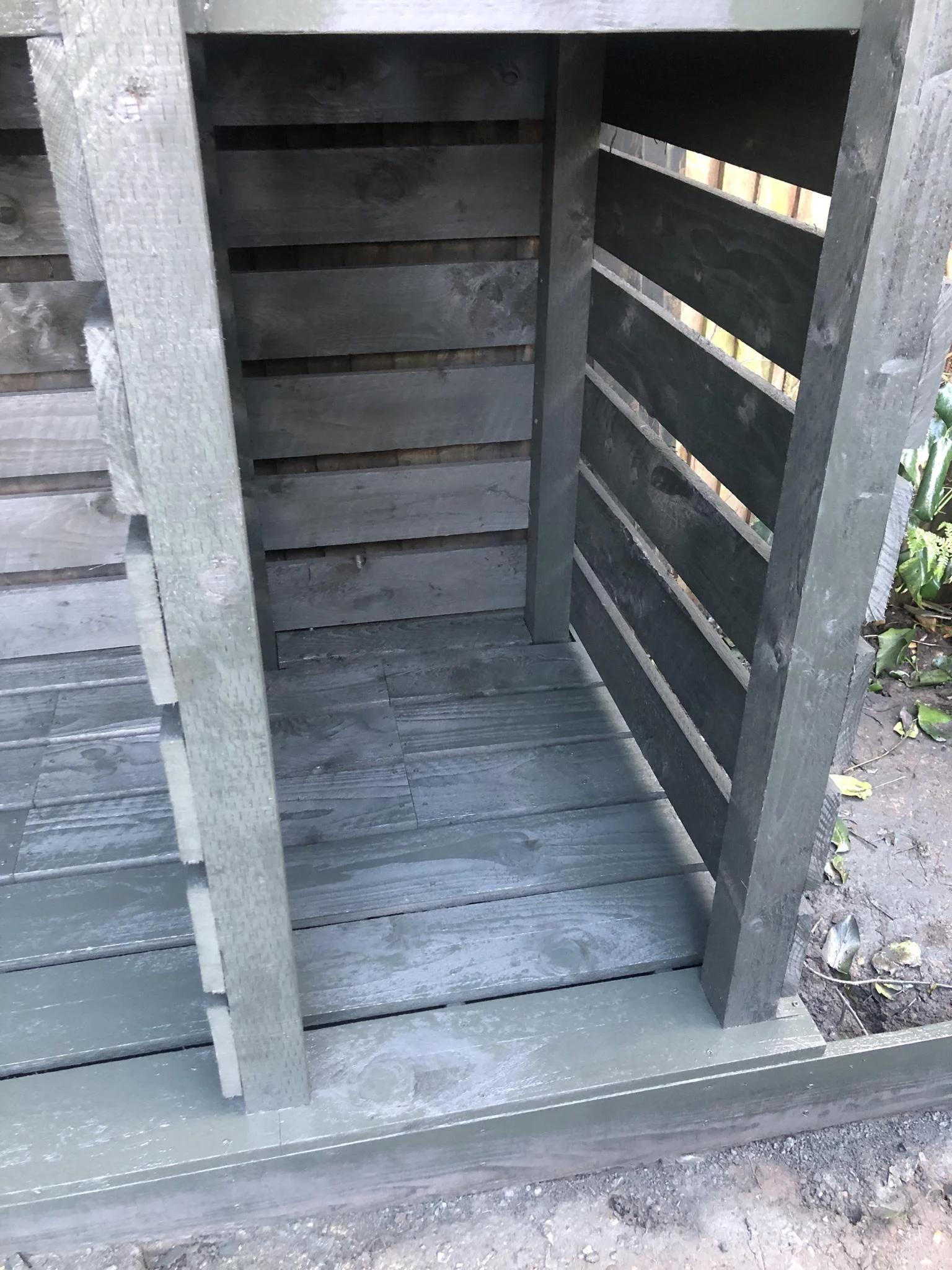

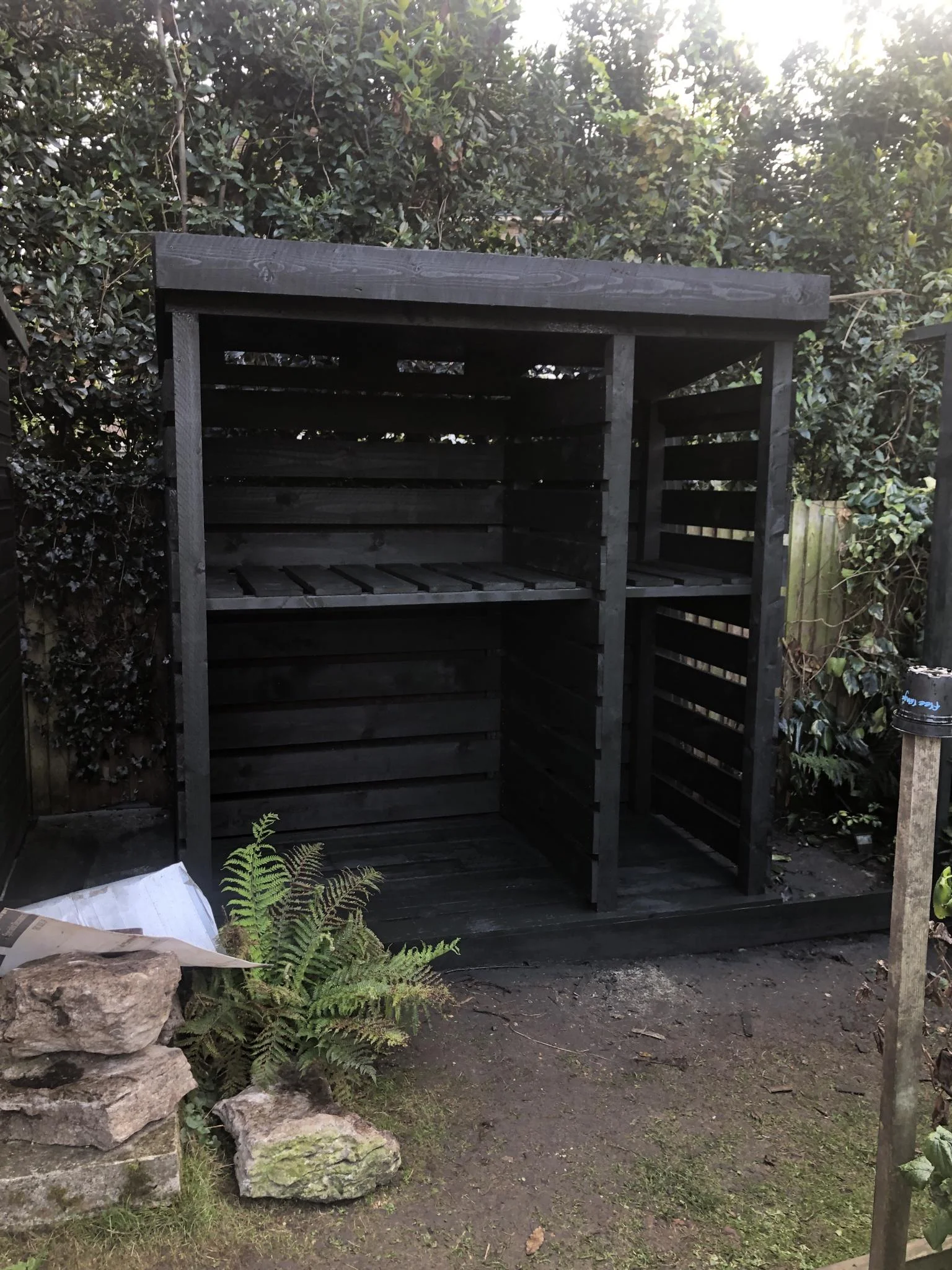

Needed to try and match the paint to the existing shed, which had a dark green shed paint from 15 years ago that was no longer made by the company.
In fact, dark green in general was pretty much impossible to find for outdoor fence and shed paints in my research.
I ended up getting Cuprinol Ducksback Black shed paint and their normal Woodland Green less mess fence care paint.
I mixed them at a ratio of:
Black : Woodland Green : Water
1: 2 : 0.5
Mixed, with a drill mixer attachment in a bucket and poured into a Wagner W100 Paint Sprayer

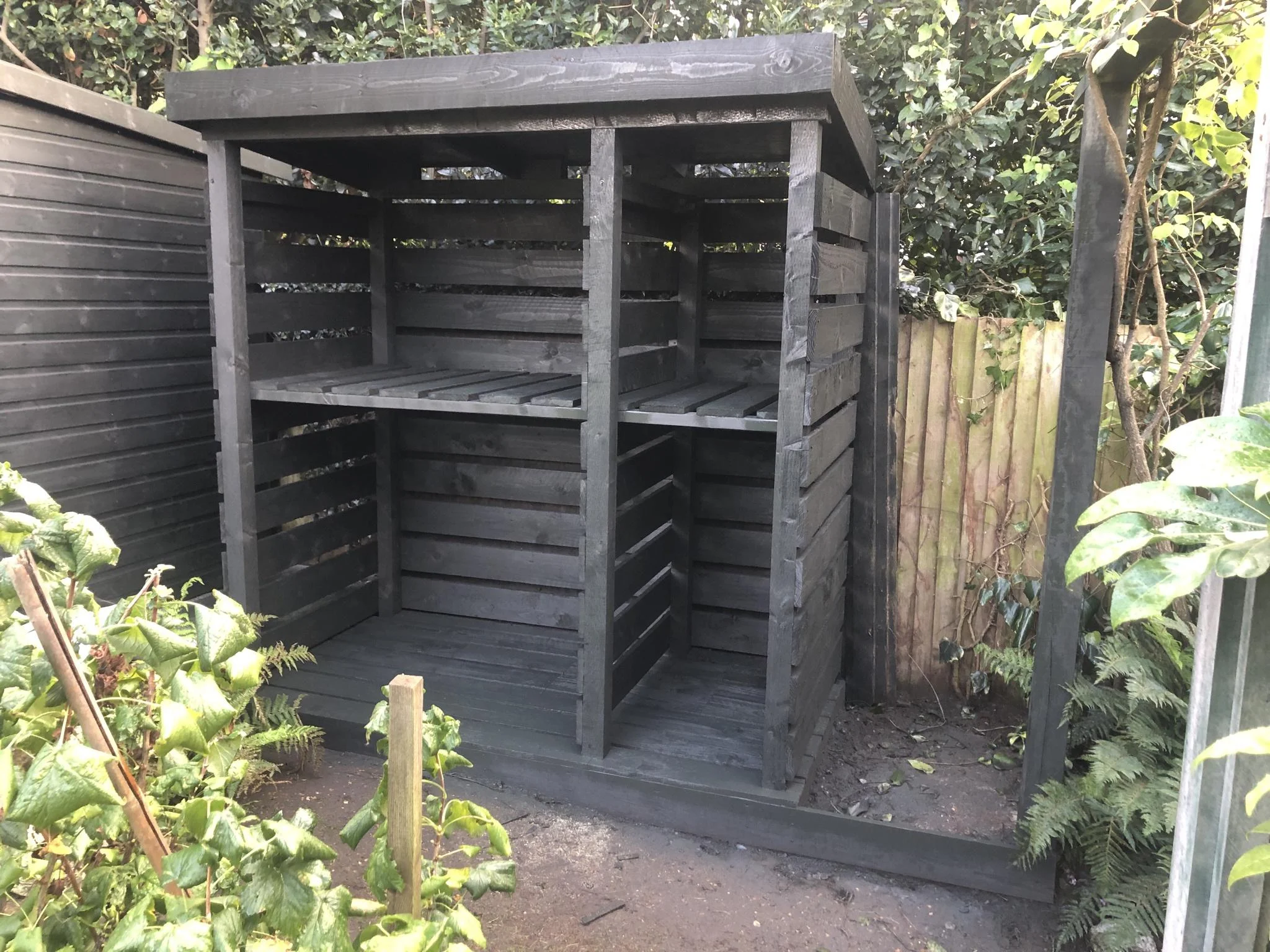

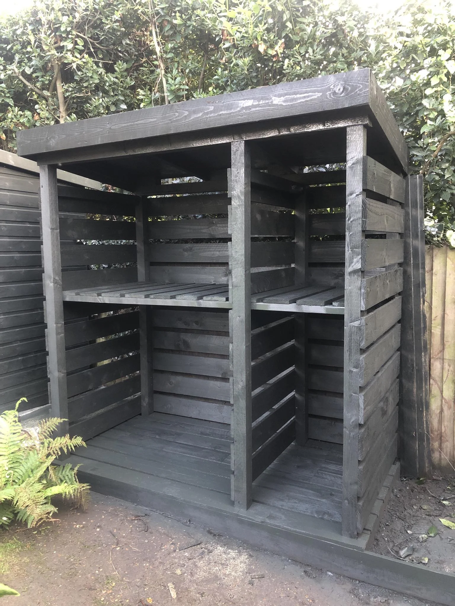

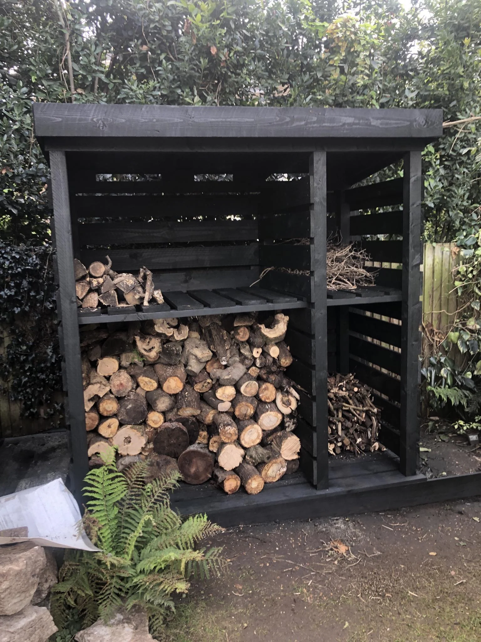

The roof is an old piece of plywood from some previous work, with some new green felt tacked on to waterproof it.

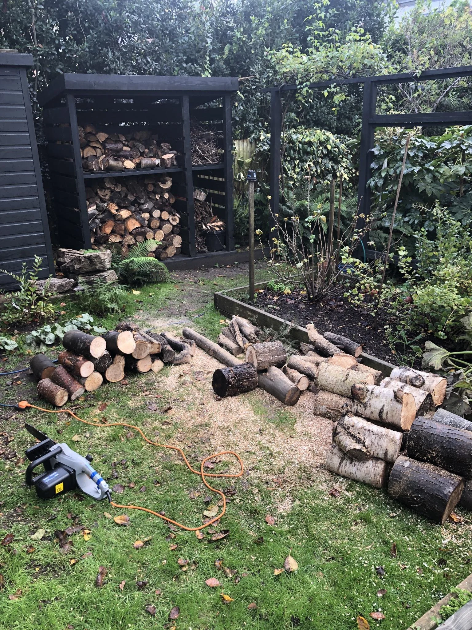

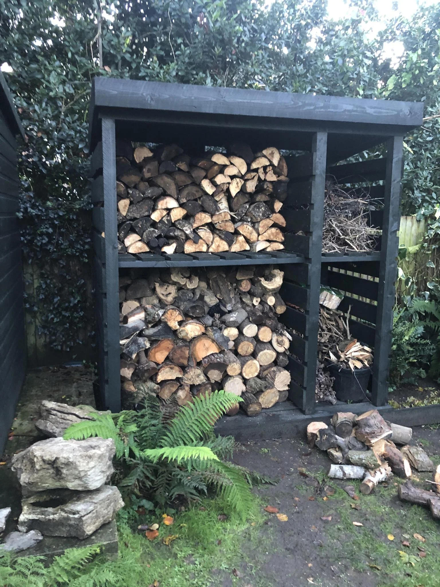

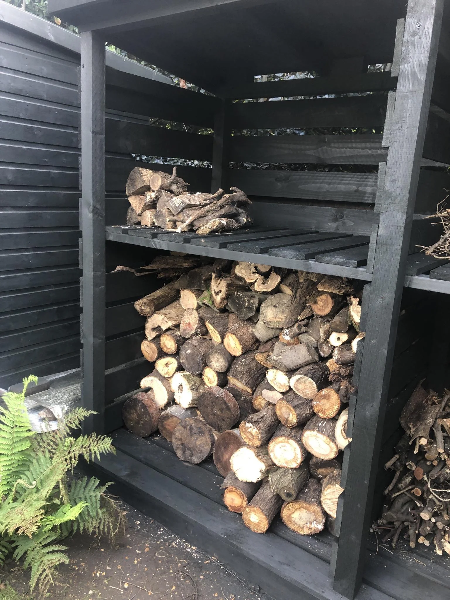

With a few logs added!

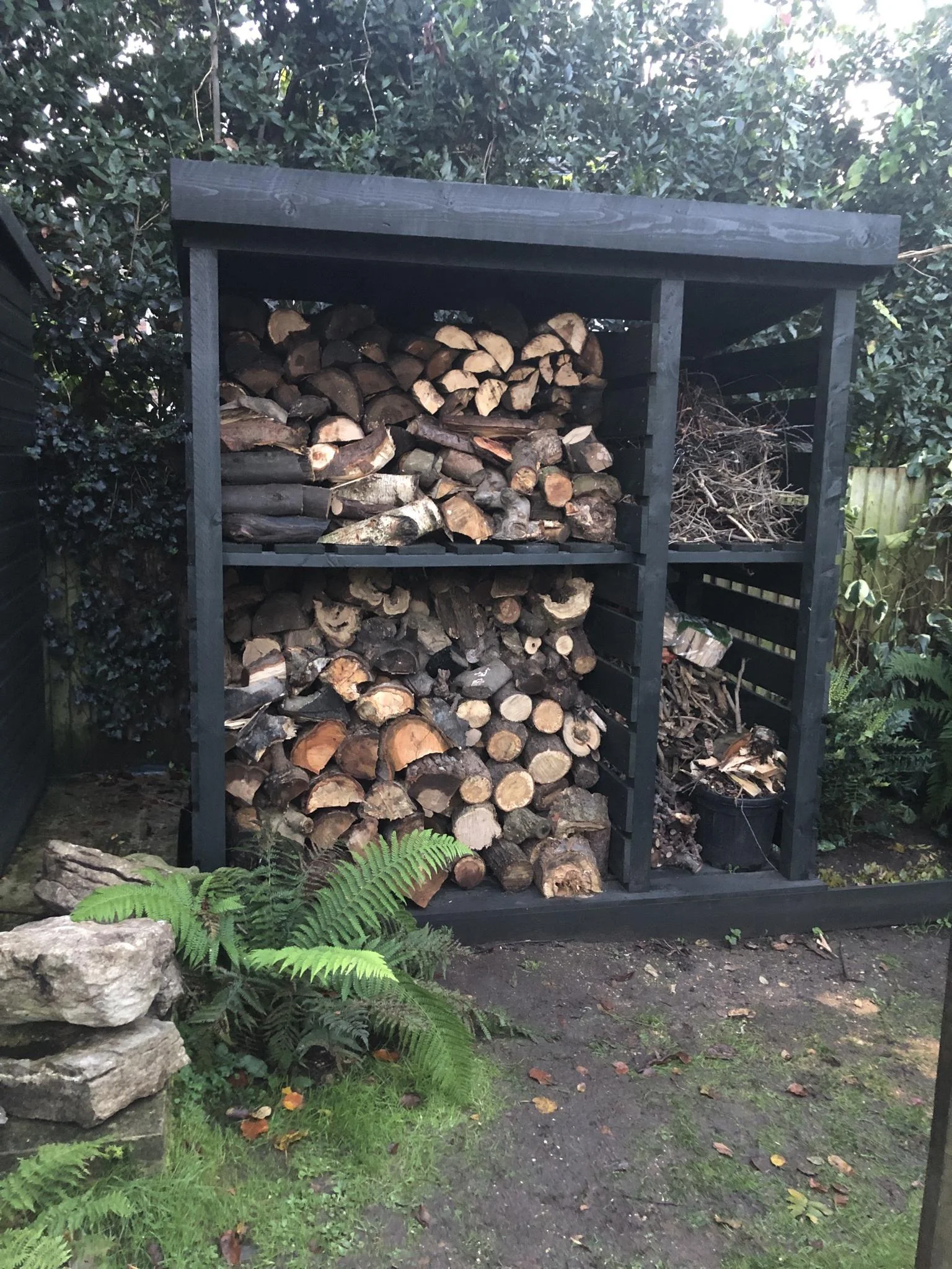

Update:

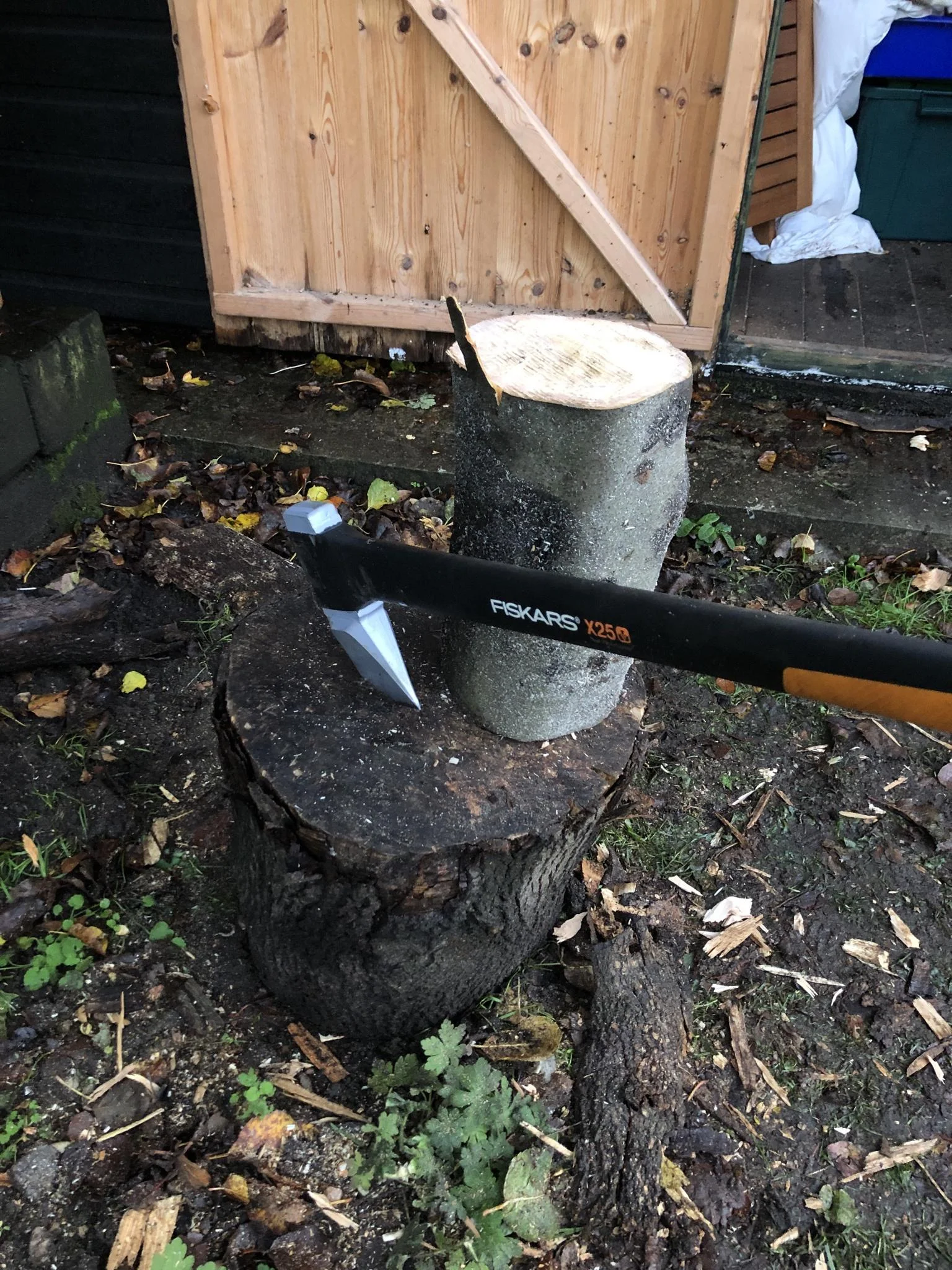

Got a chainsaw and splitting axe to start properly breaking all the wood down
You need a lot more logs yet.
The leasons you learnt from SAS on how many picture to post certainly worked :cry:
They were previously just piled up on the ground without any cover after my landlord found a log hookup and just took a bunch home! So now we have more space we'll definitely be after some more to get seasoning!
@UberTiger educate me on logs. Don't they need to be dry? And outside isn't dry?

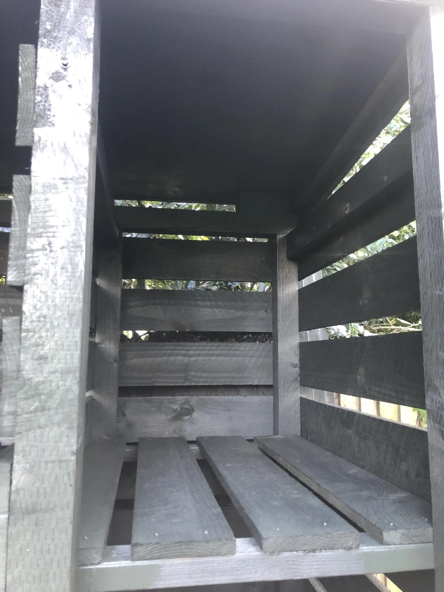

Hi mate, they do indeed need to be dry, hence the use of a covered log store as opposed to leaving them just piled up and completely exposed to the elements.
The gaps in the walls and floor allow strong airflow to aid the drying out of the logs and reduce moisture build up in a confined space.
The roof is solid and water tight. Sure, they're not completely boxed in, but the edges that may get a bit wet dry out very quickly and easily and the core bulk of the logs always remain dry.
Usually you'd also have a small store indoors that gets replenished, and by the time the outdoor logs from the store sit inside for a bit they're in great shape to burn.

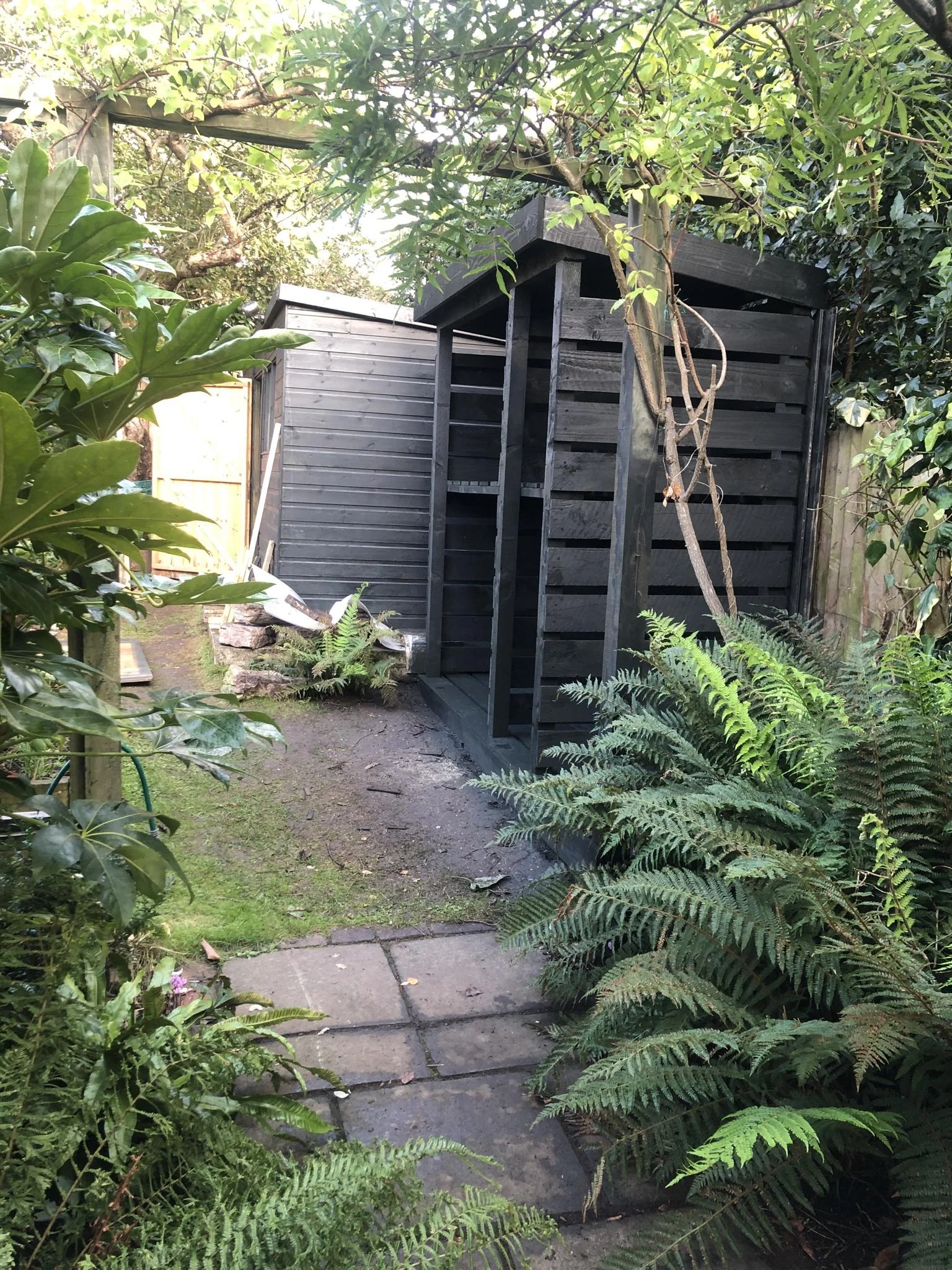

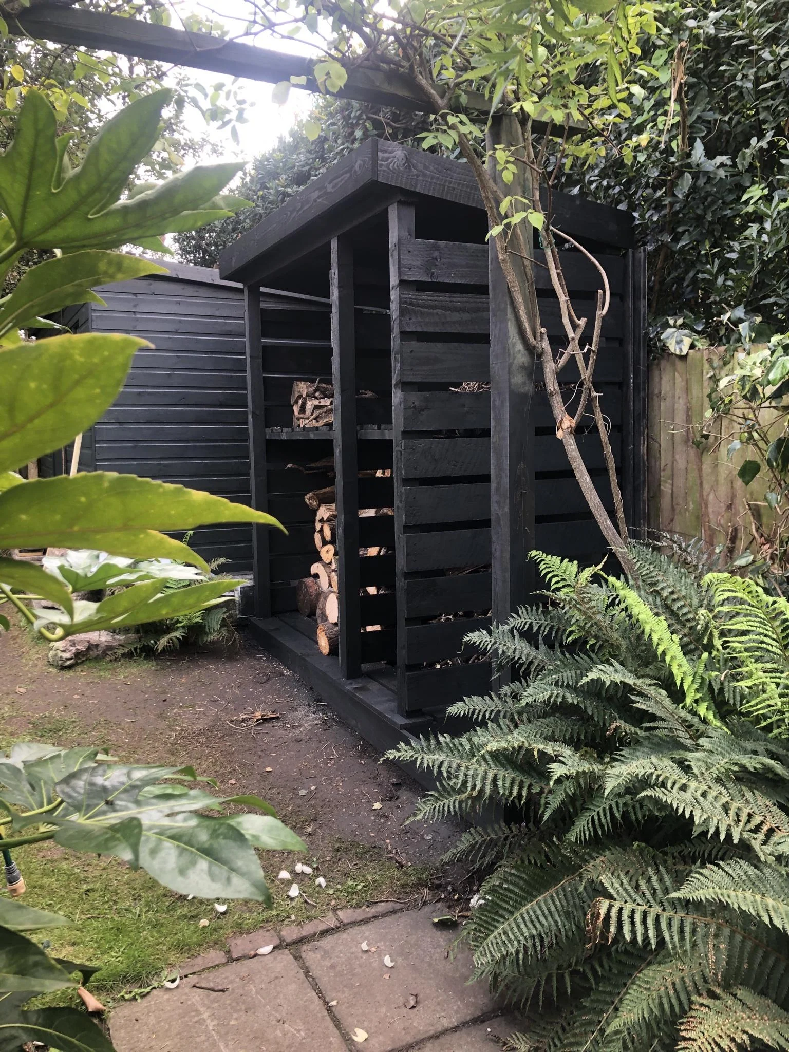

Top man. I'm a city boy but our house lends itself to having an "inside log store" in our porch (1930s semi), and the garden is big enough for a proper external one, and the shed is setup for breaking logs. Actually the log burner in the living room is (sadly) still prepped from the last time the previous (now deceased) owner set it up.
Blends real nice into the garden, top job.

It's not the size of the log store that matters, it's what you do with it :p

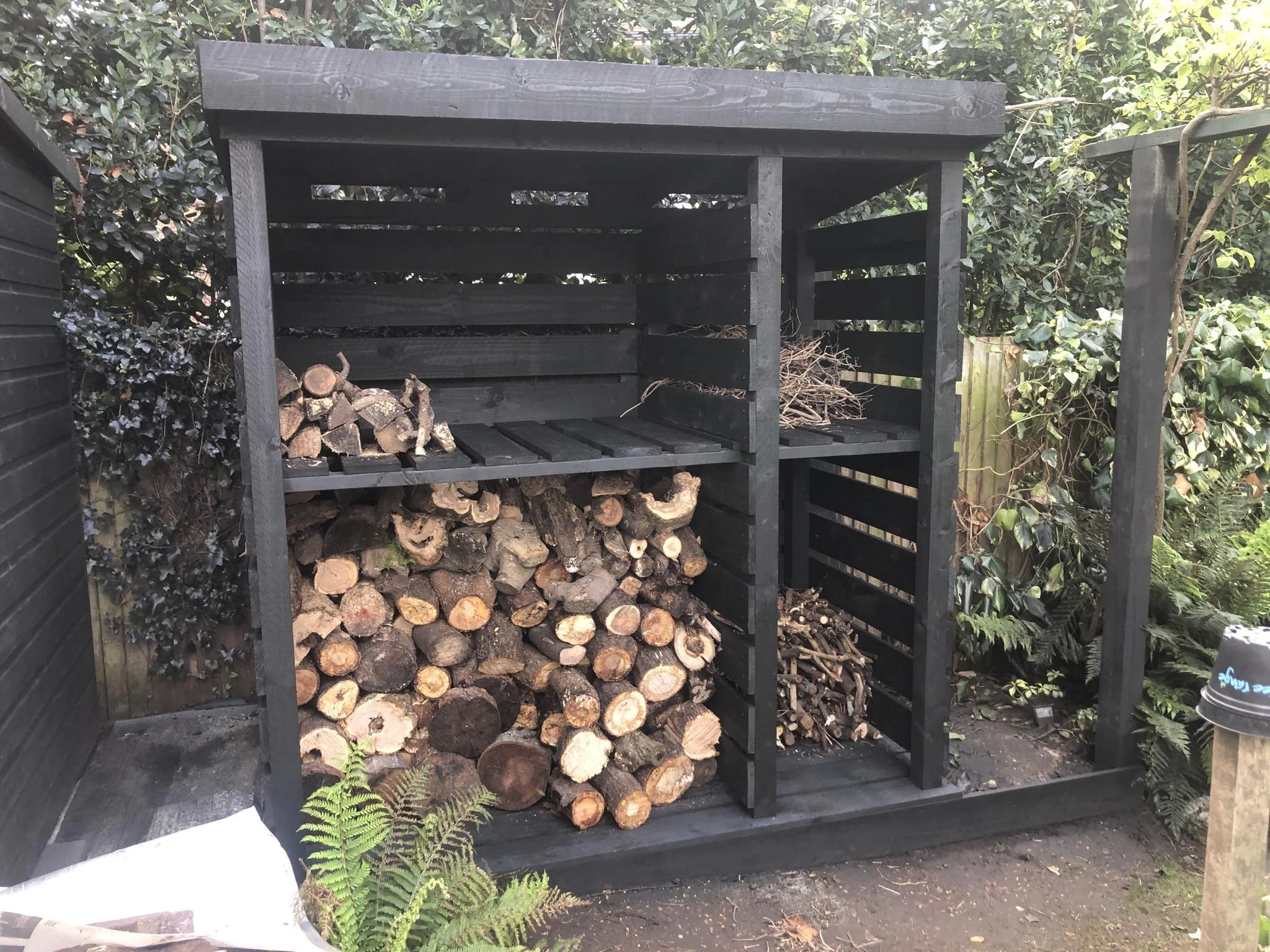

I'm in the process of moving the fresh logs at the bottom and the back and the seasoned ones at the top (only 2 layers deep). But I have access to hundreds of logs fortunately but they're not seasoned so bring some in and let them dry out.
I have a basket in the house with enough for a week's worth.
Here's my puny stash.
Looks darn good to me! All I see it copious amounts of warmth and heat energy bundled into log form.
That's why I figured adding a shelf and divider would be good, so I could section off the seasoning stuff vs. the stuff ready to burn and try to minimise complete reshuffling of the entire pile.
