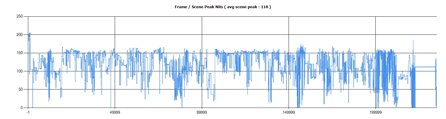

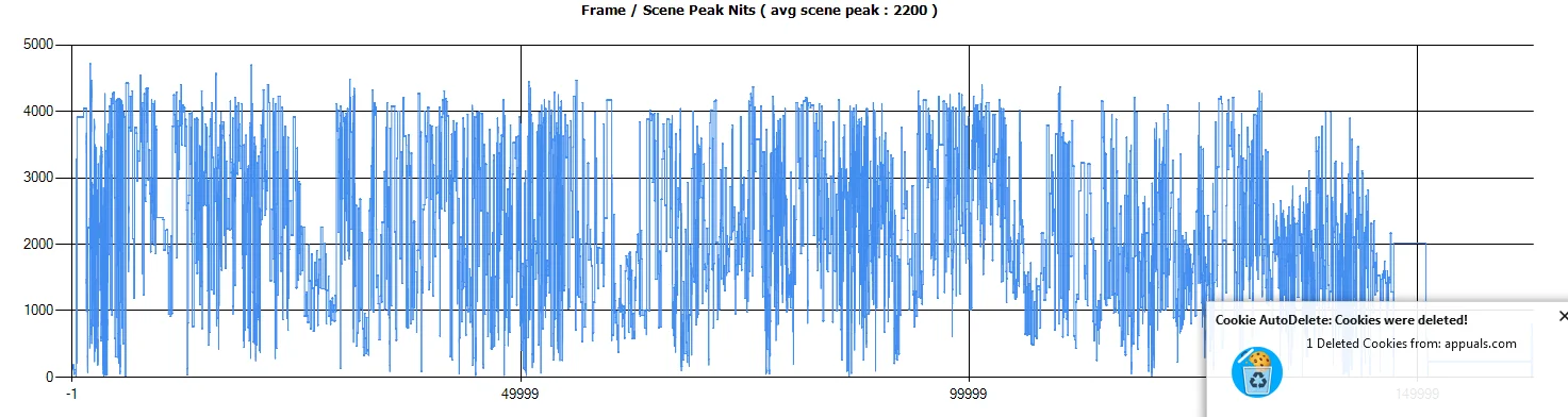

Don't forget as well that certain films might not actually be that "bright"
Meg:
Blade runner:
As has been said, for LG OLEDs and HDR........ OLED light at 100 and dynamic contrast also needs to be set to "low" for proper tone mapping etc.
Breakdown of what the dynamic contrast does on LG OLEDs
Meg:
Blade runner:
