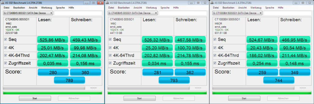

sata SSDs have access times broadly identical to NVMe SSDs. I've SHOWN you this with my 9 year old samsung 830. Infact, my 850 evo has a better write access time than the NVMe example you gave, and on old hardware too, so you're barking up the wrong tree. Again:
if you are seeing ~200ms access time in the task manager directly after Watch Dogs goes sideways then that's a result of the drive being bottlenecked. 200ms access time is not normal for any SSD. As for what's causing it, as i said it could be because the SSD has no cache. Write performance is way more reliant on cache than read, so maybe something is writing a lot of data too it when Watch Dogs tanks? You need to look at everything else your PC is doing when this happens.
It's obvious that a NVME SSD (might as well get one with a DRAM cache too) would be the best bet though, to run the game without stuttering, why waste time on a sata drive? NVME drives have approx 5-10x faster read access times, and noticeably higher 4K read and write performance, compared to a Sata SSD with DRAM cache, example here:

I haven't seen any evidence that suggests that there would be this kind of performance deficit with a DRAMless SSD (there seem to be a lot of assumptions about real world performance for some reason, even though most SSDs have an option to use system RAM as a cache for the SSD).
Crucial BX500 2TB SATA SSD Review | TweakTown
On paper, the BX series has made all the right moves to be a solid budget drive, and it's not that it isn't, competition in the market has almost spoiled Crucial plans to have a two-tiered approach in its SATA lineup. The build quality of the BX500 is on par with any other SATA solution I have used, and the TBW at 720TB for the 2TB is higher than both the 850 EVO, WD Blue, and its MX500 counterpart.
Performance of the BX500 certainly lacks in any scenario that requires heavy write activity. Read activity, on the other hand, is handled without issue and in our testing was able to reach the intended 550 MB/s. ATTO showed just how one-sided this drive's performance can be with intermittent dropouts during writes and steady read performance start to finish.

The game is struggling to read files, not write them. NVME drives have better read access times, google it. I think we are arguing about nothing really, you say it's because of no cache I say it's slow access times, it could be either, we don't know.
And look at the read access time of my old SSD - 0.119ms, or roughly 2000x better than the 200ms you seem to think (without any proof) your bx500 should have? What does that suggest to you?

With SSDs what file system sees is entirely meaningless to actual physical location of data on NAND chips.
Unlike in HDDs with file system level address matching to exact single physical location on disk, SSDs have controller deciding actual write location of the data.
(storing actual location corresponding to file system address into kind of address translation table)
Also to improve performance controllers split at least writes above certain size into smaller pieces written in parallel to different NAND chips.
Which is why smallest drives of model serie with fewer NAND chips have lower performance especially in writes.
NVMe protocol itself has lower overhead.
But time for single access isn't automatically that much better, because of being limited by NAND Flash itself.
Those high queue depth/thread count numbers don't have really any meaning for normal home use.
For example here's top SATA SSD and NVMe SSD of the time tested on same hardware.
SATA SSD has 30 microsecond access time and NVMe SSD 26 microsecond access time.
Also take note of Q1T1 4K random read performance.
https://www.thessdreview.com/our-reviews/crucial-mx500-ssd-review-1tb-the-best-value-in-sata/3/
https://www.thessdreview.com/our-reviews/samsung-960-pro-m-2-nvme-ssd-review-2tb/3/

Yikes i find it hard to believe that a modern dram less ssd is slower than a mechanical drive in anything.
QLC drives are slower in sequential writing than 10 years old HDD after running out of SLC cache!
https://www.techpowerup.com/review/samsung-870-qvo-1-tb/6.html
https://www.techpowerup.com/review/crucial-p1-nvme-m-2-ssd-1-tb/6.html
And basing on collapse of write speed BX500 smells awfully lots of QLC.
https://www.techpowerup.com/review/crucial-bx500-480-gb/8.html
Or if that's TLC, it's some garbage bin quality chips.
MX500 hardly slows down after running out of SLC cache:
https://www.techpowerup.com/review/crucial-mx500-500-gb/6.html
